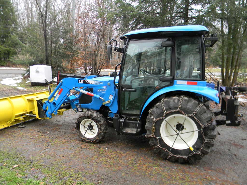

I've had mine about 1 1/2 years now. I have not maxed out the loader yet. Most known weight I've lifted is 1650 lbs. (20-80 lb. bags of cement, figuring 50Lbs for the pallet) or 1950 lbs if I add the weight of the forks which I guess are 300lb. or maybe more if I add my hydraulic thumb.
Lift height would be more of a concern if you are looking to buy. LS loaders have lower lift height than other brands.
I have the cab model hydro and really enjoy the heat and A/C.

Only had to lift the pallet off my trailer about 23" high. Once off the trailer I lowered it close to the ground for stability. I have no doubt I could have lifted it to full height. It didn't even grunt or strain to pick it up. I had about 900 lb hanging on the 3 pt. and my rear tires are loaded.

I'm over twice your age. I didn't need a cab but wanted one so I bought it. Much nicer plowing snow for me. I haven't spent any time in the woods with mine but I still watch where I'm going so I don't break any glass. I do have insurance for that just don't want it to happen. It's more of a luxury toy for me now.

When I bought it last Feb. (2014) the tires were not loaded and I had no chains so I had to use the rear ballast for traction weight. With the tires loaded and chains this past winter I didn't use the ballast and didn't spin. Never even thought to try plowing without them. Next winter I'll see how it does without chains.

I built the PA plow from an old truck plow I had. I bought a QA plate and welded the plow to it. The plow cutting edge has its own trip springs. I ran a pair of hydraulic hoses from one rear remote to the front to control the PA. Not counting the plow, the QA plate, hoses and fittings cost about $350.
Having the hyd. up front I also use them to operate a hydraulic thumb that I can use on my forks or bucket.
