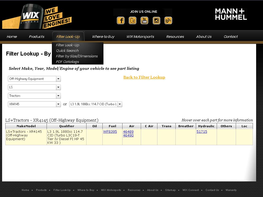

Still more than is listed for mine!
Sorry, but there are no filters for this vehicle in our records.
/ xr 4046 oil filter offense ! #14
Thats good to know! Last time I used any search tool like this, LS was never an option, but New Holland was.
But the Wix site still does not list the oil filter for the current Boomers that are made by LS.

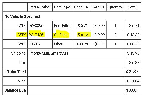

I use Rock Auto for my filters. For my tractor, the WIX WL7426 works perfectly. Its a bit longer, maybe 1/4in if memory serves, over the stock LS brand, but it works just fine. $6.12
