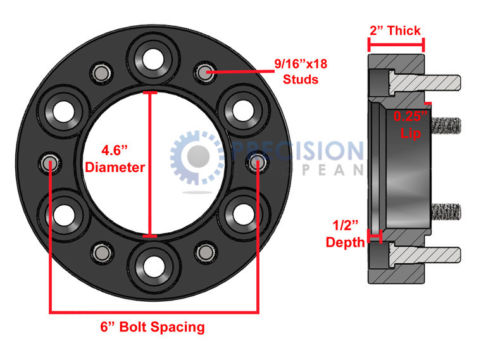

I wanted to give the little LS a bit wider stance. I bought a set of 2" spacers from an EBay seller PE-Motorwerks for 100$. They fit great. I'll need to procure longer wheel hub bolts though as the spacer is slightly thicker than the wheel where the studs / bolts slip through. 2pc | 2 inch | Skid Steer Wheel Spacers - 6Lug Bobcat Case John Deere CAT Terex | eBay

The stance of the tractor looks better and seems better to me. No rear world tipping data to share. To do this I thought it best to install longer bolts (16x50mm?) from the rear of the hub and tapered nuts to fit the spacer. The auto parts store had like 3 wheel nuts so I looked on EBay and bought a set of Land Rover nuts for not a lot of money. Welcome to the forum!

Did you modify both the front and rear?
   / XJ2025H Wheel spacers
The rears only.
