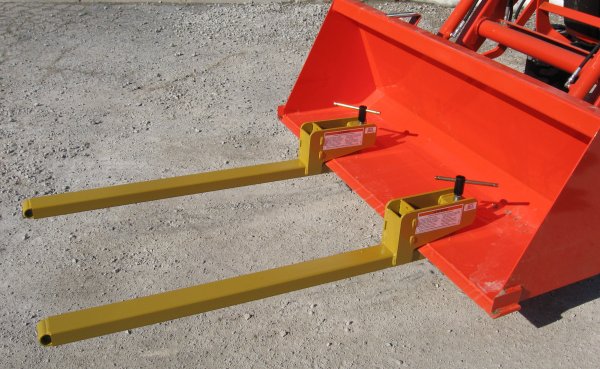

I'm in the same boat you are and am interested to hear the results of your weight test. I have same tractor with pin on forks and had the same experience where it seemed like it should lift more than it does. My guess is that mine will lift about 400 lbs at the end of my pin on forks attached to my bucket. I understand that is a lot of leverage 3+ feet away from the pins. I would consider buying a ssqa fork setup if I knew that would give me a solid gain in capacity.

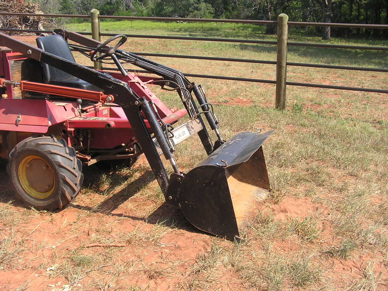

sbct, can you explain or post a picture of your pin on forks?
This is my pin on bucket and pin on brush fork:

And clamp on forks:
/ XJ2025H Loader w/ forks question #7
I meant clamp on.
