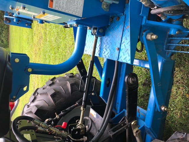

Same model and have no clue about top link. Can someone post a picture?

I assume you are talking about the XJ2025 with the lb1104 hoe... but there are more options for buckets then 9"... I got a 12" with mine.
The top link most likely keeps the hoe from loosening up at the lower 8 bolts that hold it to the sub-frame. This happens to the XJ when after heavily using the hoe for a several hours and a link like that would limit any type of movement to start.

Big Blue Florida thanks for posting that photo of how the top link is attached to your tractor/backhoe. After looking at the photo I went through my LB1100 Backhoe Operators Manual again and there is no mention of the top link & the illustrations do not show it at all. Hopefully my tractor will be back tomorrow or Saturday and I can see if it has the top link attached. You have mentioned that you have photos of "stump removal" any chance you can post some pictures? Thanks
