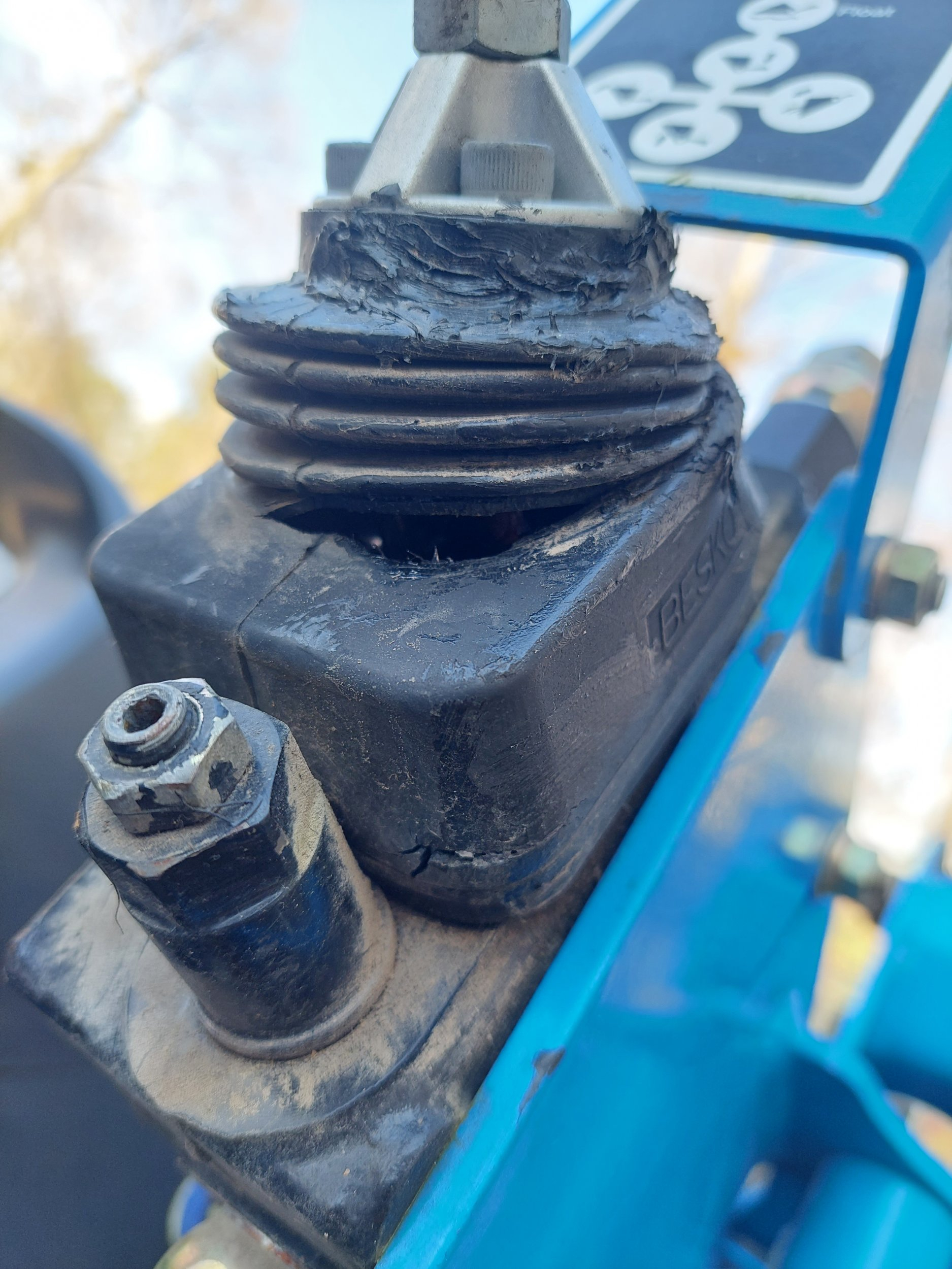

Has anyone replaced the loader joystick boot?
Not avaliable from LS Separately. I have heard about using cv joint boots, but the base on mine is square, not round. If I can't find anything, I will probably fabricate something out of an old inner tube.

Apparently I can't type. The loader is a LL3110.
/ Xg3025 loader joystick boot. LL1101 loader #4
I recentLy replaced the boot on my TNT. The original boot was not available after 18 years so I ordered a universal CV boot from Amazon. The base of my Joy stick is rectangular and the boot worked perfectly. Rubber boots don’t care what shape you put them on.

what happen to the original ? mine is a 2016
and has rips/tears
Mine has had cracks in it that I've sealed with rtv for a few years, but the cracks are to big to seal anymore.
It's about the same age as yours. I'm to cheap to spend $40 for the Amazon one.

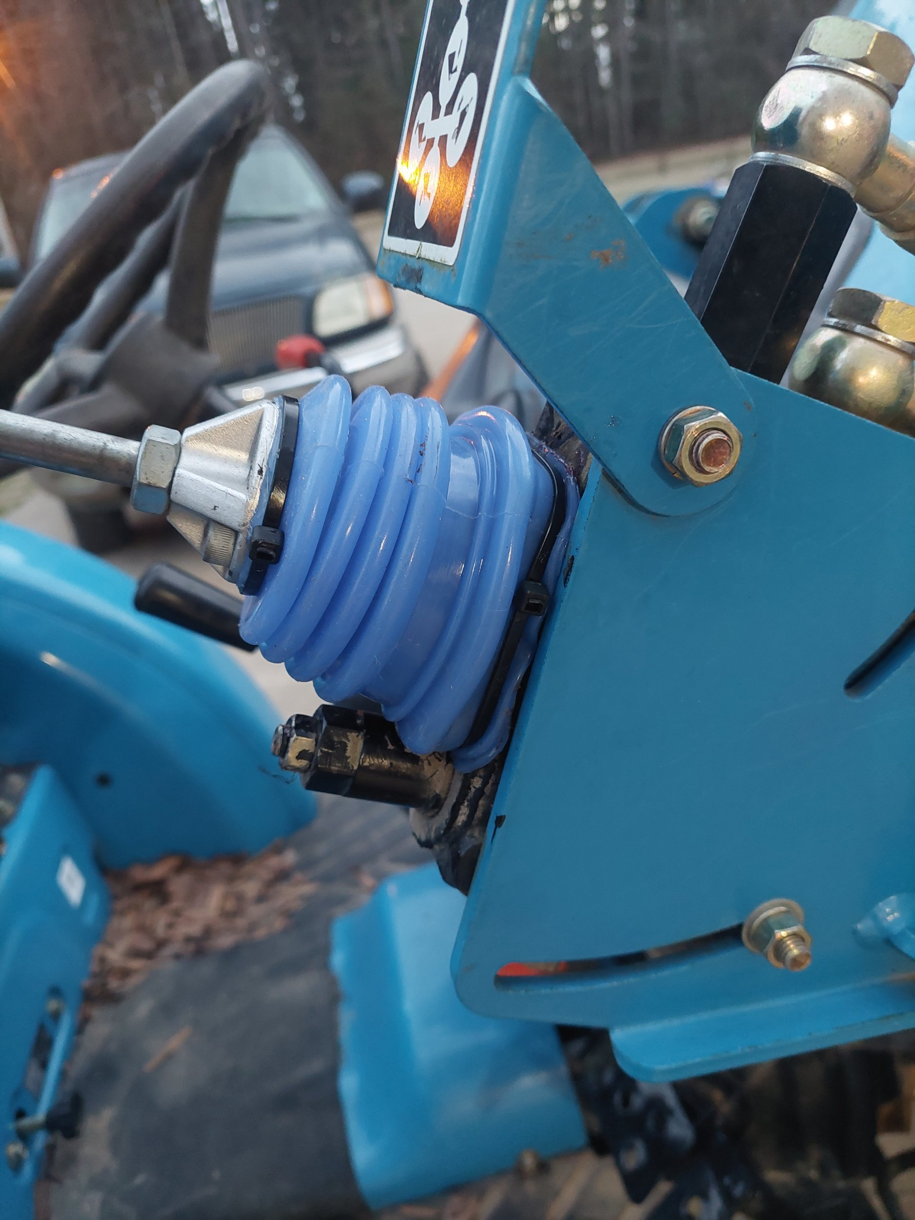

Finally got around to changing the boot. It was to large, but worked great with some trimming.

/ Xg3025 loader joystick boot. LL1101 loader #10
Can you post the link for it.
#11
Ebay.com different seller, but appears to be same item.
