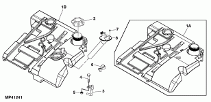

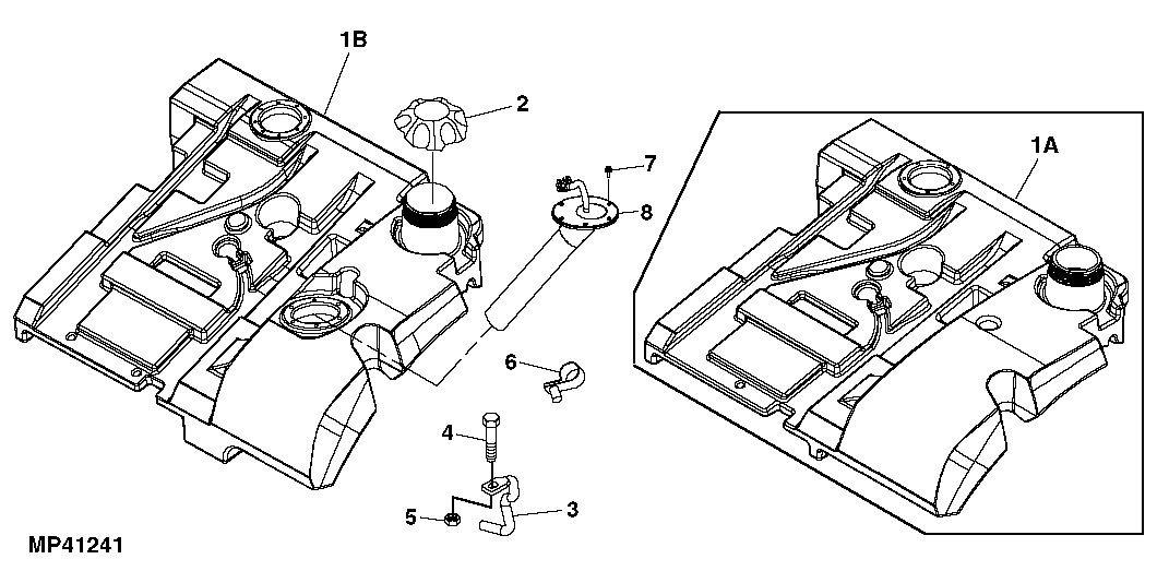

Were you low on fuel when you were mowing on the hillside and it stalled the first time?
In the X5-700's the fuel tank is shallow, flat and wide. The fuel pick-up has s large-ish 'sock', as a filter, on the bottom which somewhat resembles a pancake but is about the diameter of a coke can. (Hope you can visualise that?)
Because the tank is so shallow the pick-up & sock sit in a shallow recess in the floor of the tank - Which is under the seat base.
That helps the pick-up stay in the fuel pool. Unfortunately, it also provides a place for all the dirt (etc.) to gravitate towards and thus get sucked onto the filter sock.
You can imagine the rest...
To access this pick-up filter sock you must remove the seat, its runners and the fender-deck. Disconnect tail-lights and the little hook clip beneath the LH handgrip. (#3 in the parts pic. You have the tank on the right.)
The various hoses & wiring loom are obvious. Remove the pick-up & filter assembly carefully (It also contains the Fuel Gauge Sender Unit) and view inside with a torch.
Report what you find.

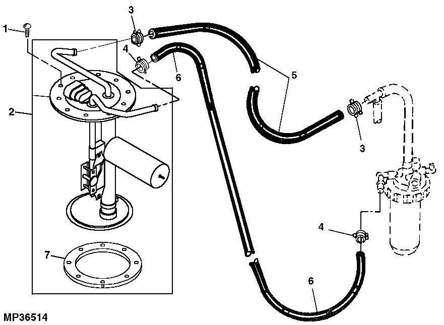

Tip out the fuel into a bucket or tray.
The filter sock can be cleaned with 'solvent'. It is not available seperately so you have to clean it. It is the circular shape above the gasket ring here:
