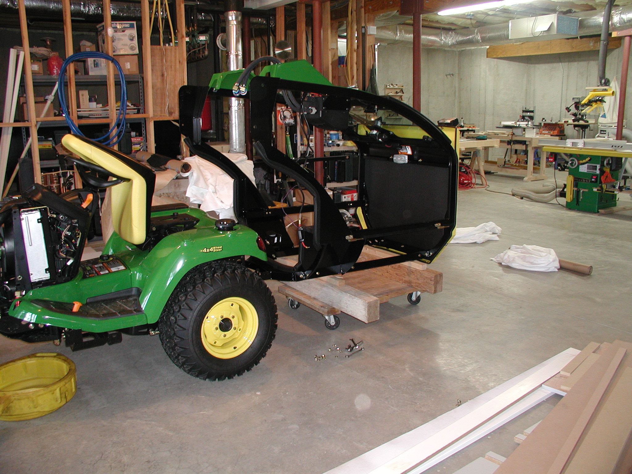

Do you also remove the front windshield of the cab in the summer? I want to be able to remover the entire cab in summer to allow me to mower under the trees, etc.

I remove the whole cab. When I wired the cab I made one connection to the starter to supply my aux fuse panel. I also installed dry breaks so I do not have to drain and fill the cooling system each time. Pull the doors, 12 bolts and its off. I leave the two lower bolts in the rear and use them as a pivot point to lower the cab on dolly. Not having glass windows on the back saves some time as I just pull off the side\rear plastic window.
Here's some pics.
