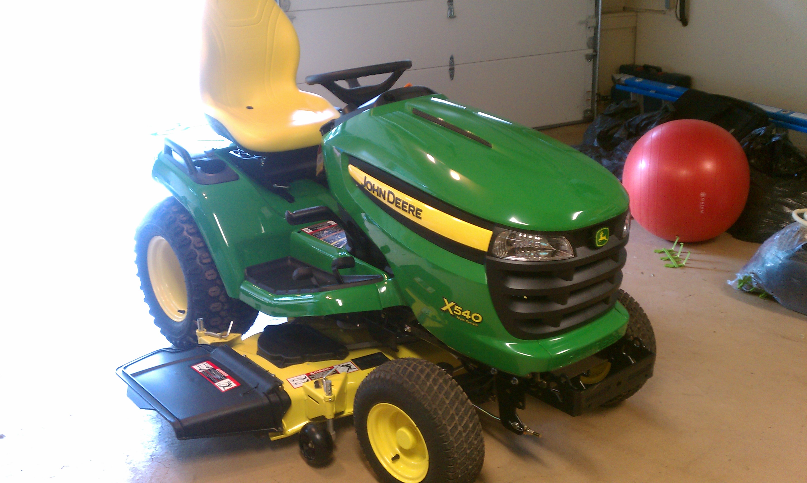

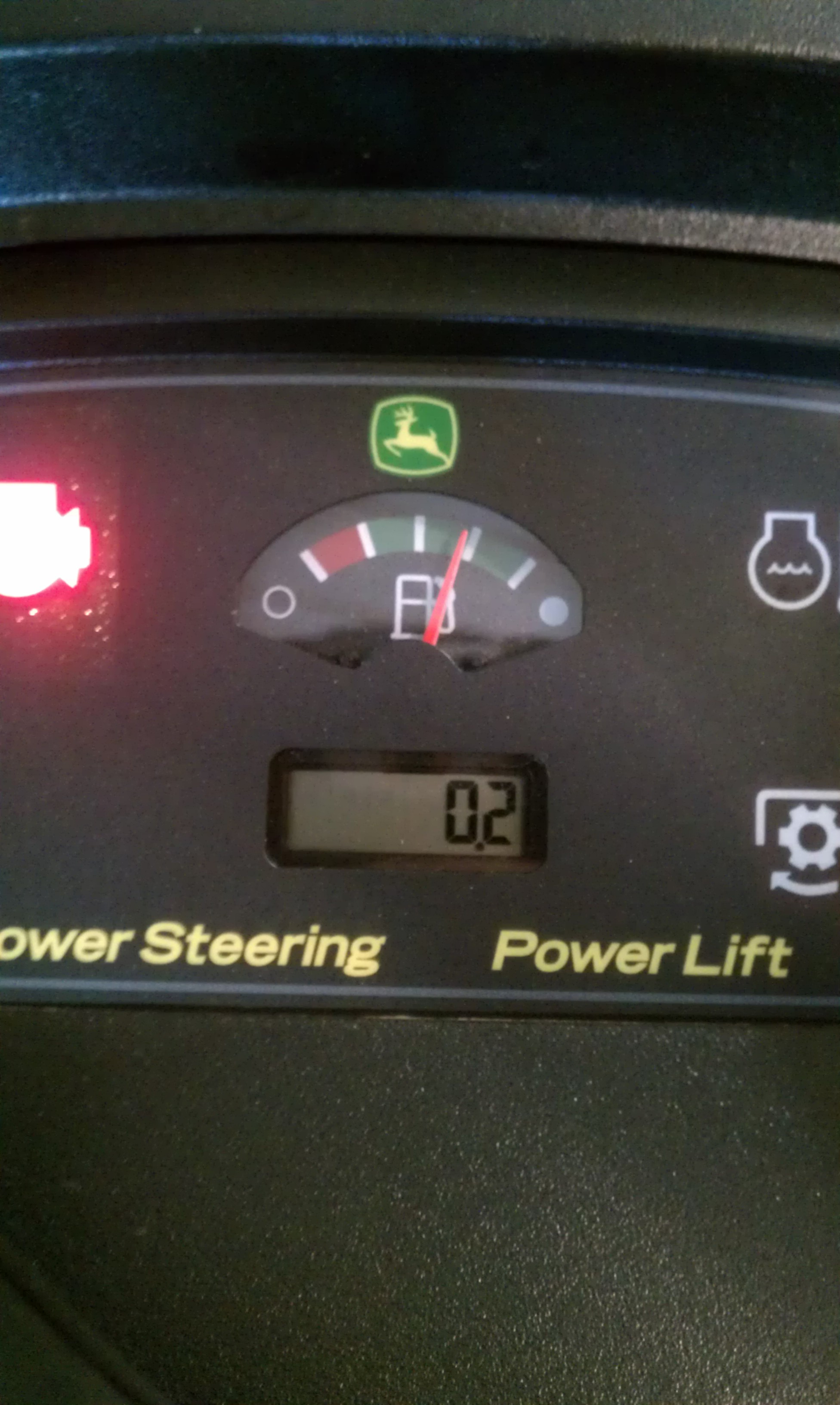

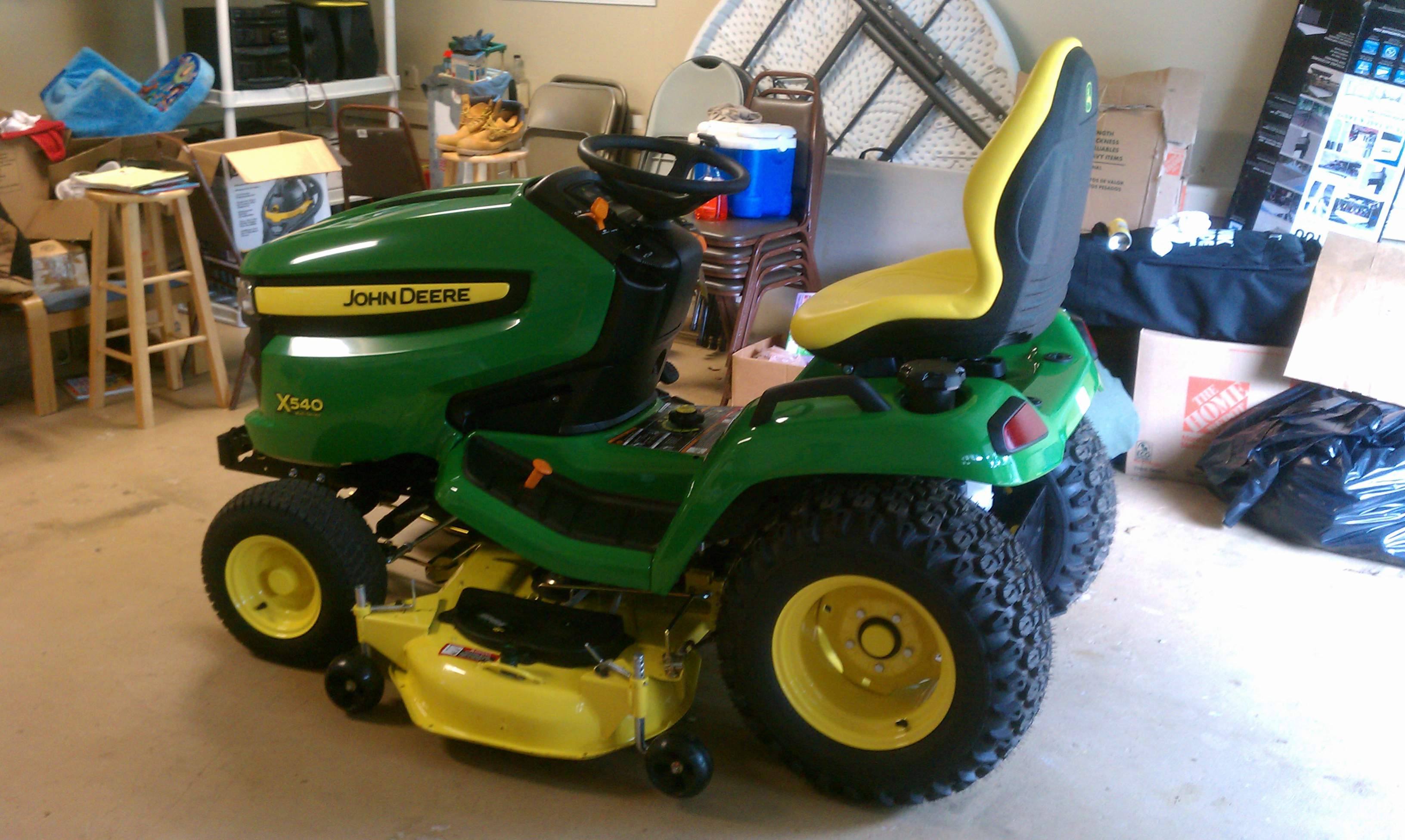

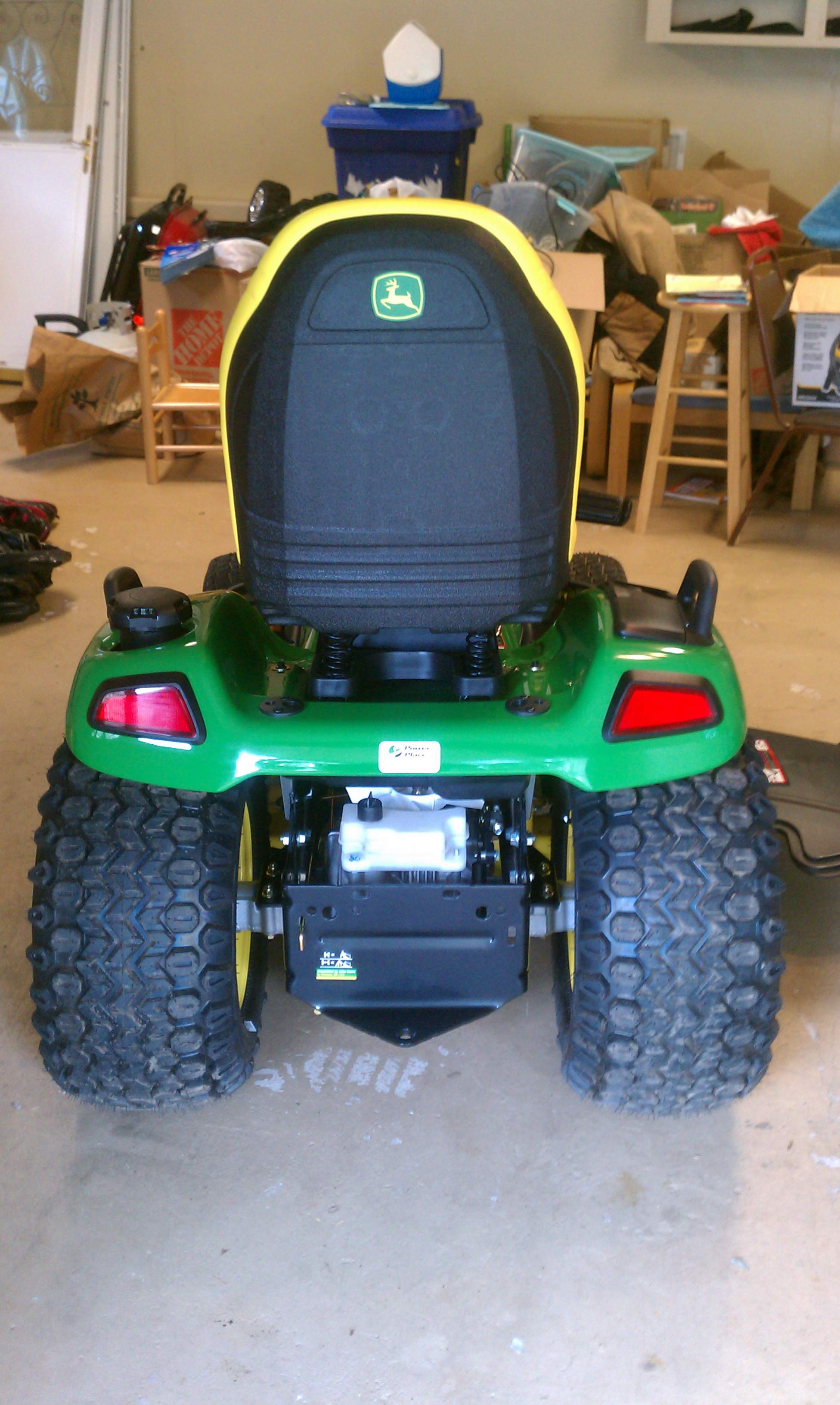

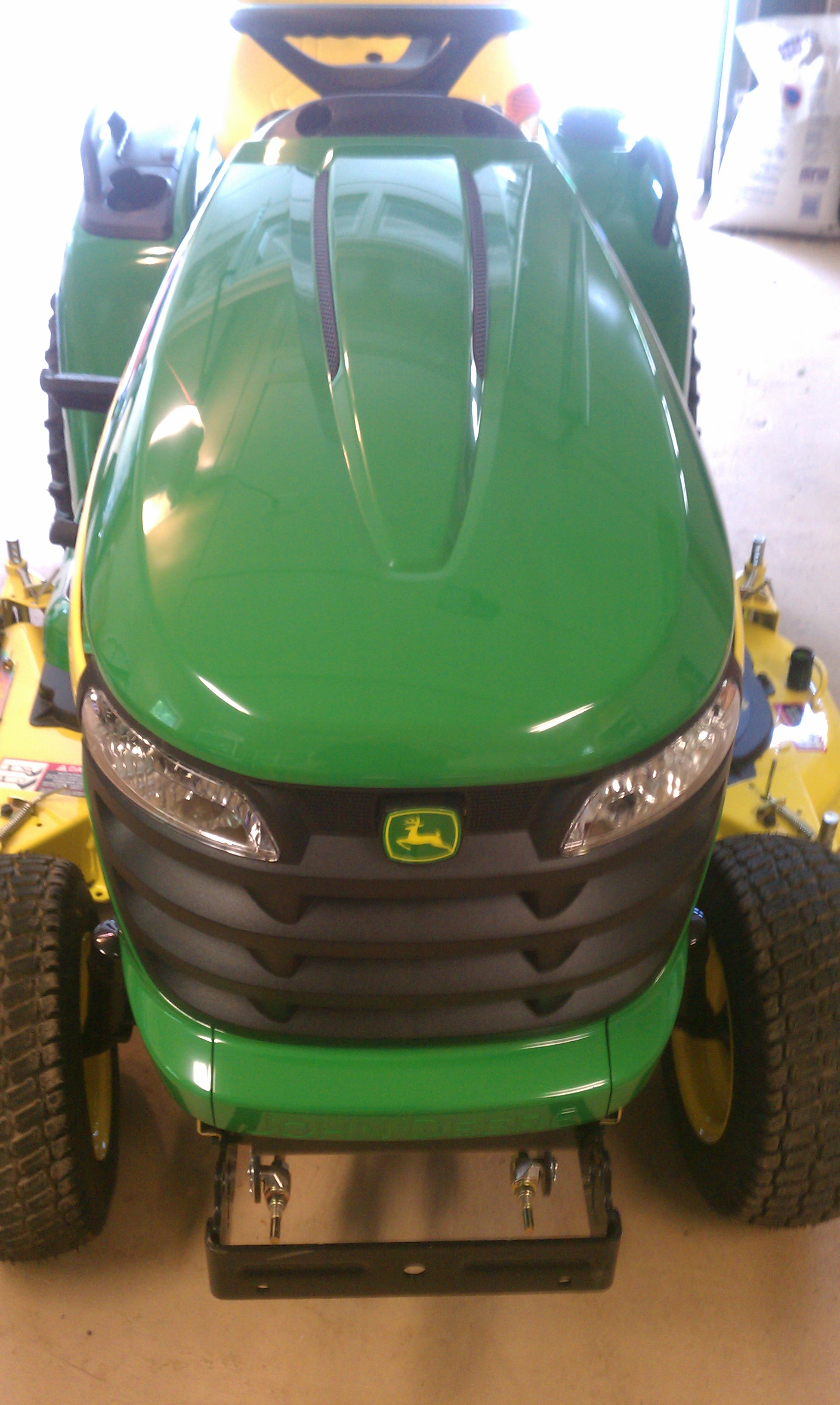

Just got the x540 this morning. I cleaned it up as it was dirty from the dealer. I didn't mind cleaning it, as I did a fine inspection of the tractor. As you see by the pictures it only has .2 hours, but came delivered with .1 hours.
The deck has about 3" of paint scrapped off the side bottom lip. The dealer is sending me paint.
The deck rollers show some slight wear. The dealer said its from the gravel in the yard when they took it out. Not sure if i should be that **** and ask for new rollers.
The seat was dirty and I couldn't get it out even with degreaser, and i found a few small cuts as well, so the dealer is ordering a new seat as well. Going to buy a seat as well.
Other than that this thing looks awesome. Going to ride tomorrow morning.
