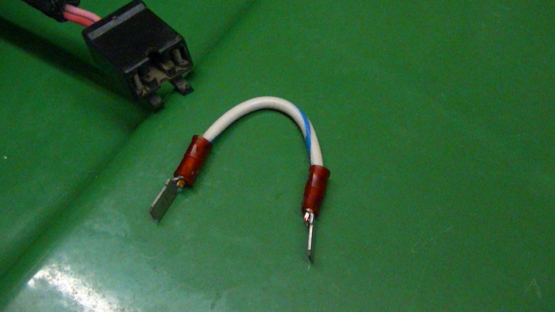

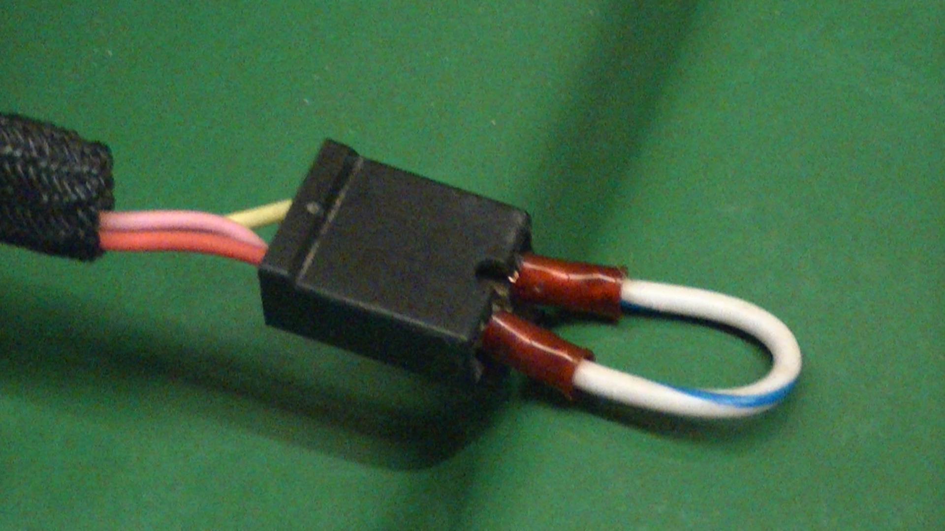

Did you just jam the bare ends of a wire into the connector? If so, it's easy to see why you would be having an issue.
It sounds like my 445 is wired similarly to your x485. I used male spade connectors to make a jumper and have never had a problem. There's no need to hack up the wiring. Plus, using a 'proper' jumper allows you to easily return your machine to original condition if needed.
I have red & pink wires on one side, yellow wire on the other. If you have all three connected together and are still having issues, your problem lies elsewhere.
