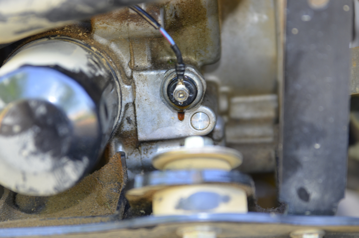

I have just noticed that oil is slightly leaking from the sensor to the right of the oil filter. It has a single wire connected to it. Can anyone tell me what this sensor is and should I just get a replacement sensor to correct the leak?

Have you tried tightening it up? or removing it to see if an o-ring or gasket is messed up? or if it then looks like the sensor itself is leaking?

I cleaned it up and removed the sensor, put some thread tape and a rubber o ring on it. But it is leaking at the end I believe. I think it is for oil pressure ???. Anyway you can see from the picture it is dripping as I took the shot.
Maybe this whole part needs to be replaced. It is a metal piece with what seems like a ceramic insert. The wire attached to the end of the hard rubber or ceramic black middle piece.

Looks to be what you think. It is part no. M152192
They appear to be around $18

Did you fix the oil leak? Was it the sensor or gasket?
I am having the same problem on my X485.

After having the same leak, I recommend replacing the sender. Realize this is a small leak but replacement of the sensor is the best solution.
