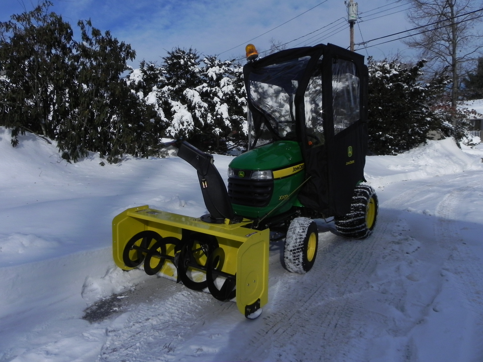

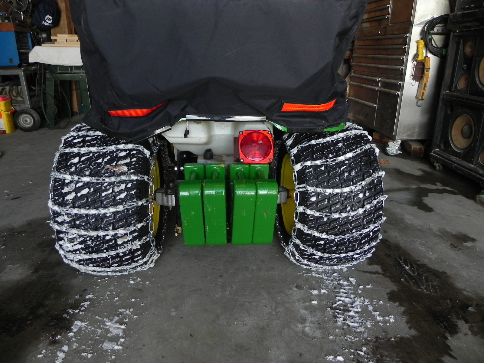

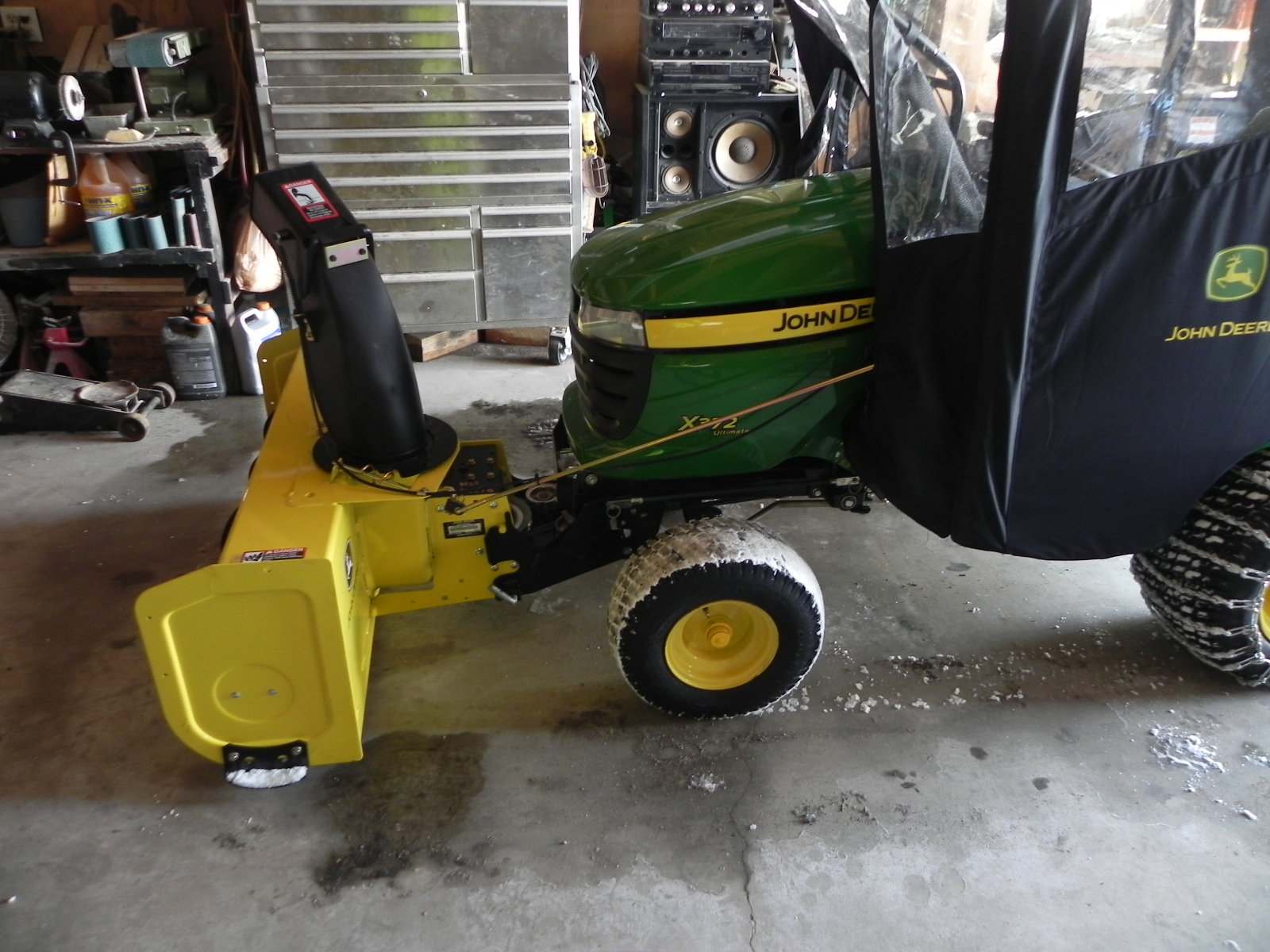

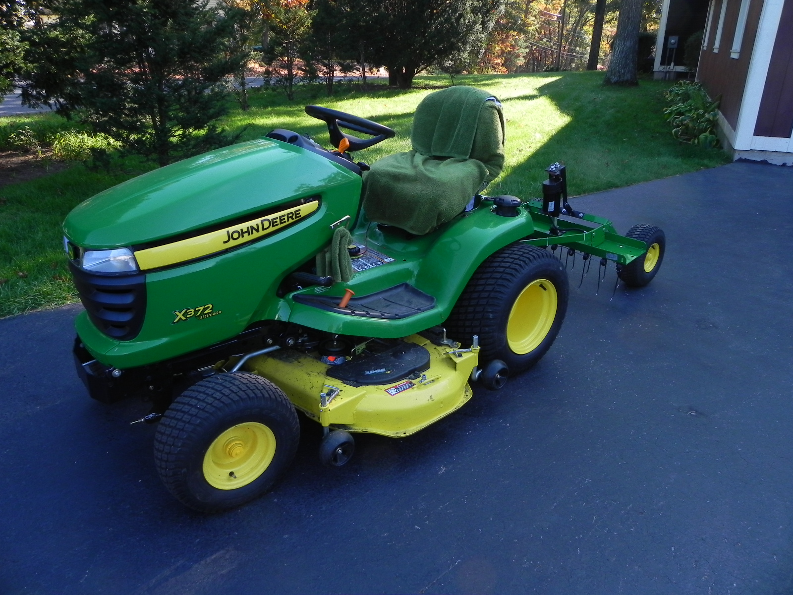

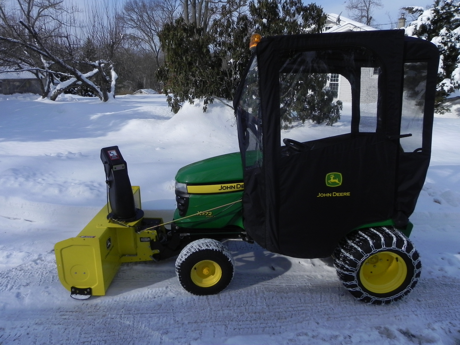

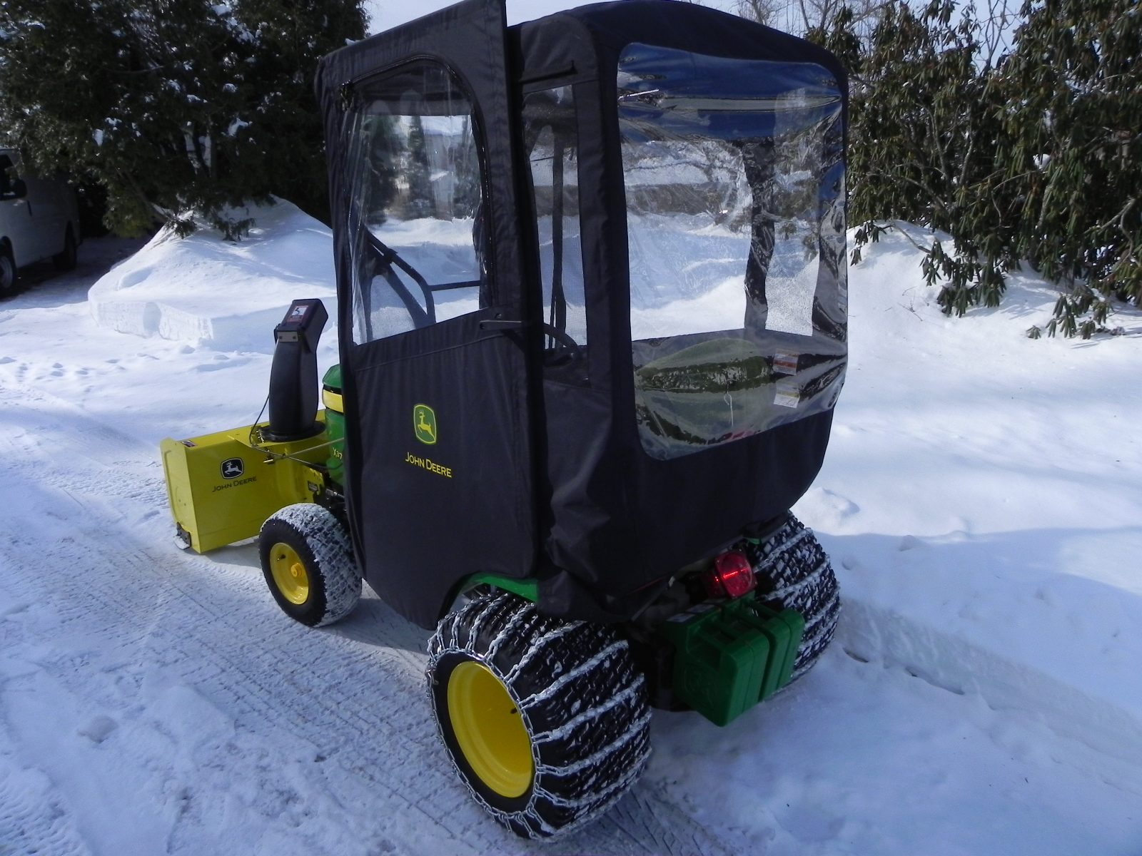

Converted to K72 transaxle 12x12x24 Turfmaster with chains for winter duty.
Moved the governor spring to the outermost hole for a bit more rpm at full throttle.
The stock belt 5L780 seems a bit stressed when under full power.
A better choice might be the 5VX780, which is a 1/2" deep cross section with cogged
segments. Deeper belt less likely to twist while running between the pulleys.

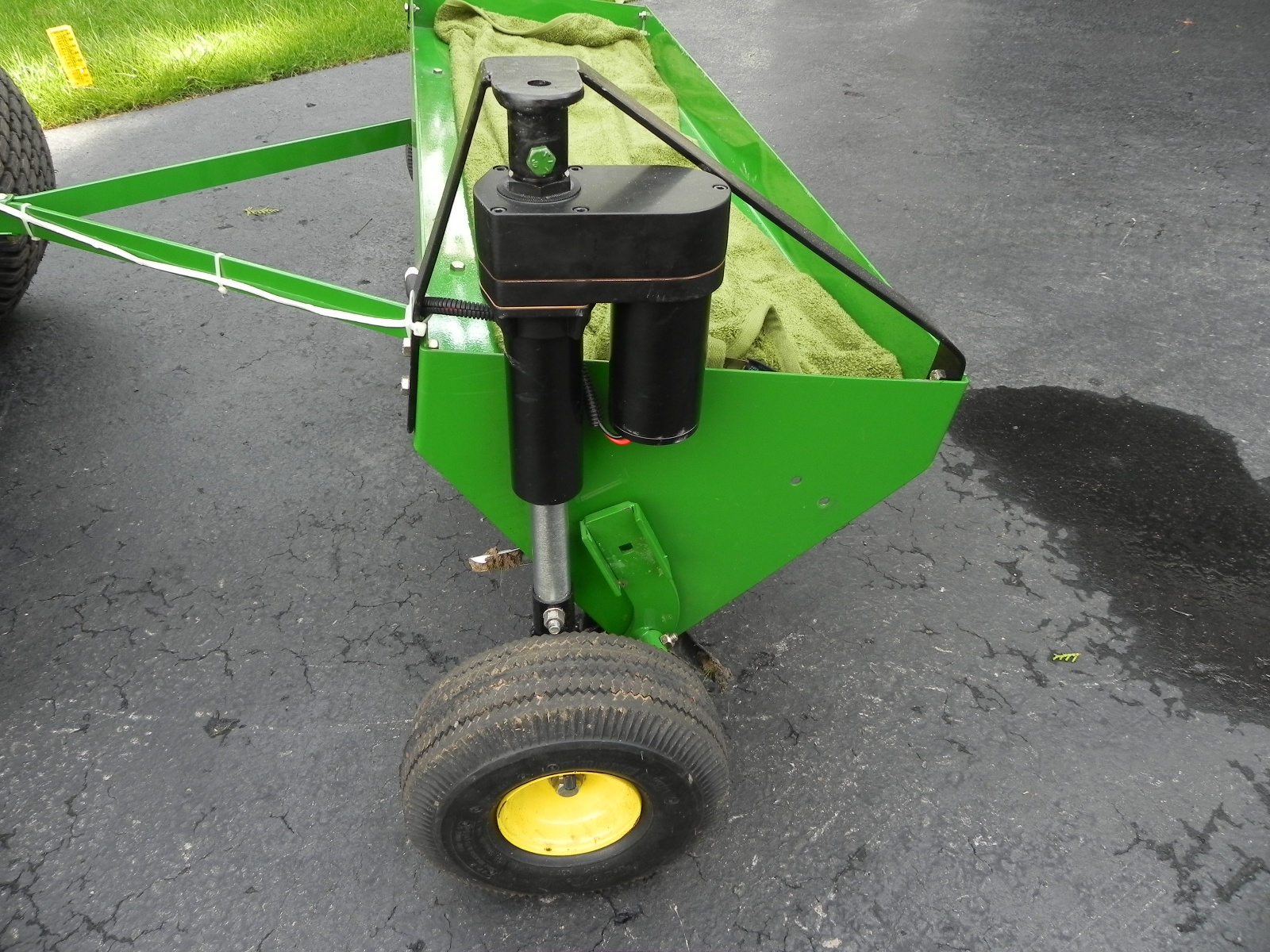

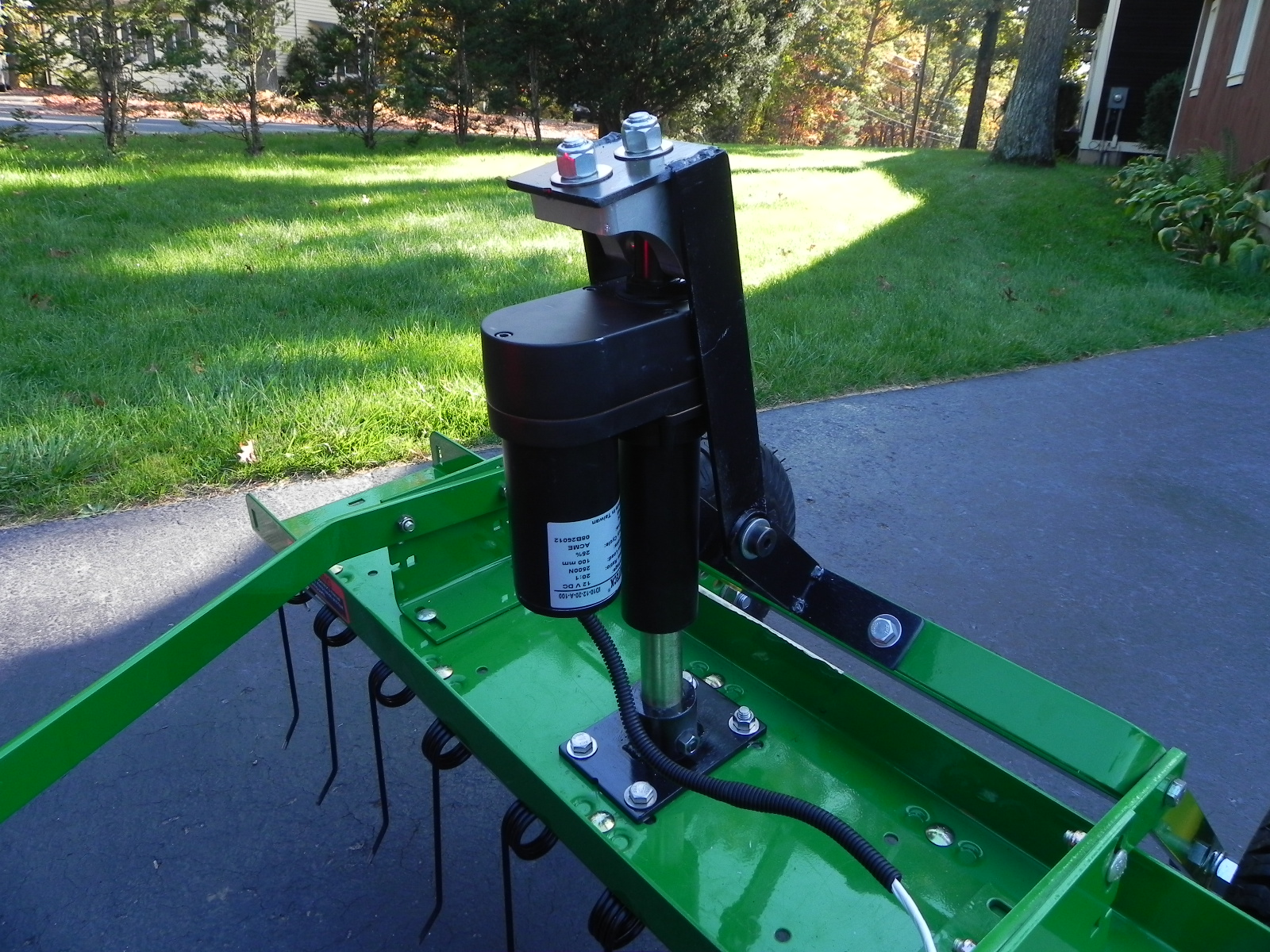

Also notice the electrical linear actuators on the core aerator and thatcher.
Controlled by switch on dashboard you no longer need to get off the tractor to raise and
lower the implement. 12 volt, 4 inch stroke.

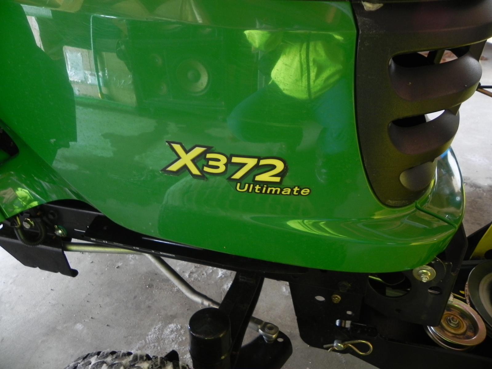

:) The decals are from a 4072 model tractor.
The linear actuators are from the Industrial Surplus.
With a bit of welding and some simple strap steel it makes the job quite a bit quicker
rather than having to jump on and off the tractor especially raising the core aerator
with 200# of concrete blocks !
