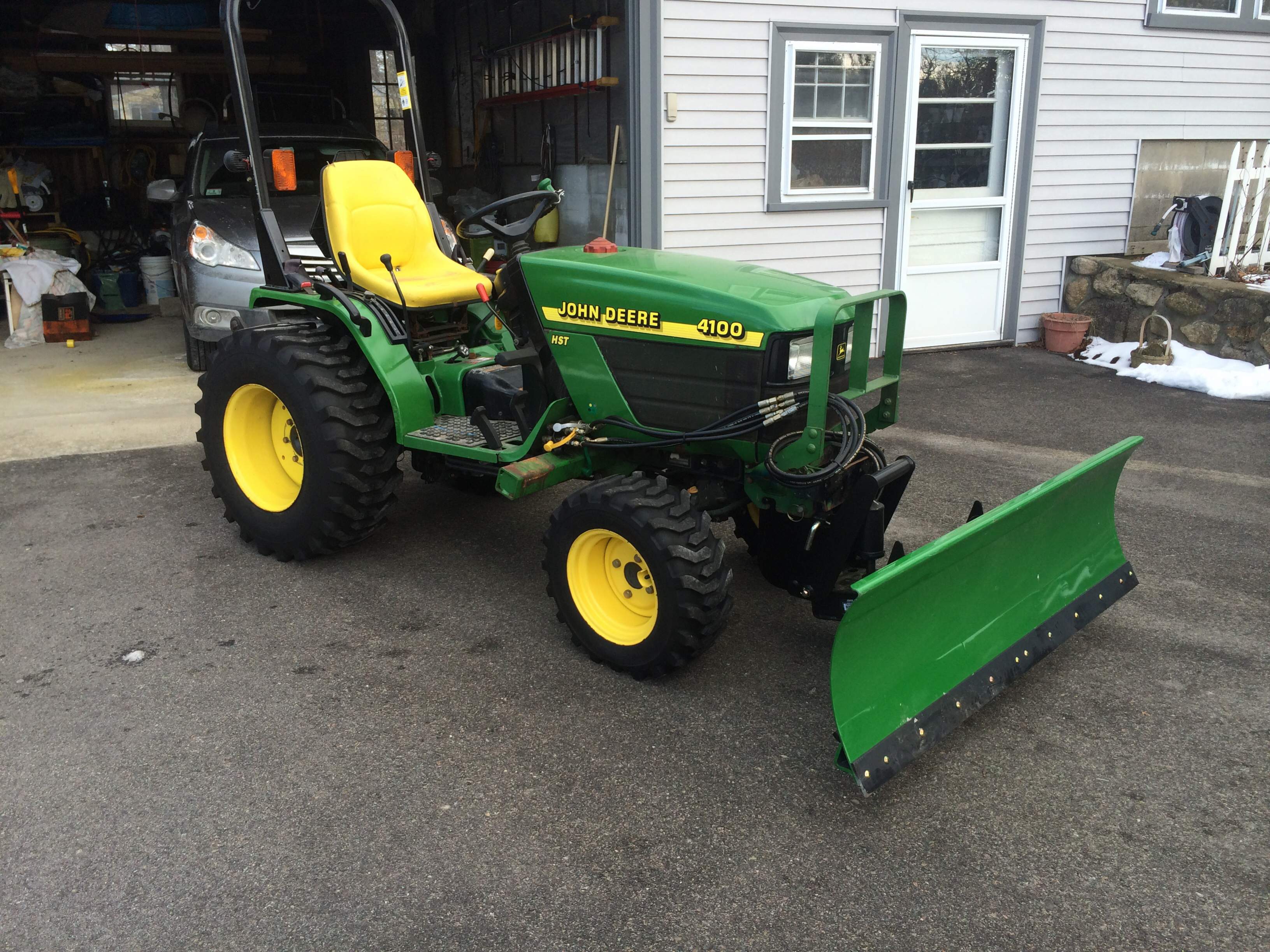

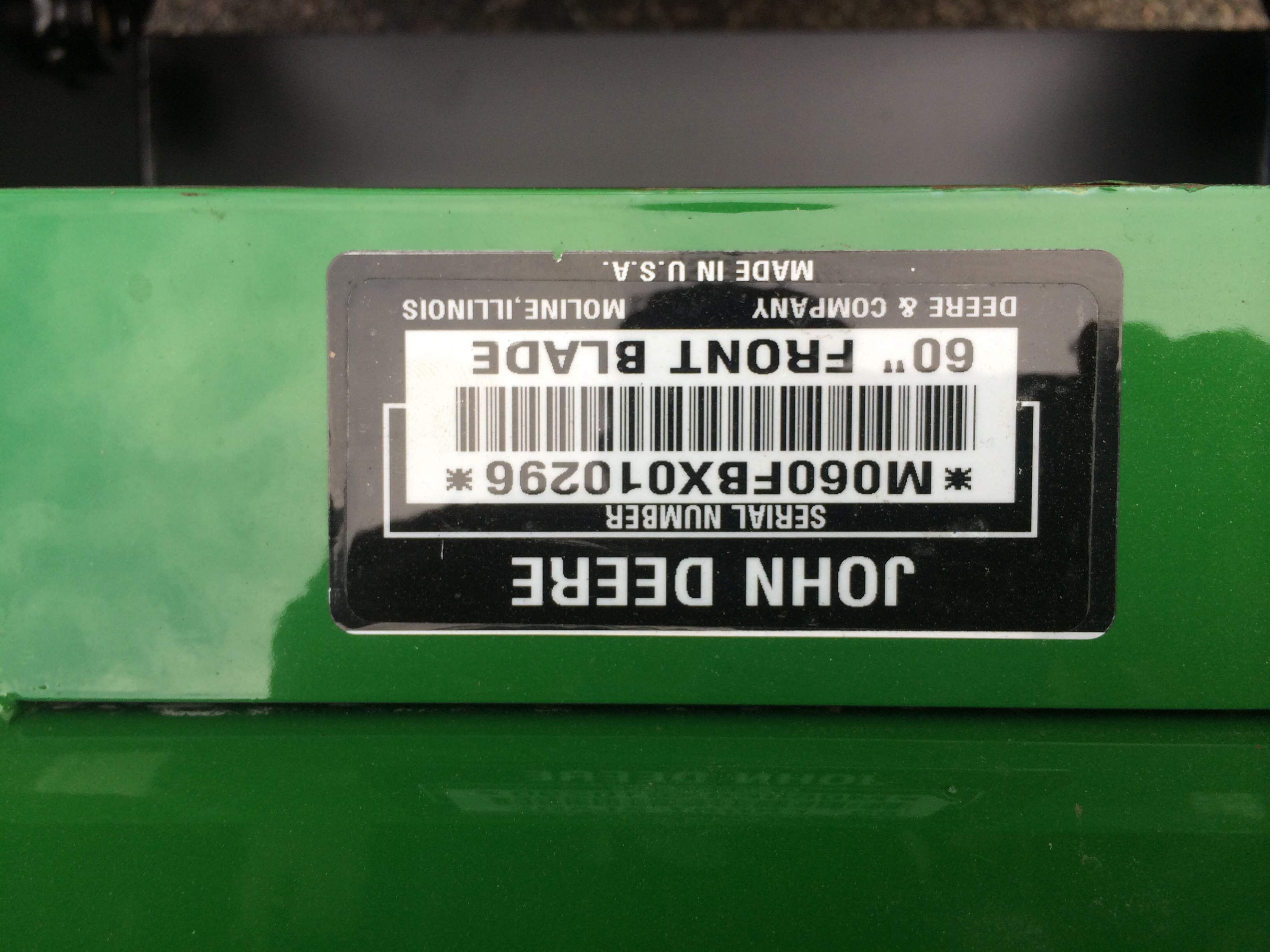

John Deere does ( or did ) make a 60" blade for the quick hitch. I found one brand new on eBay last year. Works great on my 4100 image.jpgimage.jpg
