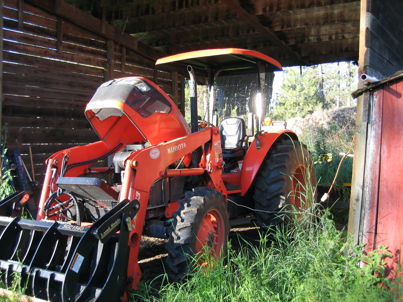

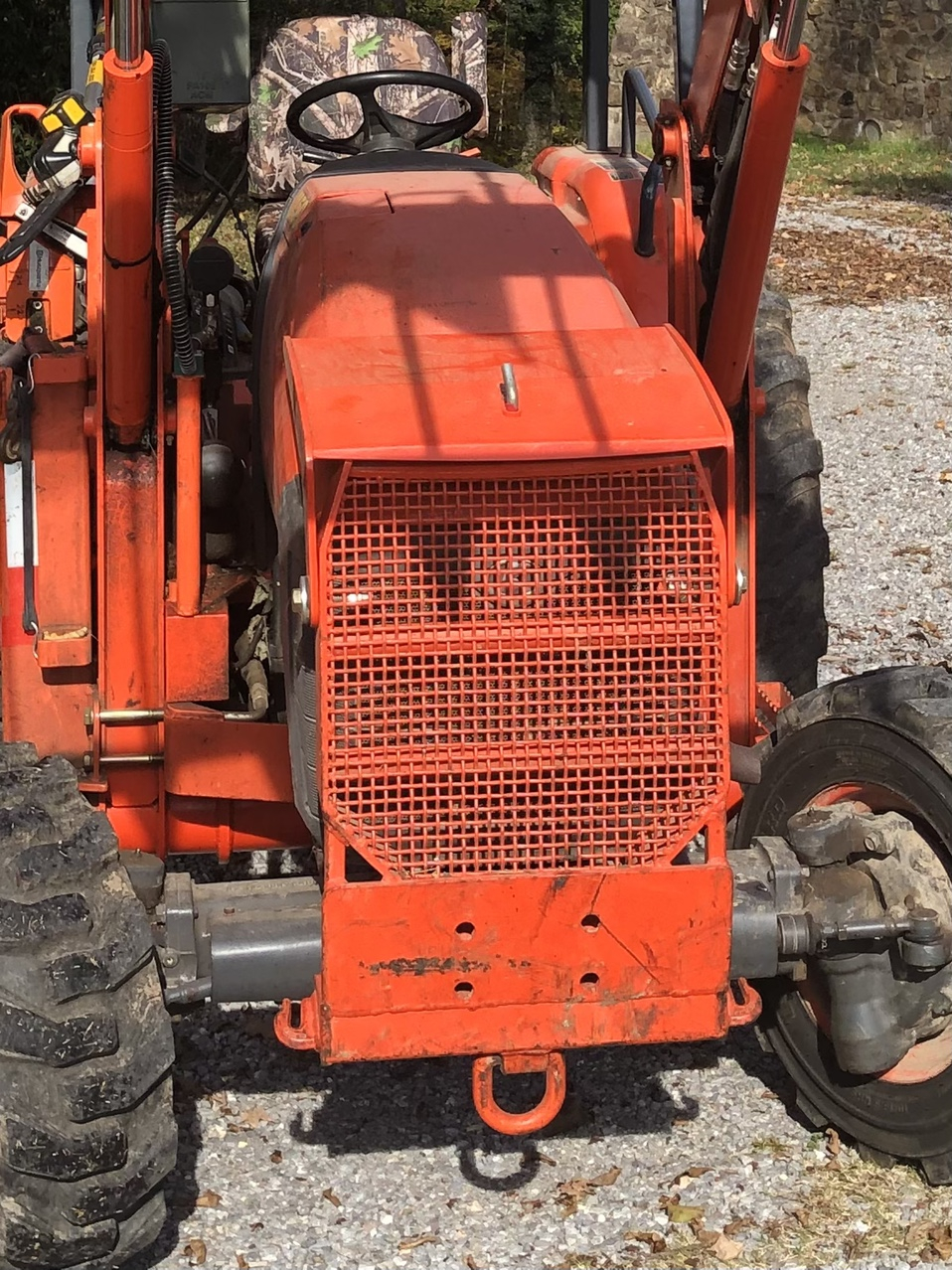

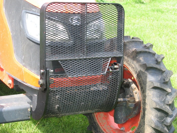

A picture would sure help your situation. This is the way I had a local welding shop mod my OEM brush guard/grill guard.

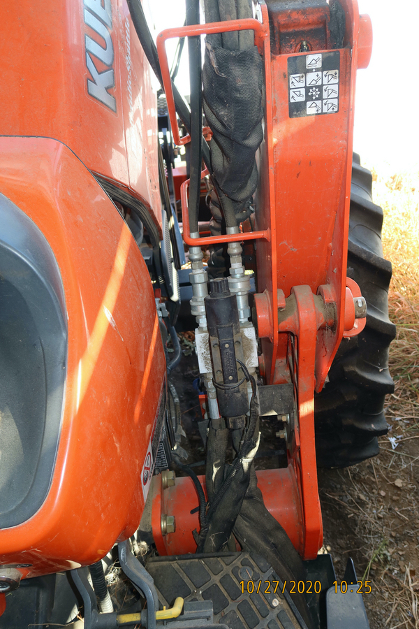

My thoughts - something may not be going quite right. Here are two more pics of how the dealer installed the WR Long 3rd function valve, the hose routing and the grapple itself. The valve is mounted on the FEL vertical member, down low. The rubber hydraulic hosing is routed out the FEL arm - on the inside of the arm( bottom pic ).

Once again I was just lucky. About the time I bought my grapple - there was a post about somebody "holing" their radiator. They had pallet forks - not a grapple. I took it to heart and immediately had my grill guard modified. I seldom work with much brush. But it only takes once.
