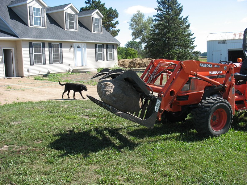

I have the exact same grapple of my Kubota. It has never given me a problem and still amazes me with what can be done with it.
