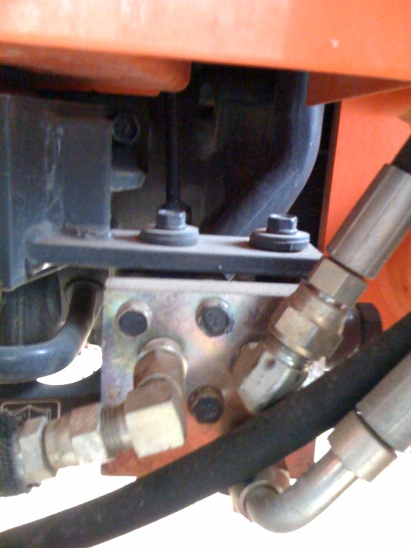

Hi guys...enjoy reading all of threads! Could use a little help if possible.
I have an L5030 with a LA853 fel and want to hook up the wr long valve and grapple. I am not sure which hose to disconnect from the tractor and connect to the P side on the WRLong valve.
Here is a picture of the hoses. One of these must be disconnected and reconnected to the WRLong valve. Don't know if it is the top or bottom one. Also a pic of the valve on the fel if that is easier to tell.

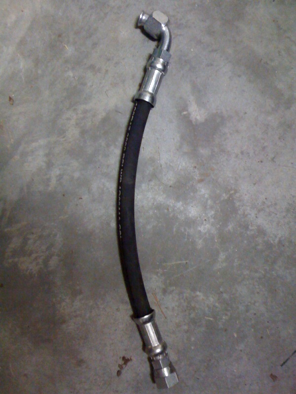

Also...anyone have any hints on how to route this little hose from the valve body on the tractor to the T side of the WRLong valve? Seems like it needs to bend quite a bit.
If anyone has any pics of their own set up and want to email it to me I would welcome it!!
thanks

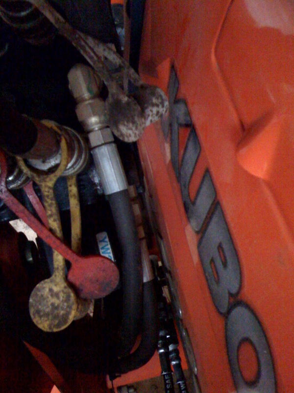

Just hooked up mine in November. As I recall, Kubota has color tape on the hoses. The one with the green label is the one you disconnect from the hydraulic block and connect to the WR Long valve. I had to put a loop in the short hose to take up slack and connect from the WR Long Valve to the hydraulic block.

Herkypilot, is there a chance that you could post some "good" pictures of your 3rd function valve, hoses and control switch? ;)
   / WR Long elec over hyd valve help! #10
Brian,
I can, but it won't be until next weekend as my tractor is on my property out of state. Going there next week. My install looked a lot like this poster who installed his on his MX. I have a few differences. He hooked his power wire to the starter. I found one that is key activated under the panel which was protected by a 10 amp fuse.
http://www.tractorbynet.com/forums/kubota-owning-operating/192572-w-r-long-kit-plus.html
