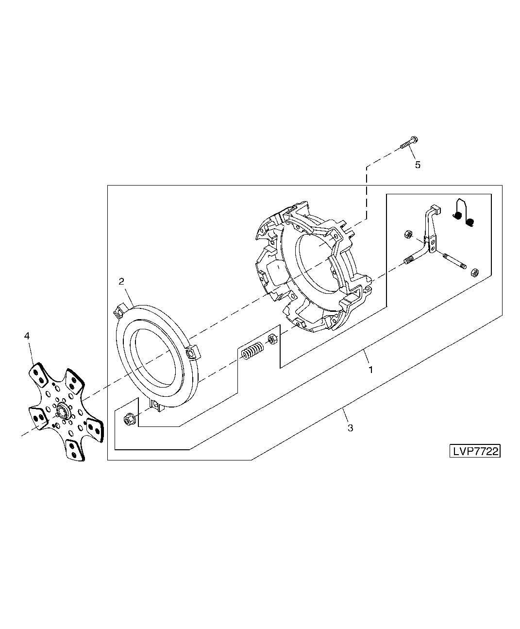

My neighbors 5603/cab tractor stopped moving between unloading truck load of rd bales. After 2 dealer service calls that failed to remedy the problem tractor was hauled to dealer. Service manager stated clutch was bad to the tune of $4300. Tractor was bought new and had around 3700 hrs on tachometer.
   / WOW: R&R clutch on a 5603 cost $4300 #2
Jim,
What does a wet clutch set up generally need in a rebuild?
My only experience is the 40 or 50 series rowcrops. Clutch plates and renewing seals in the operating pistons. The way I understand the 5603 has a dry pad clutch
   / WOW: R&R clutch on a 5603 cost $4300 #4
Jum,
Which model? The 5603 built in Brazil is a 75 hp tractor with a dry clutch, the other is a 99 hp with cab and 12/12 direction reverser. According to Tractordata.
This one has a power reverser. I didn't know there were 2 different 5603's
   / WOW: R&R clutch on a 5603 cost $4300 #6
I don't know either way myself but would think the PR has a wet clutch, might be wrong info on tractor data too. At any rate if the price to change a dry clutch is $4k plus I need to make more money for my work.
On my Kubota M7040 with hyd shuttle it has a dry damper clutch but the fwd/rev clutches are the reverser clutches. I was thinking the 5603 might be similar but I could be WRONG. Here's a parts schematic of what I find in the 5603 parts catalog.

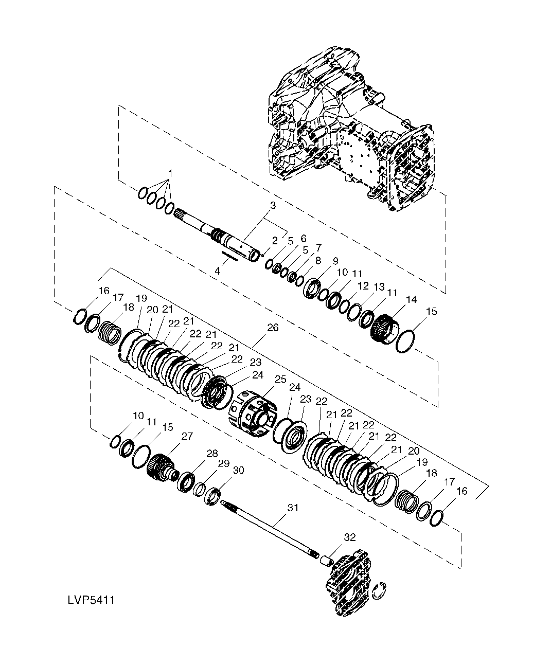

Could they be talking about the reverser needing to be rebuilt? It must have clutch packs.
What would a 5603 with 3700 hours be worth if repaired?
There was one similar to my neighbors tractor with only 1100 hrs for $25000 on DFW CL. $4K to rebuild a hyd reverser sounds high to me BUT parts key #26 is this part.
RE225848 Cylinder ADD 2,890.89 USD
