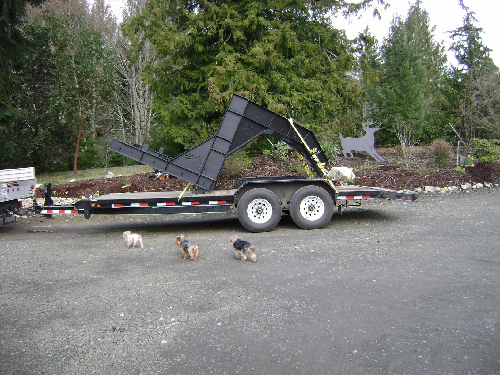

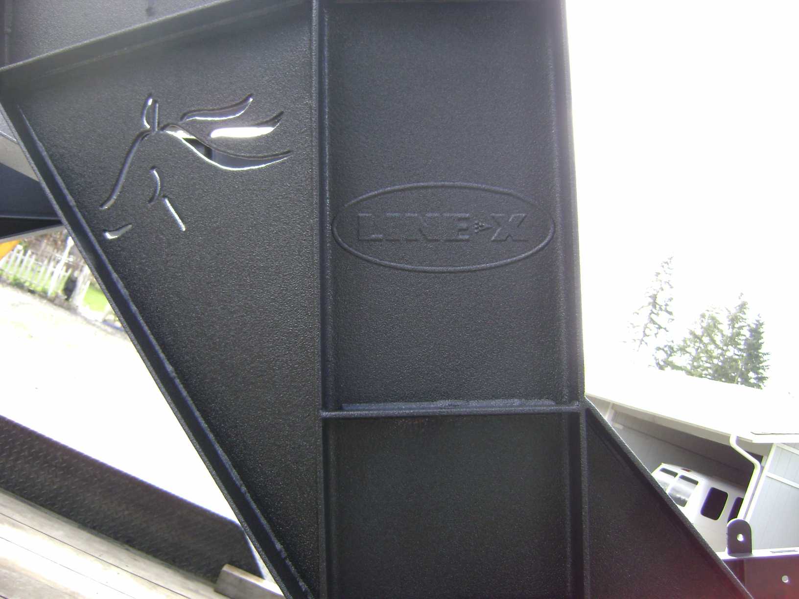

When I built my gooseneck adapter, I got a screaming deal on the beams from Craig's list. I was quoted $2,000.00 to powder coat, but $1,100.00 to Line X. When completed, and I added everything up, not counting my labor, and consumables. I saved a whopping $600.00 over buying a new gooseneck trailer! :rolleyes:

That's nuts. Tells you what kind of markup the retail metal dealers are getting.

The part that pizzed me off to no end, I built one for my buddy a couple years before, he took it to the same powder coater. Cost him $500.00 to have his powder coated!:confused: Paint always makes me mad, I bought a 1966 red face welding machine for $200.00, cost me $150.00 for paint!!!!!!!!!!!!!!!!:mad:
