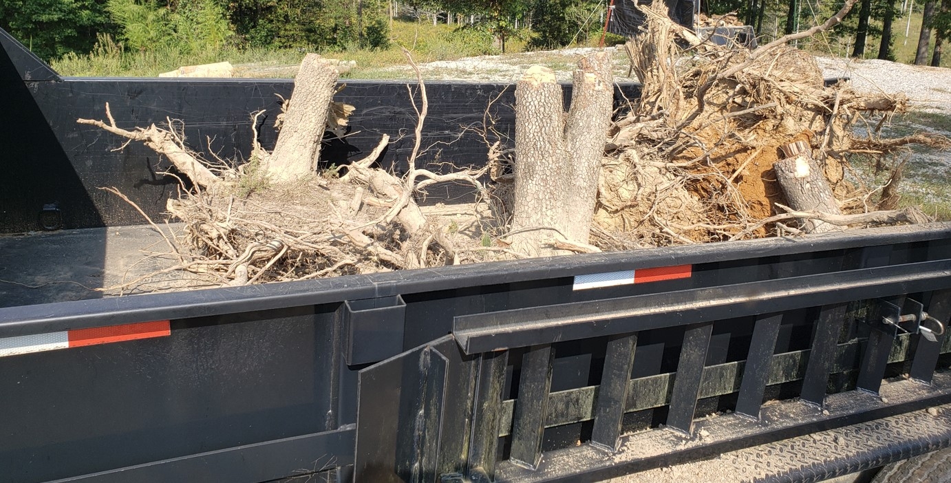

I had this same option and I decided on the T494. I have hilly property, some fairly steep stuff that I mow. I also stump grind and just recently got a stump bucket which works great! The TYM replaced my Kioti NX50 which I used for the same stuff but it had too many issues so I traded in for the TYM without all the BS electronics that causes many problems.
You can possibly save some money if you buy the TYM RK55 version of the T574. I probably would have done this if I didn't need to trade-in.
View attachment 1288614View attachment 1288615View attachment 1288616
