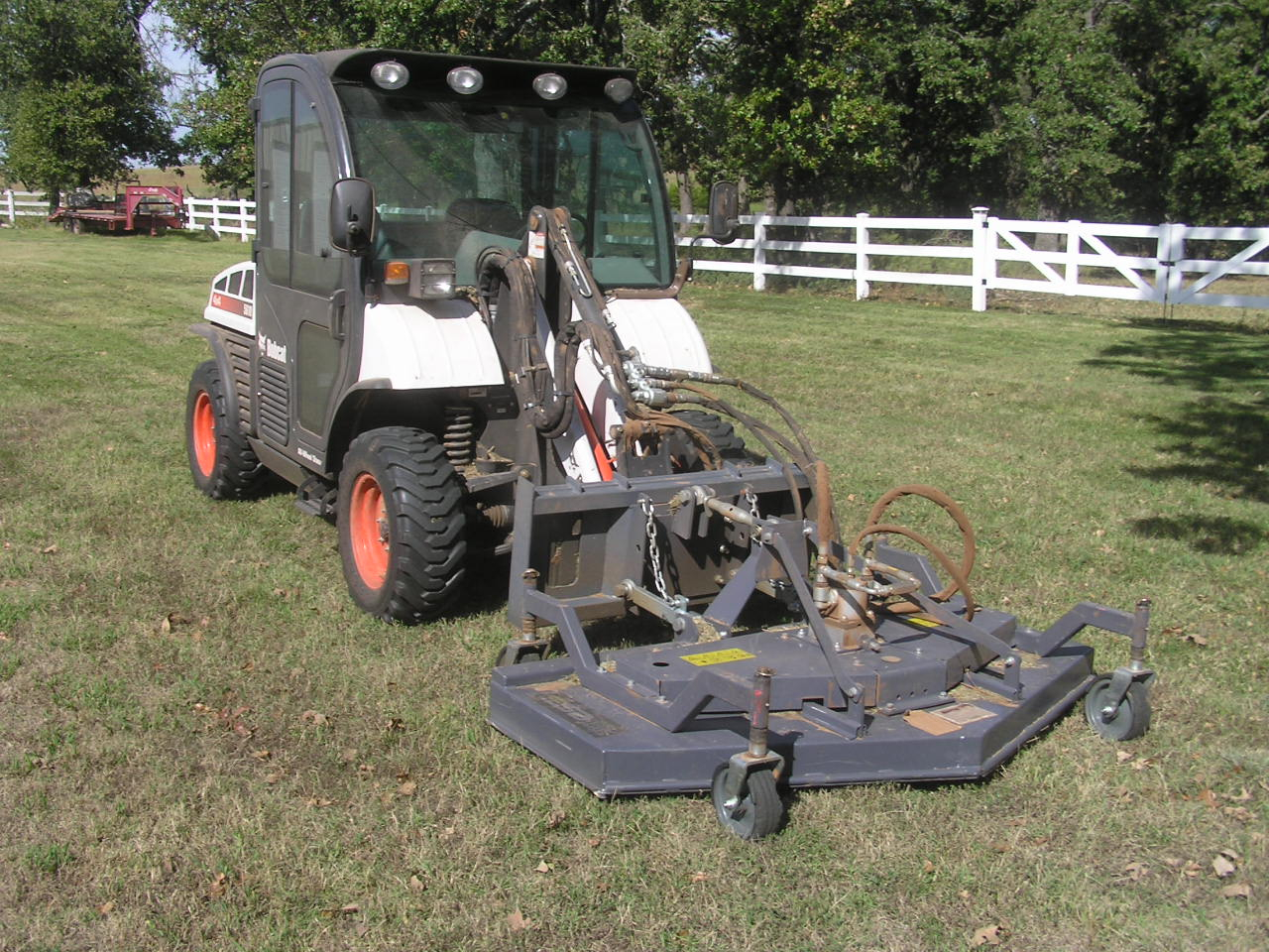

that looks a neat machine, can you get a regular skid steer mounting for it?

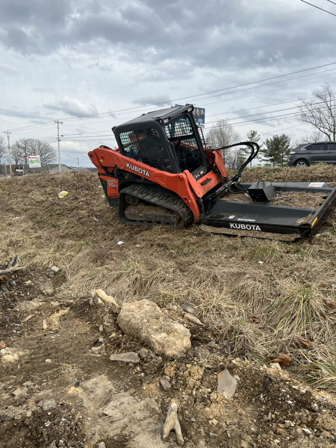

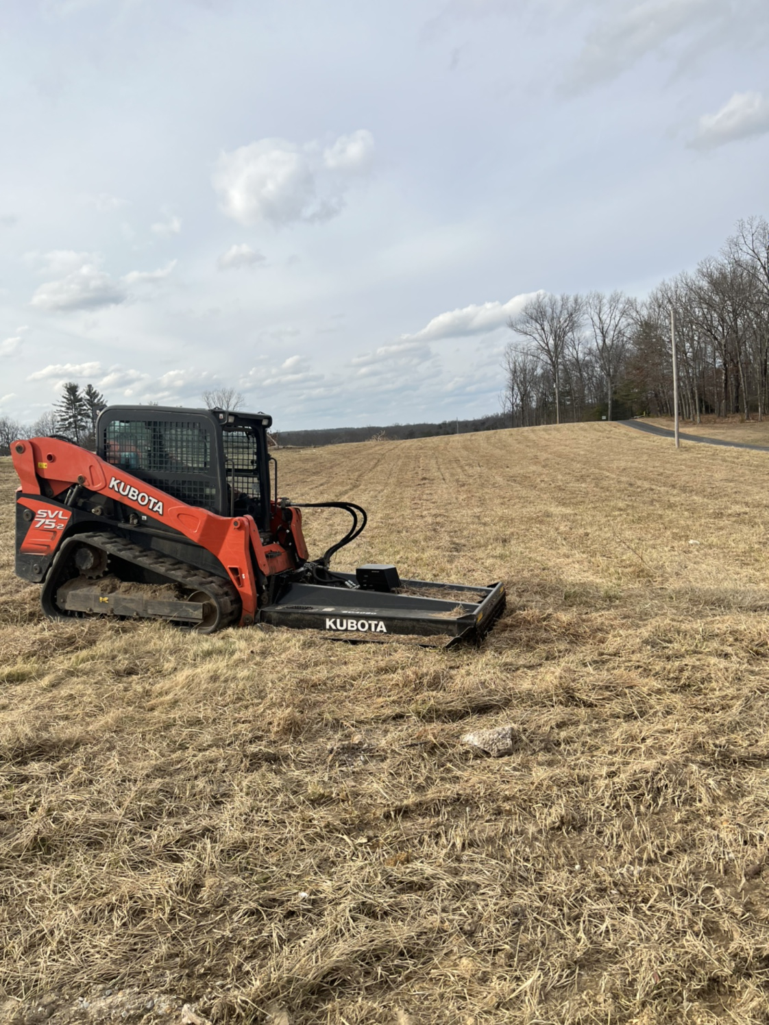

I started out pulling, but now would much rather push.
The 6' finish mower is a good pusher:
View attachment 731425View attachment 731427View attachment 731429
If you have a cab it’s not a big deal but I found that pushing a bushhog makes a lot of dust. A tractor will beat the CTL in cost of use but I was pretty pleased with how well it worked.
