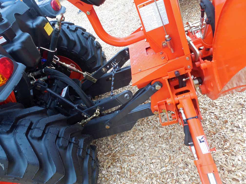

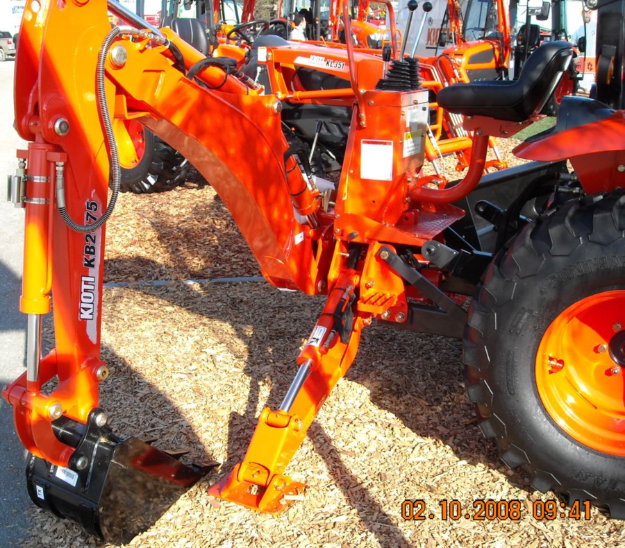

The issue is that the hoe has to be mounted even further aft in order for the hoe seat to
clear the tank. With the longer subframe, driving the tractor over the slightest depression
results in grounding the hoe. A seriously small "angle of departure".

Maybe with your backhoe...no issues if you get the Kioti hoe.
I am talking about the Kioti hoe, but the same issue applies to other hoes on the CK3510 or 4010
tractor. I am glad yours is working well for you.
Here are 2 pix, one of the 2475 hoe on a CK35H, and one of the 2475L hoe on the CK4010H. In the
latter case, the hoe is mounted at least 6" further aft, so the seat can clear the tank.
As for my own hoe with custom subframe, my hoe is at least 12" closer to the tractor. And I still
wish I had more departure angle.

The way the sun shines off hoe in the first pic. makes it look like a cool custom paint job .
