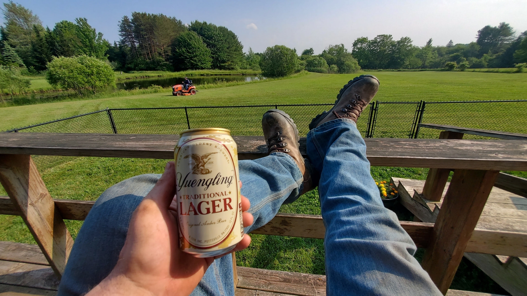

I bought a BX2680 with a 60" mower for the sole purpose of mowing, cause I needed the 4x4 for the trails. I put spacers on the back which widened it a bit. It will mow field grass with no problem. The machine is a beast for a little tractor. I highly recommend getting the remote control option although it can be a bit finicky. You can see it in action in the pic.

That remote appears to operate child labor 🤔 When you upgrade to spouseI with the same benefits, you’ll sell out 😂
