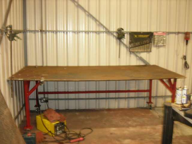

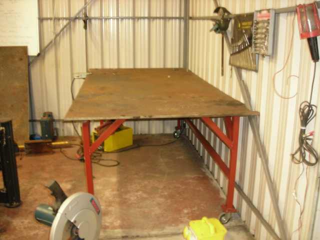

Nice piece of steel! The price was right too! I would take a DA or sanding disk to the top of it and clean it up to shiny steel. That would make welding easier and keep engine parts cleaner.

That looks good, but it ain't the heaviest. Mine is 4' X 10' with 1/2" top, 4" pipe legs and a band of 8" channel all the way around and across the center. I wish I had the casters on it like yours, I have to drag mine with the tractor if I want to move it any. Later, Nat
I would have to agree with Nat, I've seen his and I don't believe that you could turn his over with the 'come-along' set up that you used. IT'S HEAVY!!!

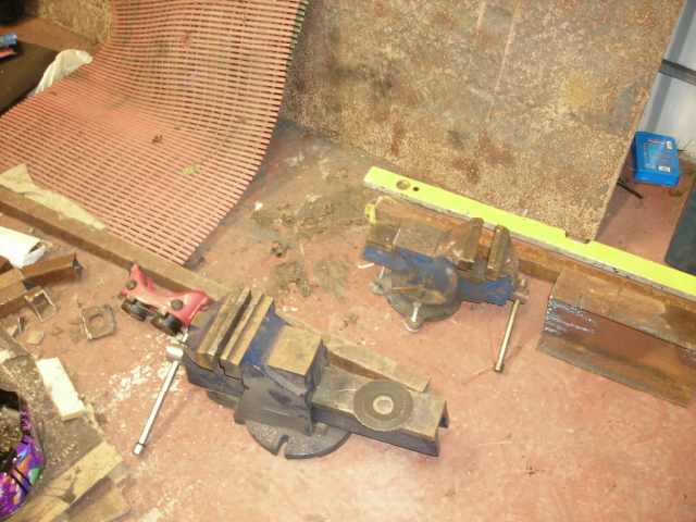

Suggestion for your vise; I would normally put a vise on a corner and make sure that the rear stationary vise jaw extends or is postioned outward of the table perimeter. This way if you want to clamp a long vertical piece of wood or metal into to the jaws, it clamps the item without that item hitting the tabletop. It is really frustrating when someone as mounting a vise too far inboard on a surface and you want to clamp something with the long vertical piece hanging downward. I hope you understand "my explaination". Also the corner position gives good support because you have the table support right below it. Note: with the wheels, you won't be able to perform much bending of metal using the vise. The best setup that I have used, was a big stationary vise on a thick table welded to the support I-beam of a large buiding in the center of our old shop. It was very helpful.

The castors looked suspect to me, too, and I SURE wouldn't wanna get a corner of that thing on me! Also, if you are welding something toward the middle of the table, aren't you apt to get some warpage withoue a lengthwise stiffener under it? 3/4" is a heck of a lot of steel, but heat can do funny things to it, too.
Great use of a road plate, though, and I sure wish I had it in my shop! As far as the width - heck, leave it, if it ain't eating anything; there'll be times you'd pay good money to have it back if you took it off or cut into it. If you don't have to use it, you don't have to!

I'd bolt one vice as said earlier with the back/fixed jaw at least even with the edge of the top. The other vice I'd leave it so that I could clamp it anywhere I wanted to , more flexible like that. I think the casters are OK. One thing I did to mine was run a ground from next to the welder out to the table and fasten it there. I can clamp the ground from the welder leads to the ground that goes to the table and only have to move 1 lead as the ground is already grounded. Later, Nat

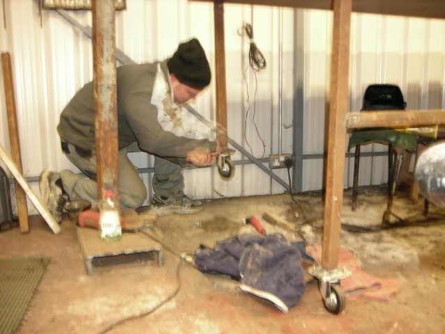

I thought the legs looked long in the first photo but chalked it up to the picture. Looks like you've fixed it though.

It may just be the pic, but the table looks like it bows down slightly on the long dimension, maybe a stiffener under there would be a good idea?
I think it's great to have a nice heavy work table like this, but being 4' wide, all it's gonna do is collect stuff on the back half till it's full - don't ask me how I know!
I think I would have narrowed it on the long dimension to about 30"..............

Just my thought but as far a vices go, I use a piece of 1 1/2 3/16 square tubing inside of the same size 2" tubing welded in misc places around my table. This way I can make plates for stuff like anvil's,Vices, chainsaw blade sharpeners and other tools. The tool can then be removed and nothing gets in the way of needing a big surface to work on.
If you have a big surface you will use it. Murphy's Law!!:D

Hey Ronan, like many people I just clicked through the pictures and didn't read the comments until after the last picture.
Thought to myself "who could use a table that high?"

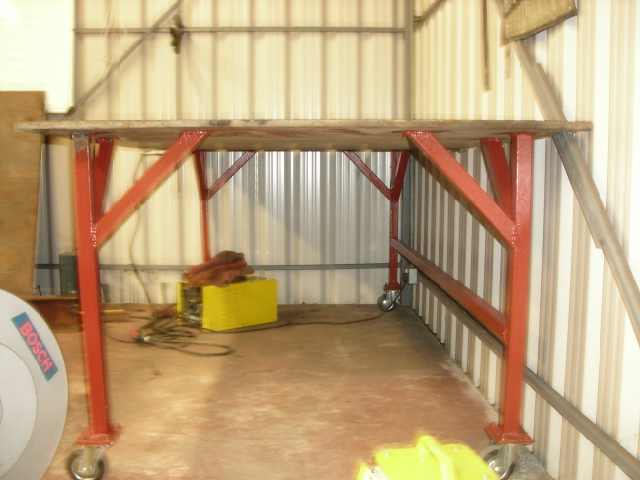

Also thought it might be heavy, but once you put wheels on it that goes away, even an olde fart like me could move it around.
Sure you will cut it down and it will be that heavy work bench you were looking for..........
