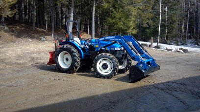

I have 202 hours on my 55.Only thing I have had problems with was pump presure was not turned up.
Took it back to dealer to check it. Pump was at 2300 not 2500.
55 hp for under 28000 good price for size.

Agree!
In the interest of full disclosure, the tractor in this picture isn't on our farm anymore. At 202 hours, we had a big ditching project coming up on my vacation. While fueling up, I was fiddling with bolts and noticed one of the bolts holding the the FEL/backhoe bracket to the tractor was loose. When the dealer's repair truck came, they found 3 stripped bolt holes on one side and probably more on the other.
No fault of CNH though, the guy who assembled our tractor at the dealership slammed wrong sized bolts (SAE into metric threads in one case and metric fine thread in a couple holes, and too short of bolts in another), ruining the bracket mount on the tractor.
Good news is the dealer made it completely right and swapped us a new WM 55. The new one has 155 hours now and is perfect.
To be fair, the old tractor ran perfectly too, just assembled wrong, pre-delivery.
