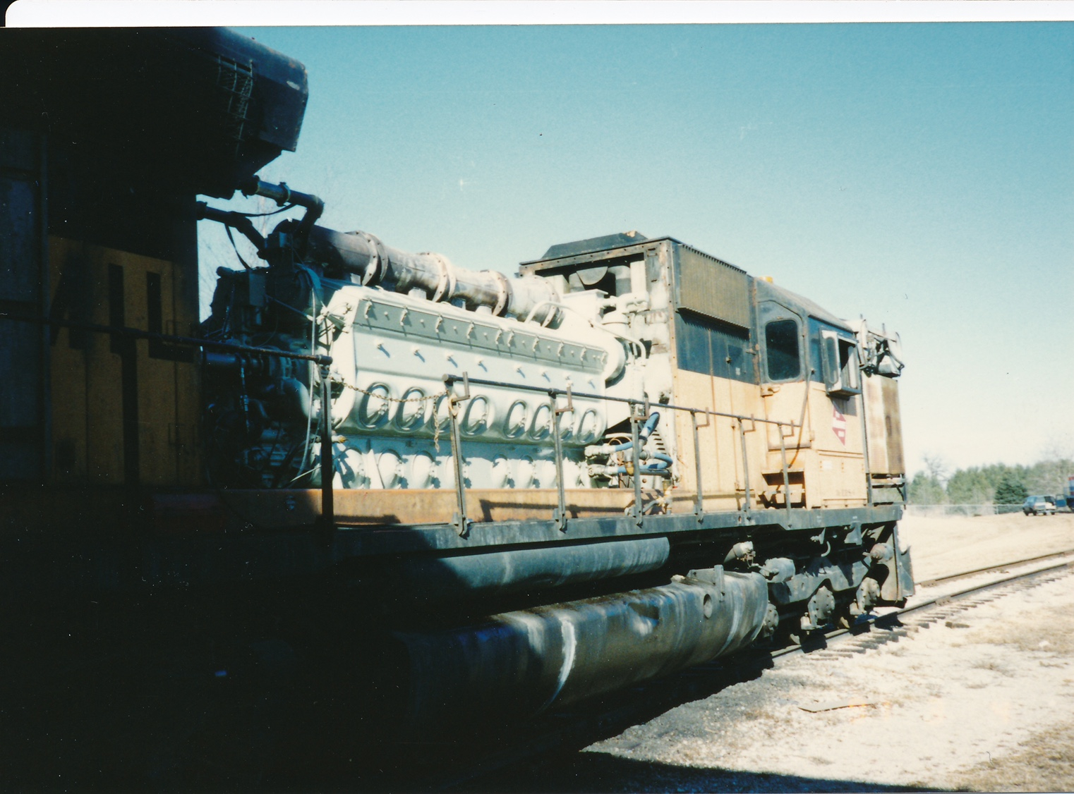

EMD testing

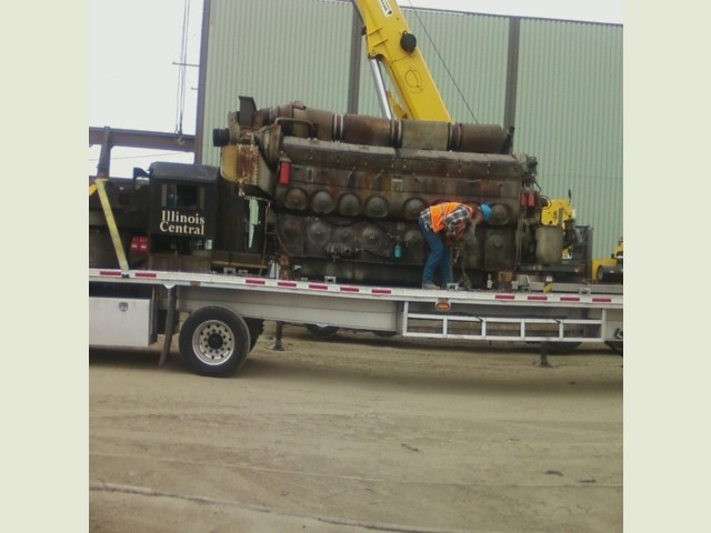

We hauled some EMDs out of a locomotive scrapyard in Homewood, IL some years ago. A 16 cylinder 645 engine and alternator were over 45,000#.
