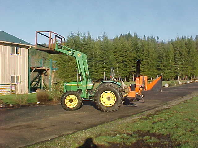

Hi,
The other thread concerned walking under a loader. Bad practice! Best to be avoided as others have said.
But how about working off the loader? Wouldn't that be "almost" as dangerous?
All the things that could go wrong to cause the loader to crash down and crush someone, could also cause the loader to crash down with someone in it, or in/on a platform attached to it...
I know it's better land on top, rather than have it land on you, but still...
I guess it's a gamble...but seems like one we are willing to live with...or should that be "live" with...?
Bill in Pgh, PA

I work out of mine limbing trees, getting on the roof, and such. I like it much better than a ladder.
When you think of firemen, powerlinemen, construction lifts, we all trust hydraulics to a point. Inspect you hoses and fittings. All things mechanical can fail at any time.

I do a ton of work off of mine. Whenever I've built a house or a barn the loaders are the handiest tools. I don't see how it's much more dangerous than using a skillsaw or a ladder. I'd much rather be 20 feet up in the air in a loader bucket than a ladder anyday. If you're smart and watch what you're doing you should be ok.

I have spent a few hours up in the air with chain saws cutting limbs while my father-in-law moves me around in the bucket of his '55 Ford. ( I am very, VERY good to his daughter /w3tcompact/icons/grin.gif!!!)Probably not the safest, but I have always thought of tree work as risky anyway.
I got pallet forks for my new tractor and am going to build a "scaffold" platform to do some house siding work. I plan to join two 4-foot pallets with beams into a 4x8 platform and make a permanent 3-sided safey railing with a removeable 4th-side rail. I also plan to "rest" the assembly against the wall in case the hydraulics fail or bleed down. Finally, I plan to used wheel-chocks to prevent rolling. My loader arm has a boom "lock-out" switch which prevents unintended boom movement.
If there is anything else to consider, I would appreciate the suggestions.

I put together this platform in a few hours. Lucky that the tractor is equipped with a quick detach for the bucket, just takes a minute to change.

That's EXACTLY what I had in mind, except pick it up with the pallet forks. Is it metal or made of wood?
Mark
   / Working Off Of a Front Loader? #9
It is made of metal. I put a 3/4 inch plywood floor in it though. At first it was just the bottom without the rails, I used it to lift the stove, piano, fridge up on the deck for the house. I did stand on it to do some tree trimming, but the rails not only keep you in, they are great to lean against when reaching out. I have one of those extendable chainsaws, with the lift I can reach a little over 25'
