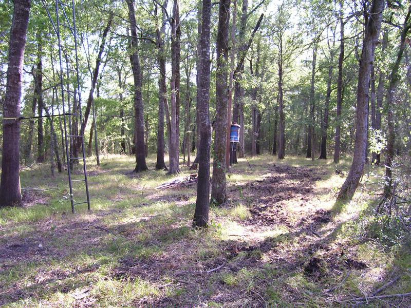

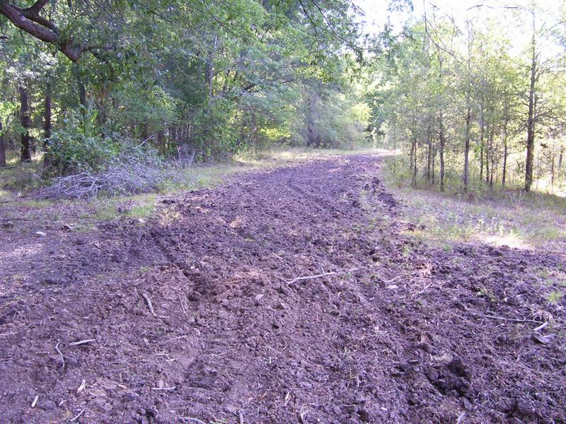

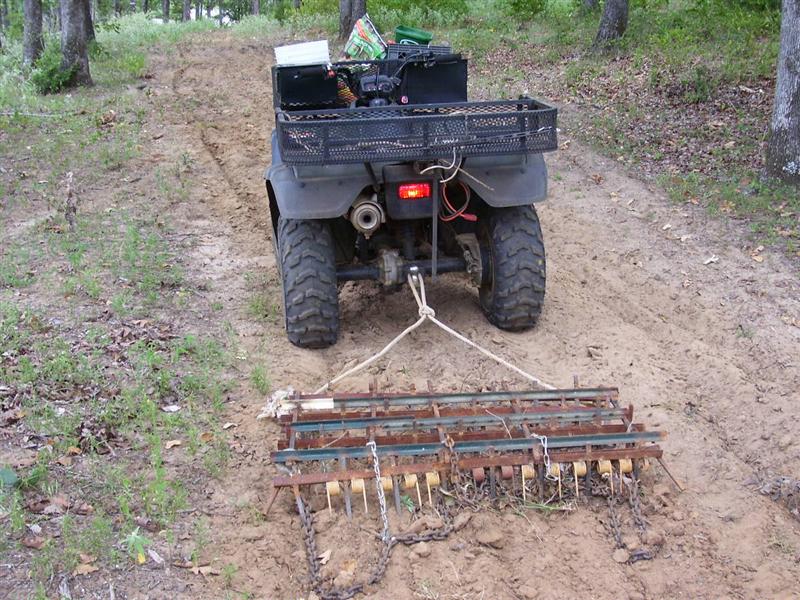

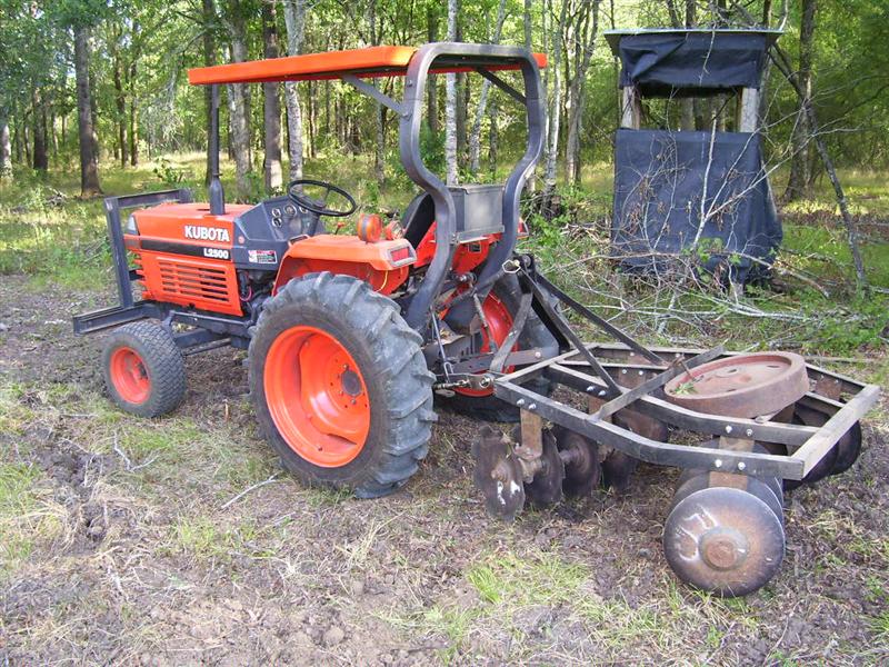

I think a disk will give you more flexibility. Using a 1 row turning plow may take a long time on 2-acres. And a disk should get you in the ground a few inches with a pass or 2 and that's all you need for a deer plot. The biggest thing that will help a deer plot is moisture!! :)
Some pics from Saturday when I was doing mine. The disk is a little 5' 3pt.
First pic is my disk setup, with the weight added in sand it'll bury that tractor.
second is some finished disked path, 2 weeks before I ran a sort of homemade 3 shank subsoiler thing. It busted up the black gumbo down to about 4-5 inches. The disk finished the job and cut it up nicely.
3rd, shot of some never touched wooded gumbo. went over it about 4 times and was good enough to catch some seed. I ran a drag over this to cover the seed.
4th..my homemade drag, nice to pull it with an atv.
