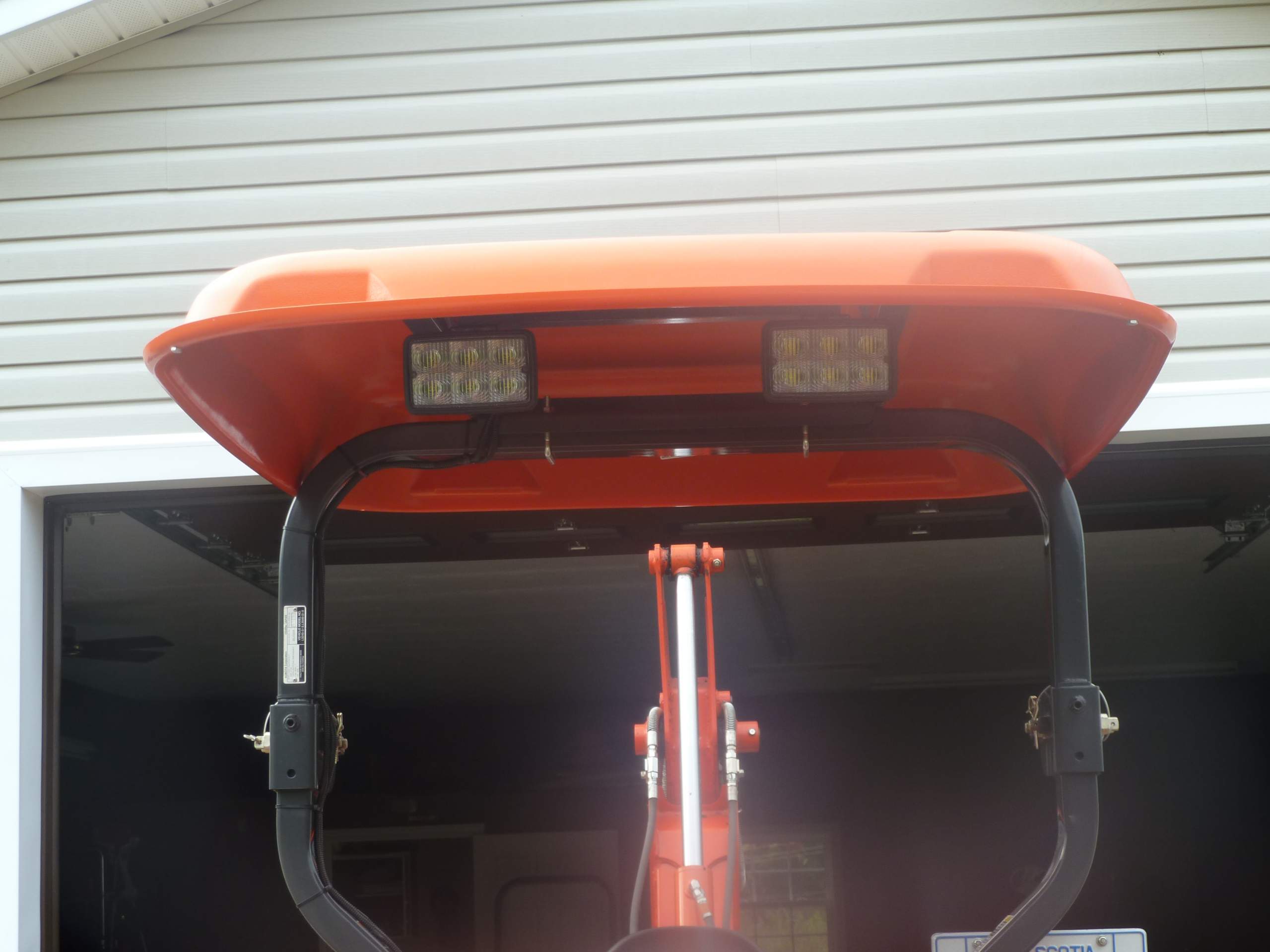

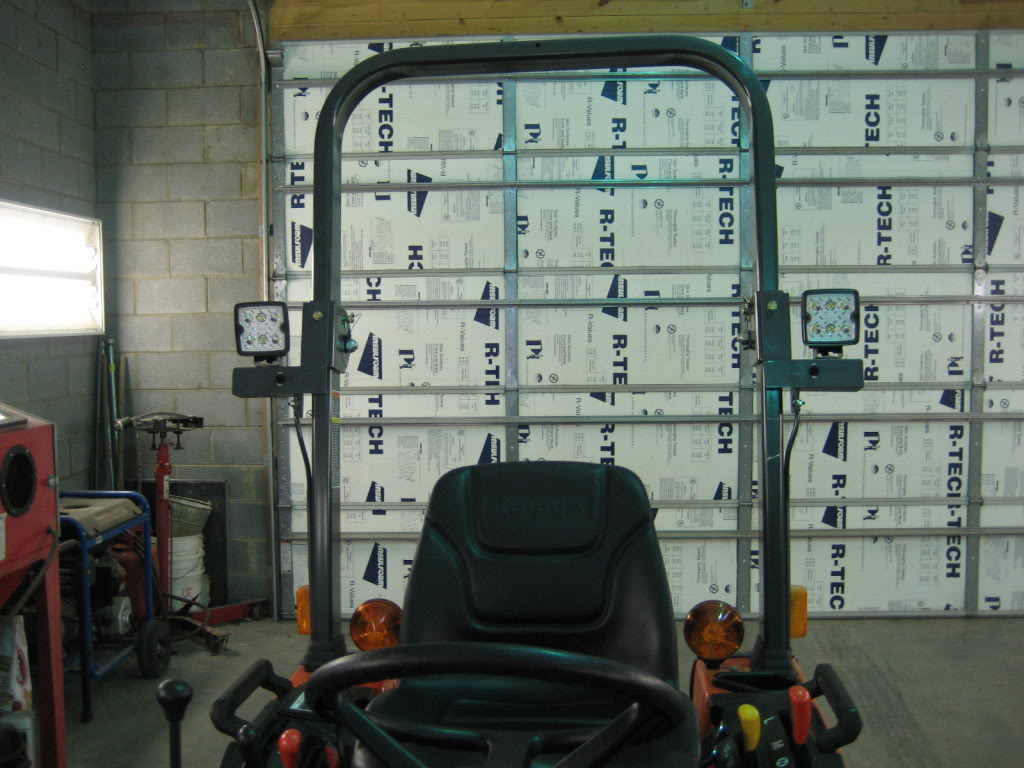

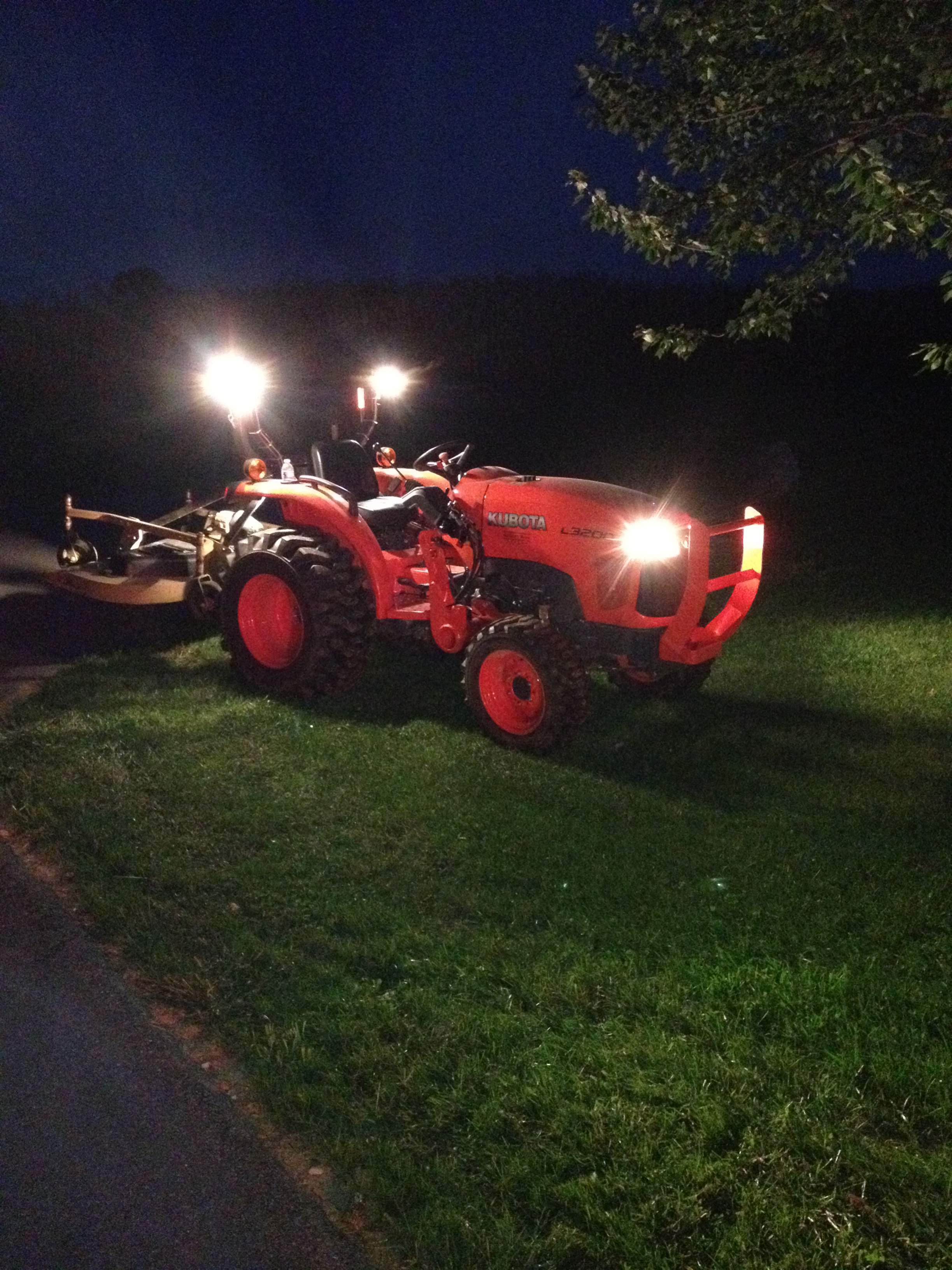

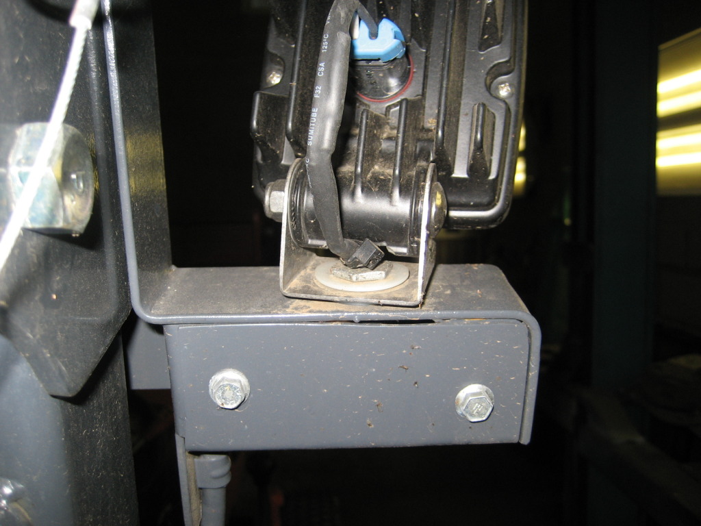

I had the same problem with my 3240,the factory headlights weren't much use with the FEL.I installed halogen worklights on the rollbar and it was a definite improvement but I found the light bothered me being so close to the back of my head.I later added a Kubota canopy with Grote LED lights forward on the canopy bracket.I found this to be a much better setup as the lights didn't bother my vision and were easier to aim in the front of the tractor.I considered the Kubota lights but every picture of them I looked at showed them on top of the canopy which would make it easier to rip them off on tree limbs.I mounted my lights under the canopy where they are more protected but don't interfere with my daytime vision.Hope this helps.
/ Work lights #12
This is how I mounted my Grote lights. I have them where they will work forwards or backwards.
