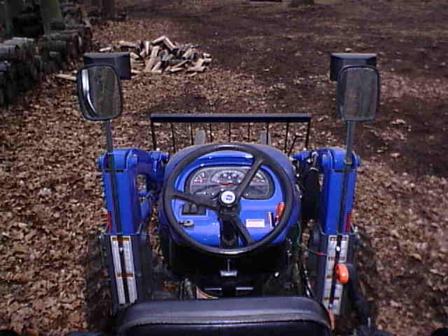

See attached pic. I added them to mirror stalks I mounted on the loader frame.

Mark,
How did you mount the mirror stalks on the loader frame? Did you drill extra holes, use a clamp or what? How did you wire them in? Are they an addition to the OEM lights or did you disconect the OEM lights? Thanks
Joe
   / Work Lights on TC 45 #7

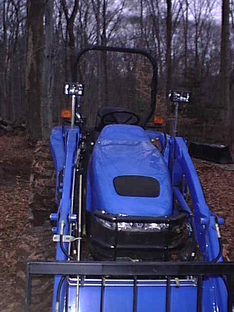

The mirror/light stalks are 1" box steel about 3ft long. There are already 2 holes in each of the loader uprights under the safety stickers. I just punched through the stickers, drilled the box steel, and bolted them on. The lights are bolted into holes I drilled and the mirror heads (trailer mirrors - mild wideangled) are directly behind the light heads.

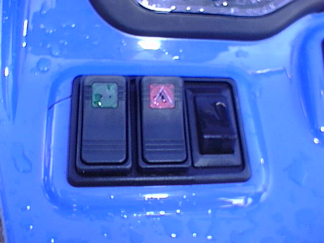

For wiring, I first tried to tap off the headlights, but the load was too much. I changed it so I have a relay (so they only come on when the headlights are on) and pull power from the battery. The switch from Lowes snaps right into one of the blanks on the dash (attached pic). The stalks ground to the tractor, so I only had to run hot wires.
Only complaints: I bought driving lights when I should have bought flood lights & the mirrors don't stick out far enough for my satisfaction.

Another view of the mirrors.
