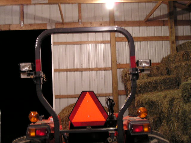

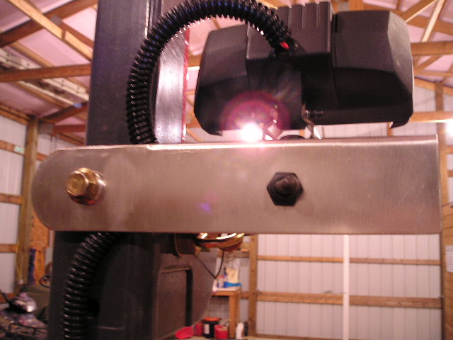

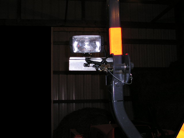

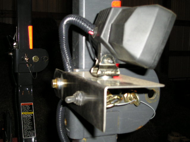

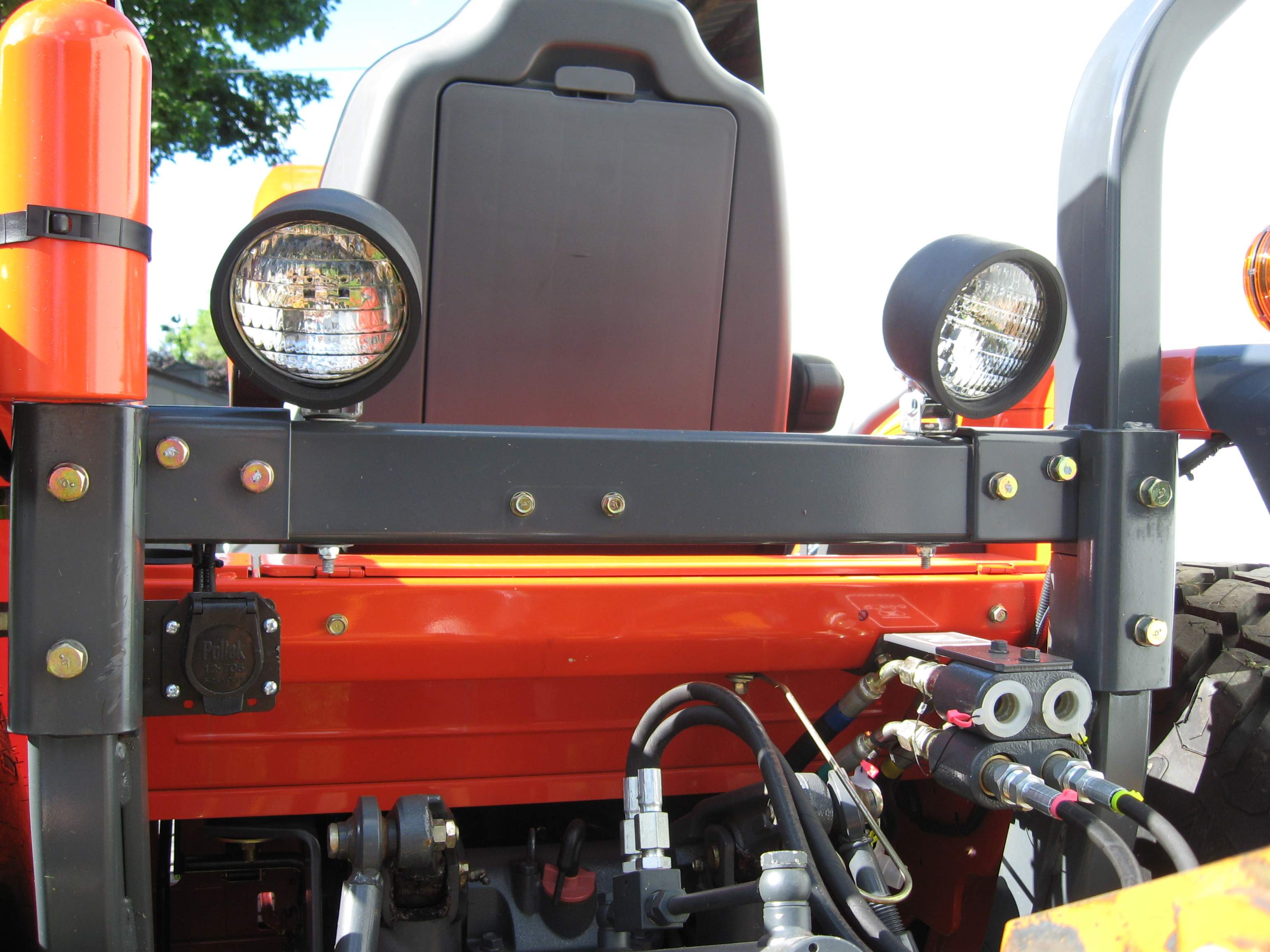

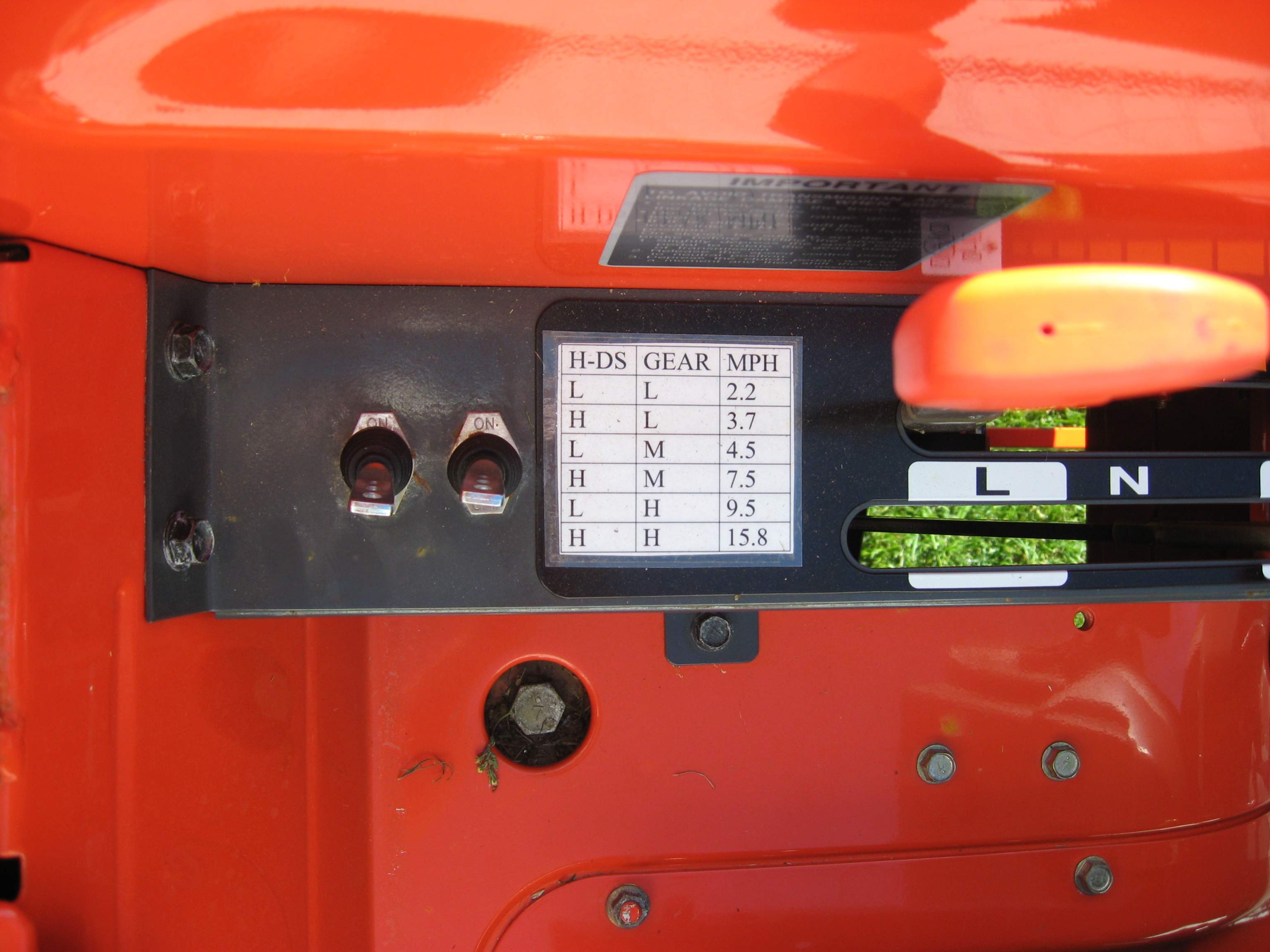

Here is what I did. Philip.

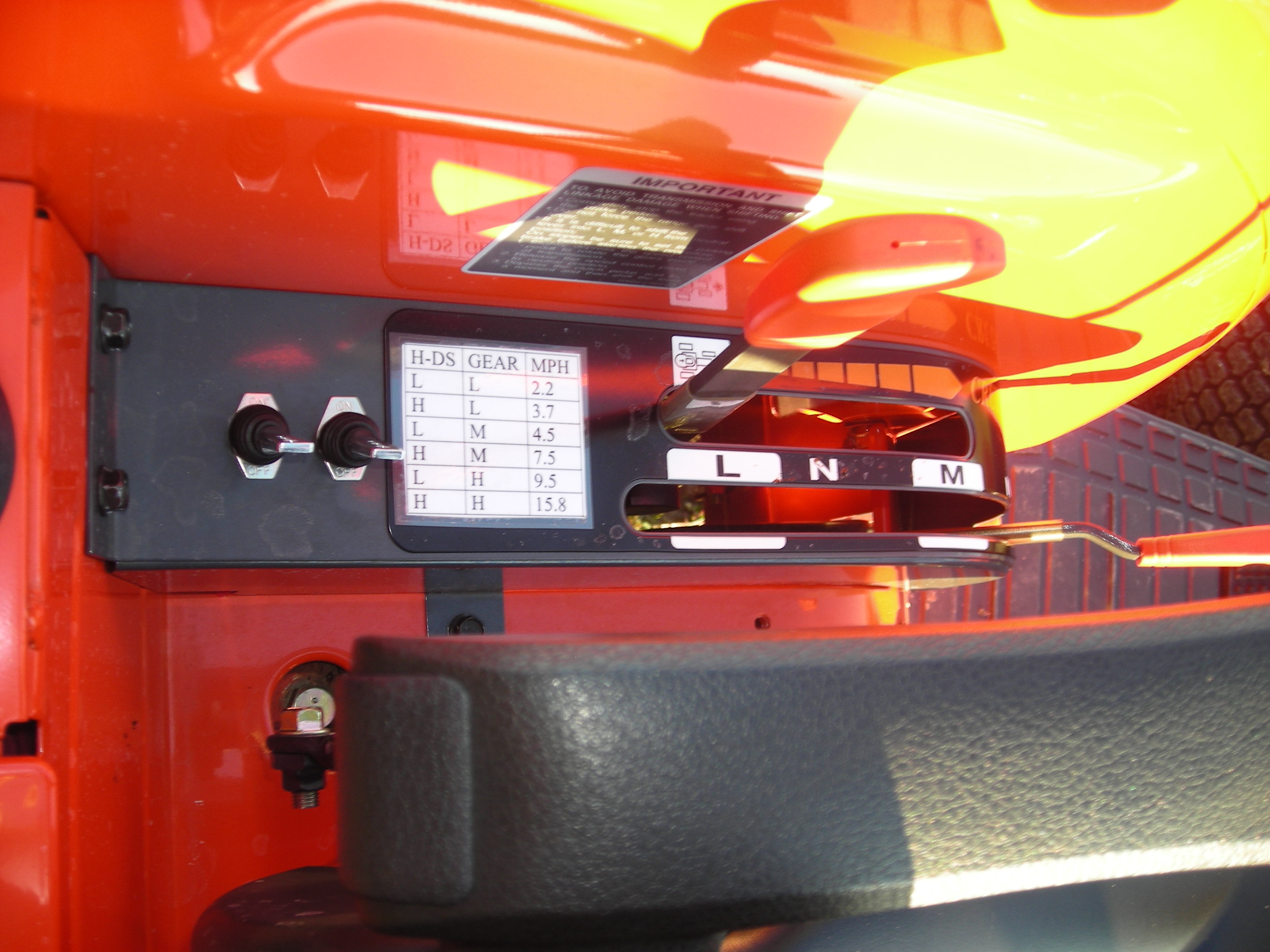

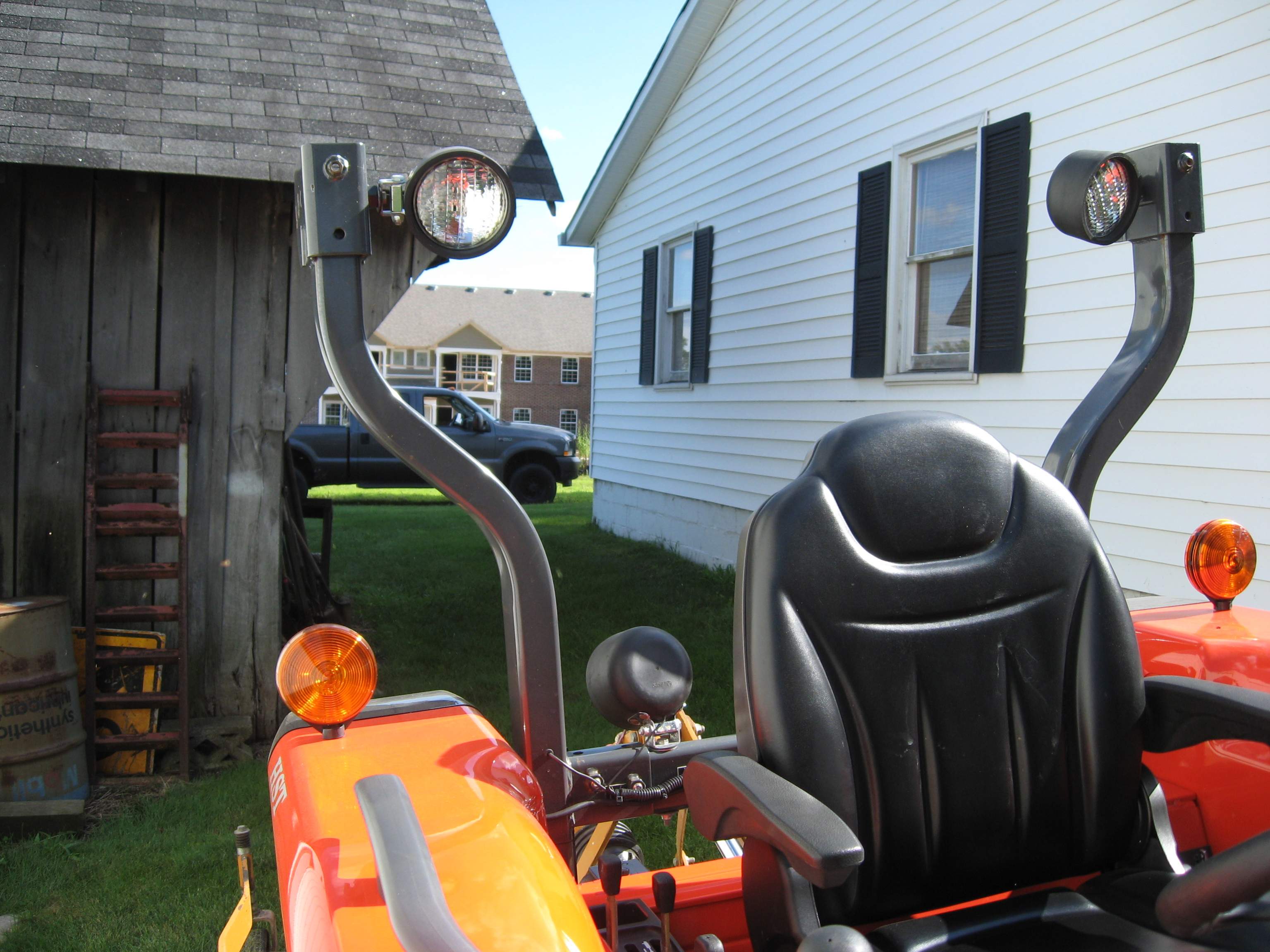

Here is what I did on my L4400
