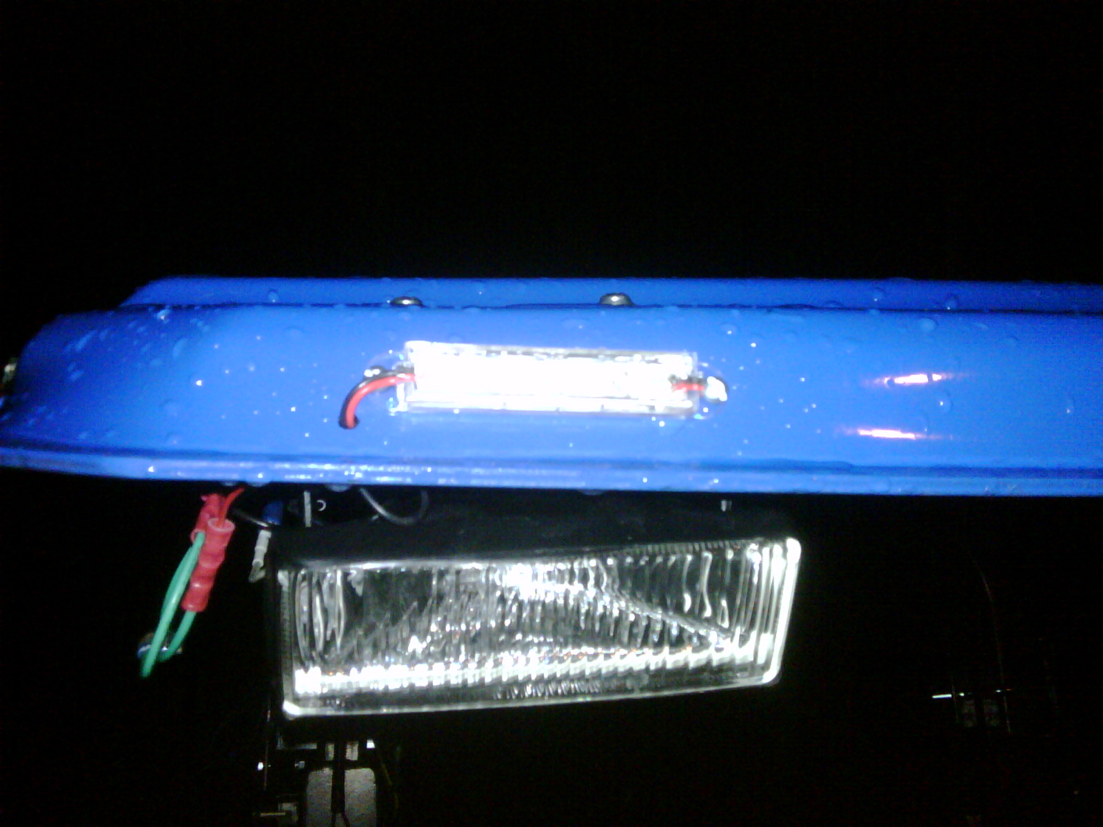

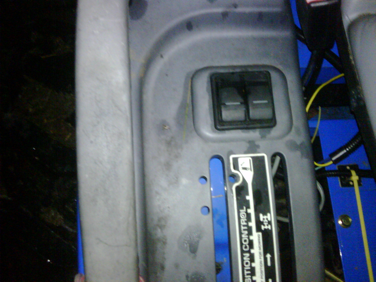

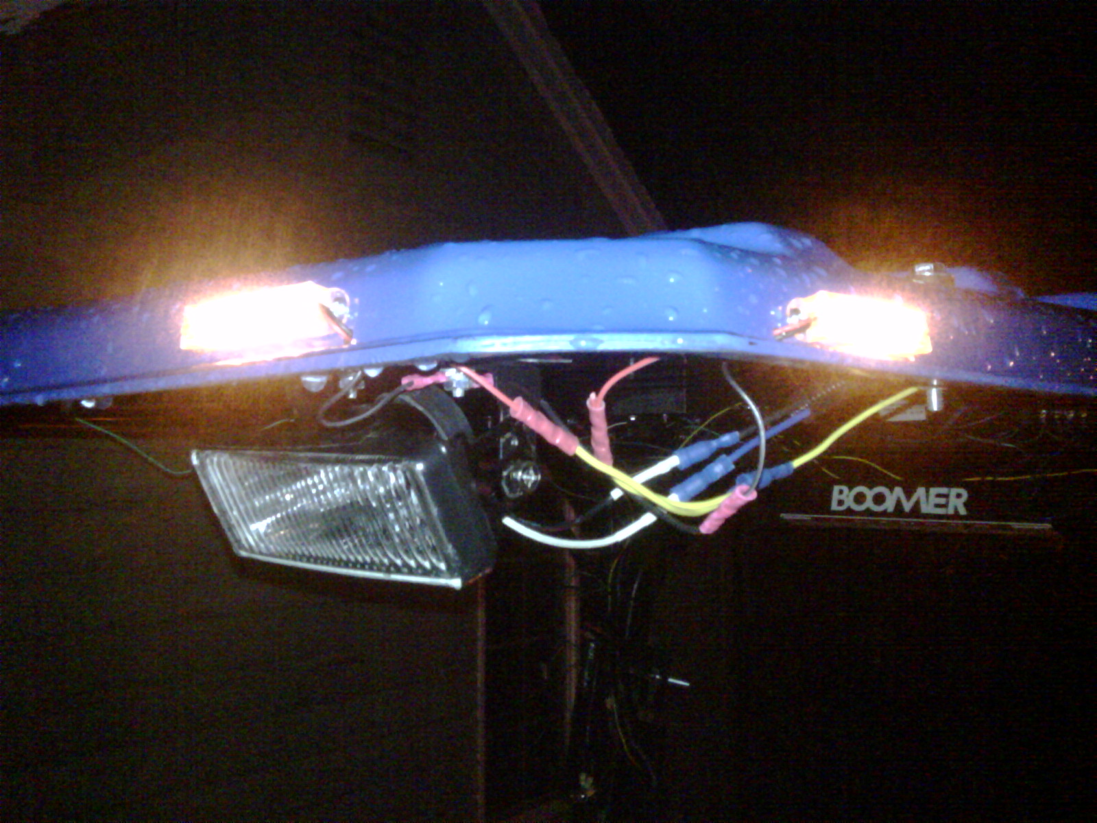

I just added small back-up lights to the rear of a canopy for rear implements, and fogs to the front.
They were cheap halogen lights from the chain auto-parts store, designed for probably more for cruising with your homies.
They have 55 wat bulbs, that I will replace with 27 or 35 to avoid alternator strain.
The cheap lights are imprecise enough that they provide lighting all over, not just in a tight fog pattern.
I added 2 rocker switches to the fender.
