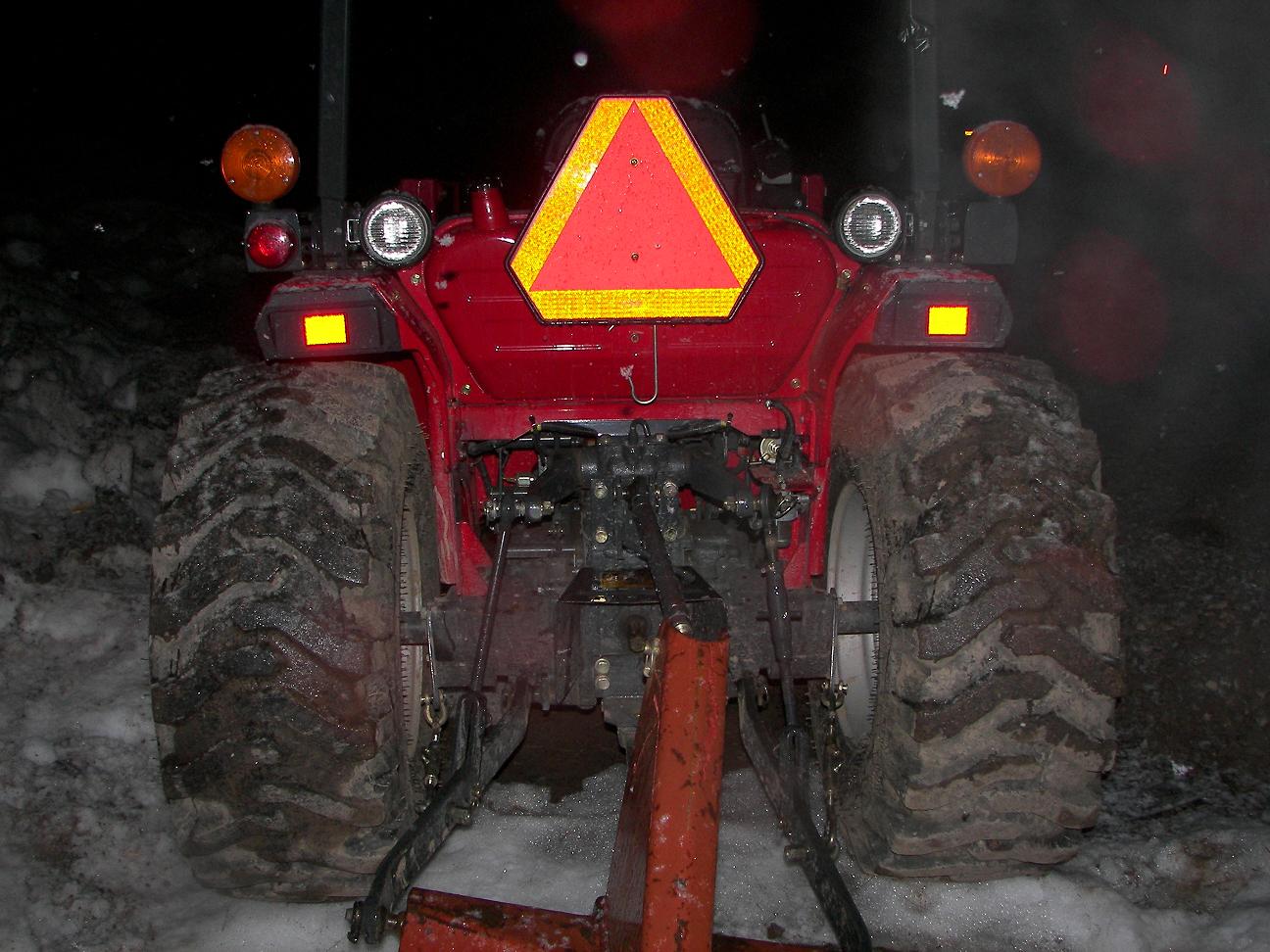

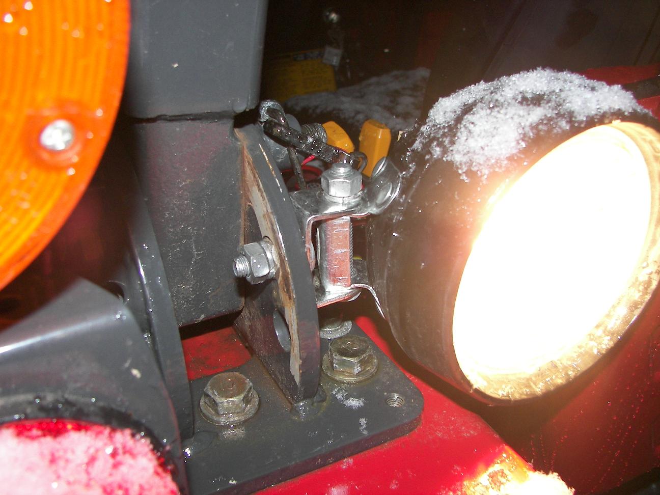

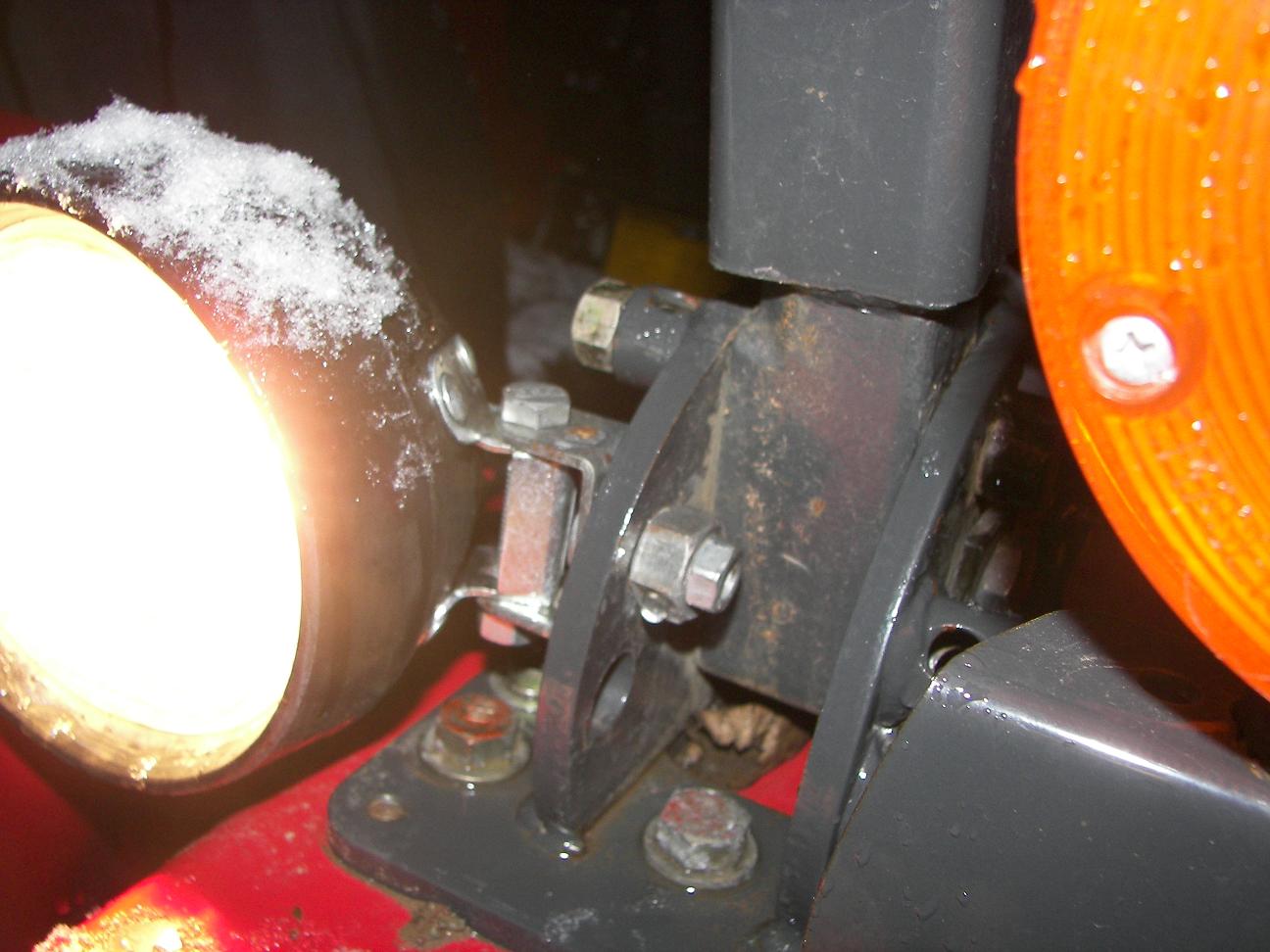

I bought some at harbor freight for 5 or 6 bucks each last fall. They are halogen and sealed in rubber with a glass lens, seems really durable. Mine is running off the little red light with a relay from the battery. One click of the headlight switch I have only rear lights for snowblowing and the second click runs the headlights and rear lights. Not the most ideal setup, but it works. I attached the lights using the holes already on the tractor. I think this would block the rops from swinging back, but I never have to take the rops down. The location of the lights protects them very well.
