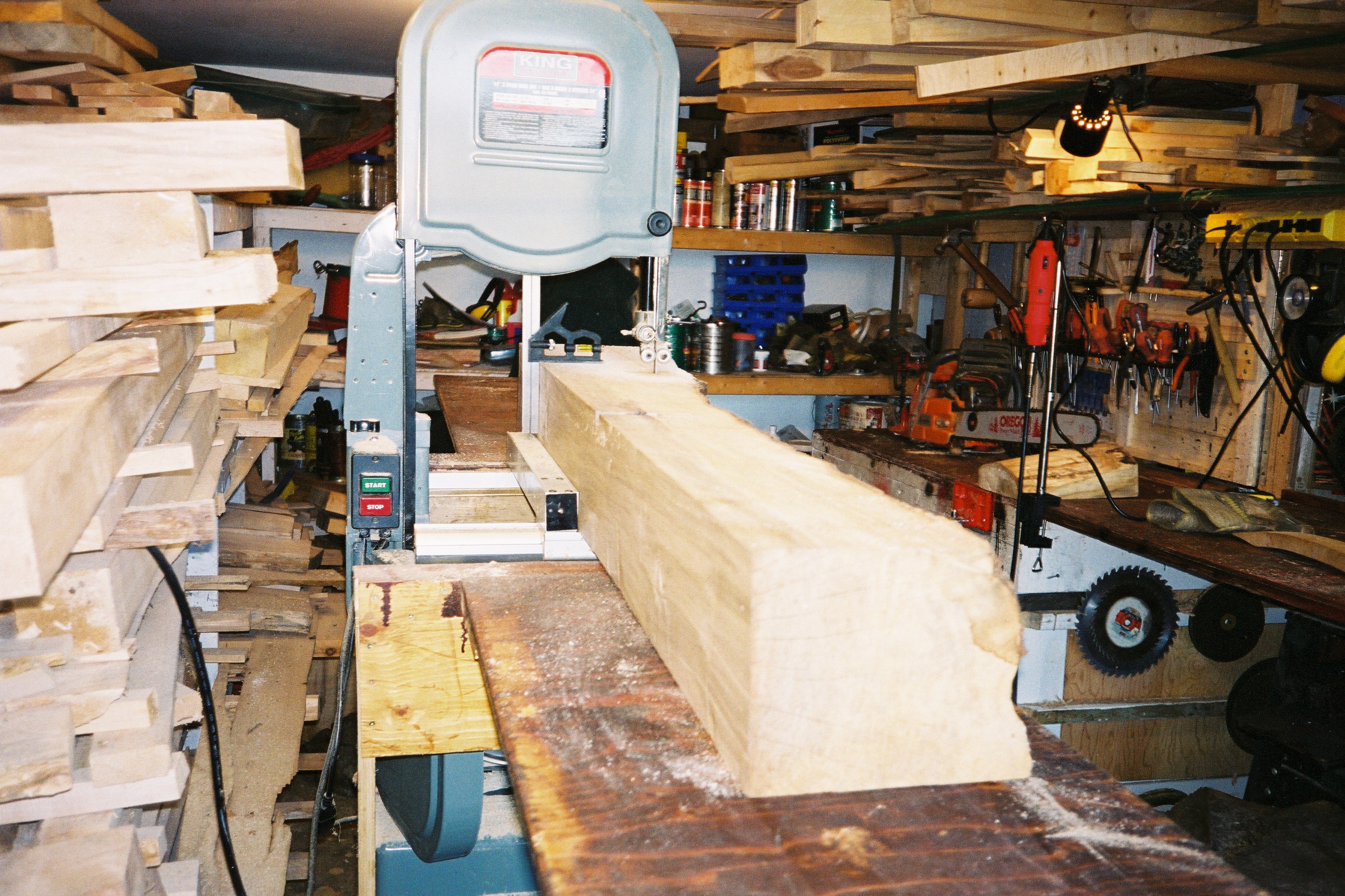

Around here most of the mills are set up with upright band saws with long feed tables and fences...logs are cut 8", 10", 12" + by whatever width the log is...unless there is a large order for smaller beams (timber frame job etc.) most cuts go to the band saw and not put back on a circle mill...
These days a lot of the commercial work (for builders/contractors etc.) is re-sawing old salvaged beams etc...this is almost always ripping long (often hand hewed) beams...it is all done with a band saw...
On our production saw bench we currently are using a 19" Grizzly band saw for re-sawing...

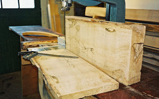

Skillsaw and a 2x4 work well for this. Lots of folks now use tracksaws.
In feed/out feed tables. No long fence needed; just a post opposite the blade works for many people.
With the right blades one can get a pretty clean cut. bandsaw c_edited-1.jpg
