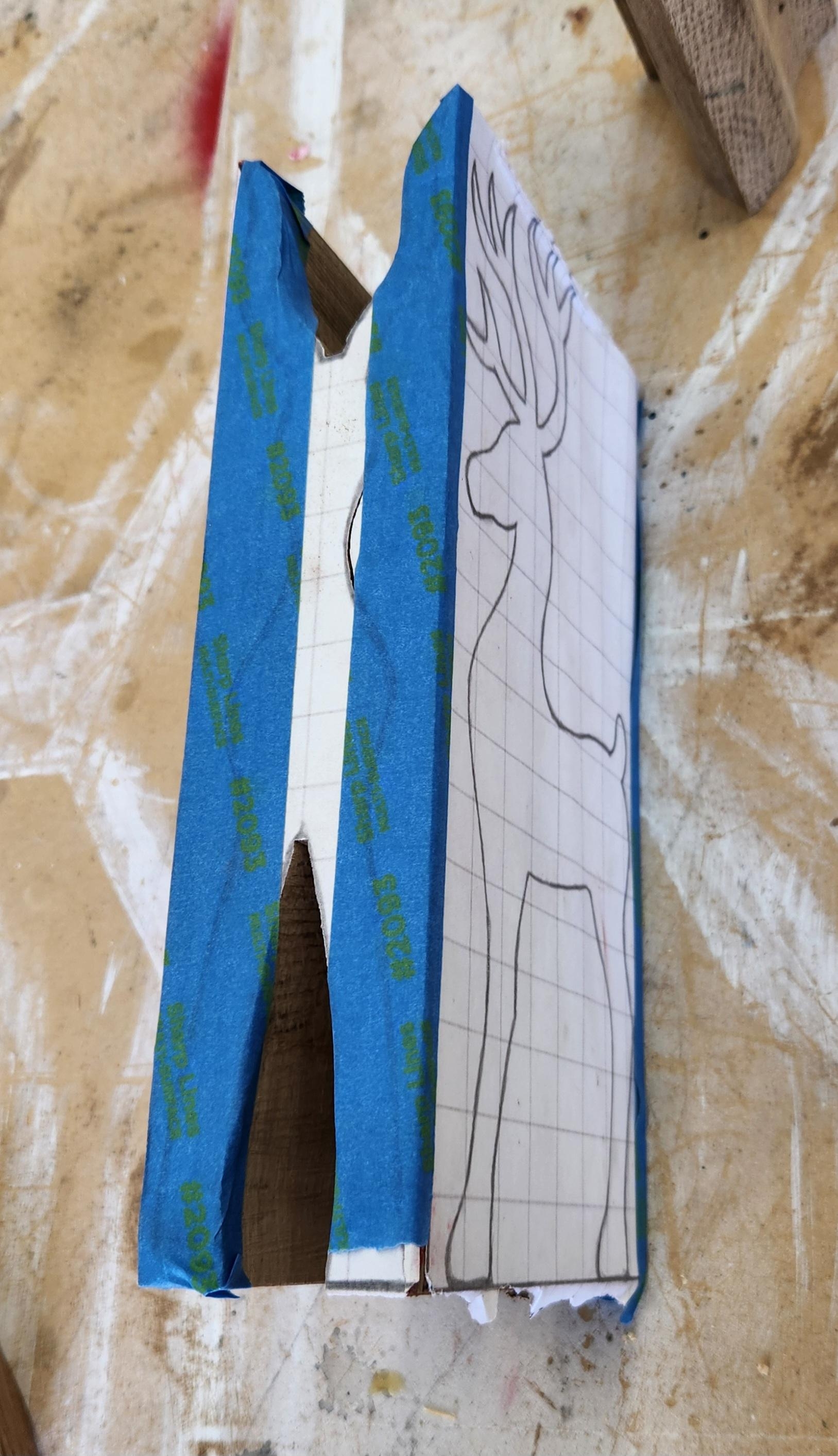

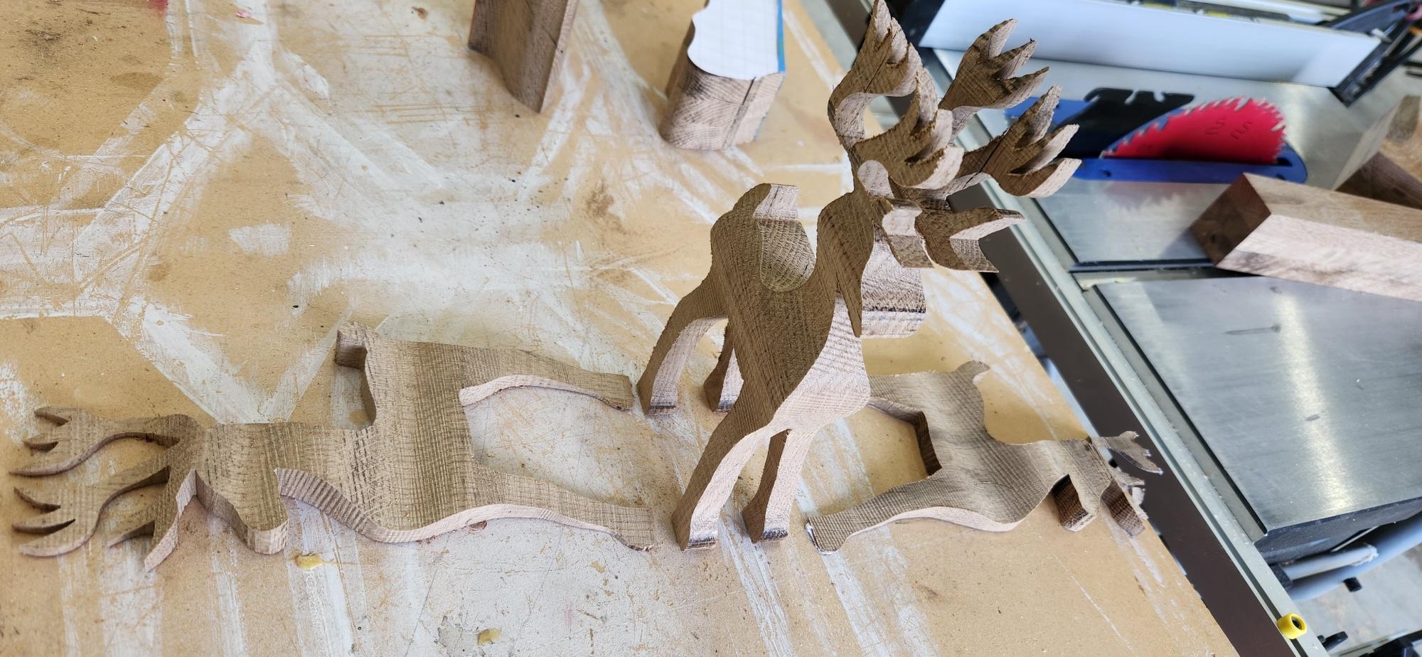

Once the first side is cut, you have to re-assemble the blank. I had been taping the top and bottom "plugs" back in, but I found that it's not really necessary.
Cut side 2.
Result.
The reindeer is inside.

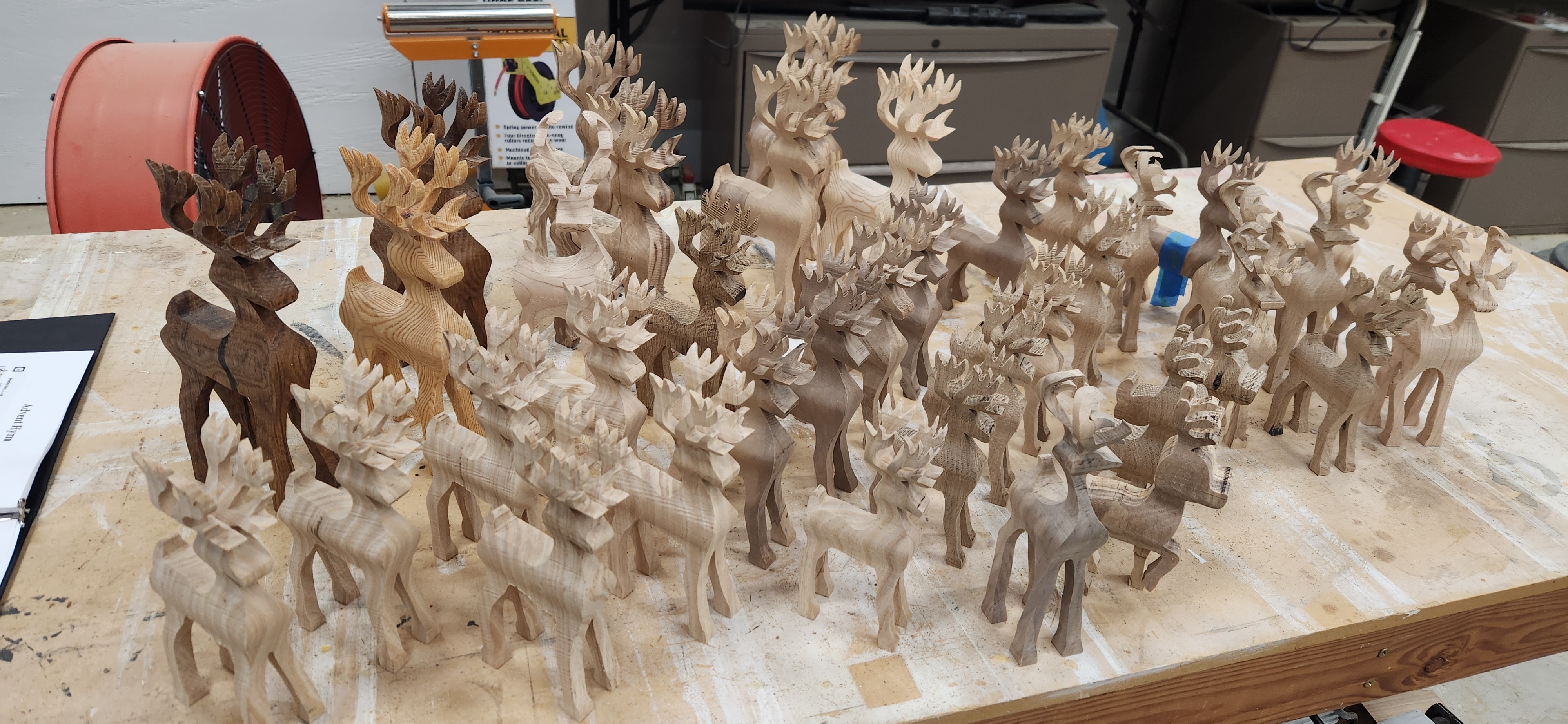

Nice job, I made and gave away tons of those deer years ago when I was much younger, I still have a few around.
I still have my patterns, and have thought about making a few, but there's just so many other projects ahead of it to get done first.

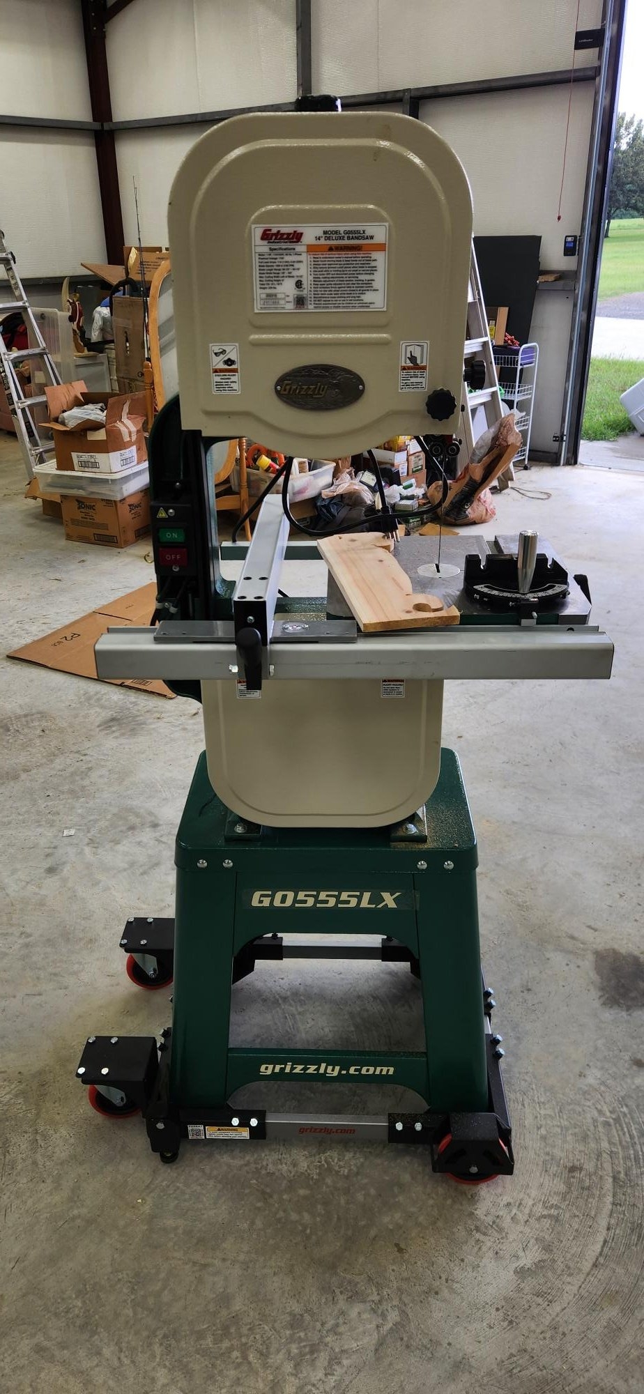

Are you using a ban saw for all of your cuts? Do you have any pictures of it? I'm curious how you get all those small cuts, but also the deeper cutting on the bench in the sleigh?
/ Woodshop Projects
#30
Turns out I don't really have many pictures of the saw. It has a 6-1/2" high capacity with height adjustable guides. Everything was cut on the bandsaw for the sleigh except for the inside cuts on the runners, those were made on a scroll saw. I glued up and cut the interior of the sleigh - the lighter color wood (pine because I had a leftover chunk already glued up from a past project). Then I glued oversized planks on both sides (red oak), and cut the outside all at once so it would all line up. The runners were cut as 1 thick piece then ripped into 2 equal width pieces with big tabs on the top where they attach to the sleigh. I had to do some figuring on how to connect them. I ended up cutting mortices by hand with a chisel on the bottom of the sleigh and cutting the tabs into reasonable size tenons.
