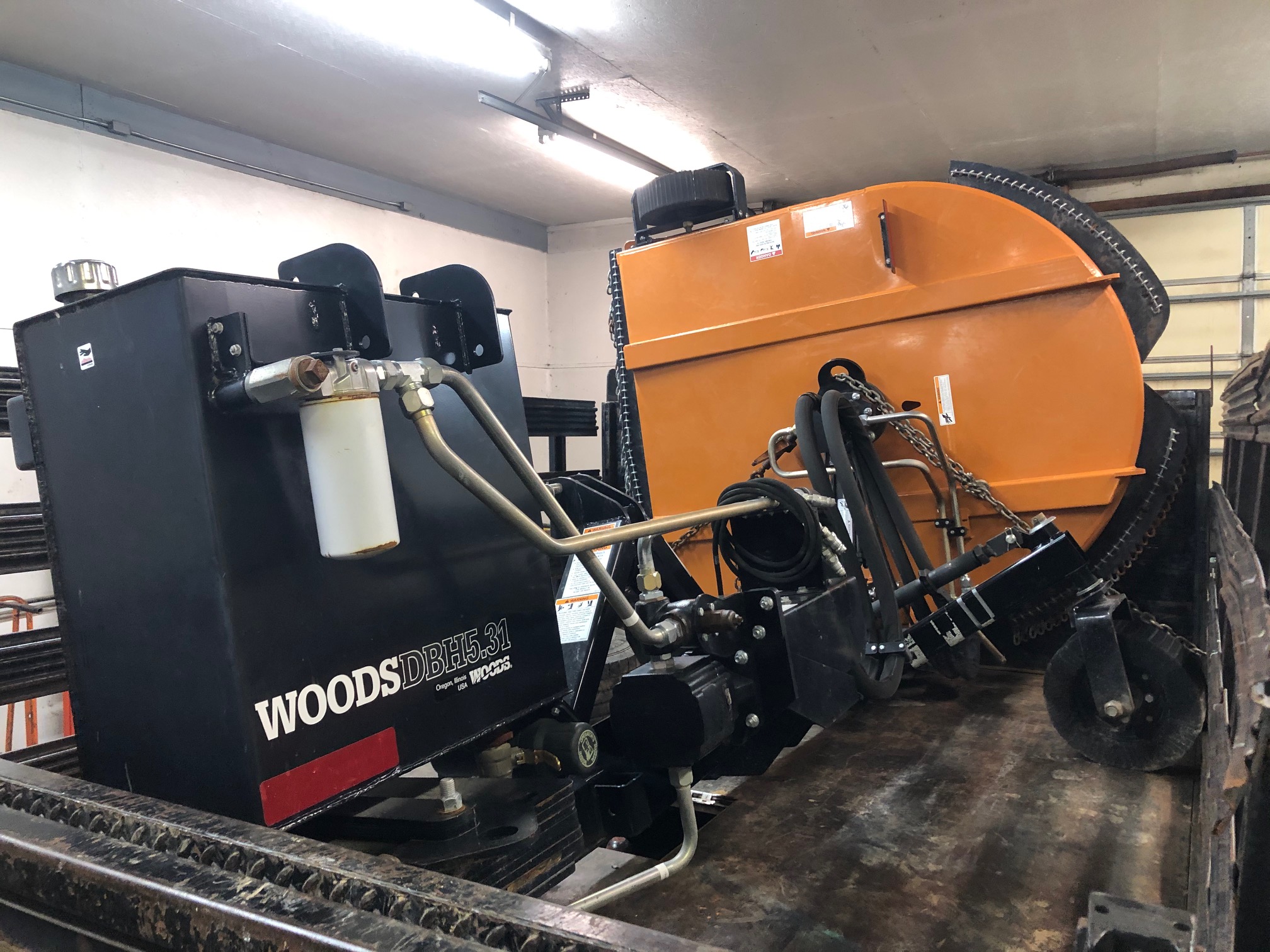

Found a great deal on a one year old used DBH5.30. Drove 6 hours each way yesterday to bring it home.
I have about 5 more acres to mow with my 8' mounted brush cutter before switching over to the ditch bank mower, but I'm excited to try it out. I'll update after it's cut some ditch banks.

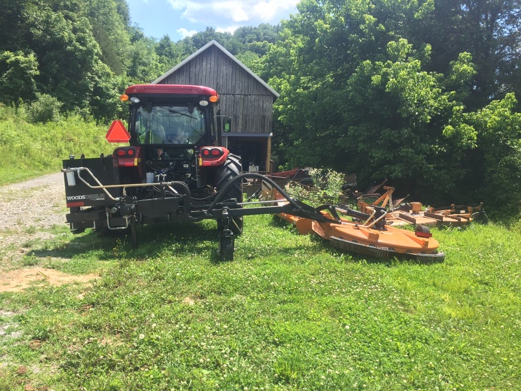

Ditch bank mower connected and ready to roll. Still have some adjusting to do to get it level though.
   / Woods DBH5.30 or similar experiences?
Here's a short video of the mower in operation. IMG_4196.MOV - Google Drive
It worked great. I have 4 different sections of creek bank I used it on, as well as the road. I turned it up 90 perpendicular to the ground and trimmed some tree branches back from the edge of the road too. So far no complaints. If the area is flat, you can almost set it and forget it. But many of the areas I cut had a drop off here and there, which caused the outside gauge wheel to drop, putting the blades in the dirt. It'll take a little figuring out where I can cut short and where I can't but luckily this slightly used mower came with a spare set of blades. :)
