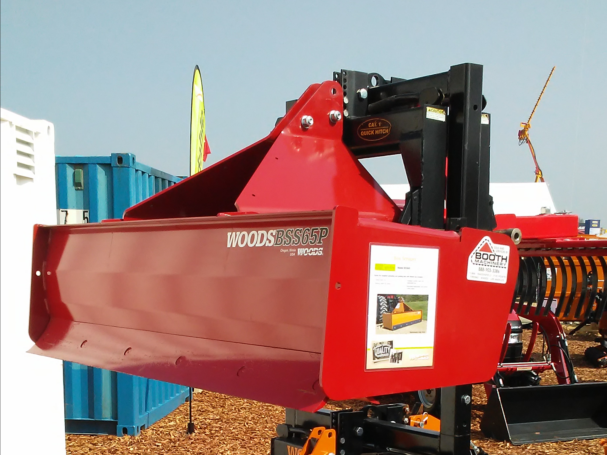

I was just at the WORLD AG EXPO today and had the opportunity to see many manufacturers of implements, and was very impressed with the quality of WOODS implements. There is something to say about a company that has been in business since 1946, and you can see that in the quality they put into their implements. Their reps explained how they have state of the art manufacturing were they hold their implements together with jigs so every implement comes out straight and square before they weld them, and they do extensive testing that smaller companies don't do. I obviously can not give you a review on a batwing cutter, but can tell you I will be buying woods implements from now on. Very impressesd with the quality of woods. Their box blade was so straight and square it put the one I bought to shame.
