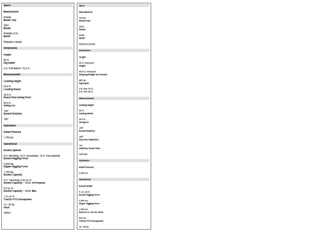

I agree with Luke's comment, that the new model should be more expensive than the older one. I attached an image of the specs of each model, showing the slight differences between each. I have the BH6000 on my B7510 with the 4 poimt hitch and it works great. So far it has done everything that I have asked, ditches, rock picking and cleaning out a drain. I would see if I could get a better deal on the BH6000 first, but if the difference is not better than at least a $1000, then I think opting for the new BH65 would make most sense.

Thanks! I notice the digging force is greater on the 65.
In the woods you tube video, other pics on Internet and the instruction manual, it looks like the 65 has its own seat. I thought the 6000 just had a swivel for the tractor seat.

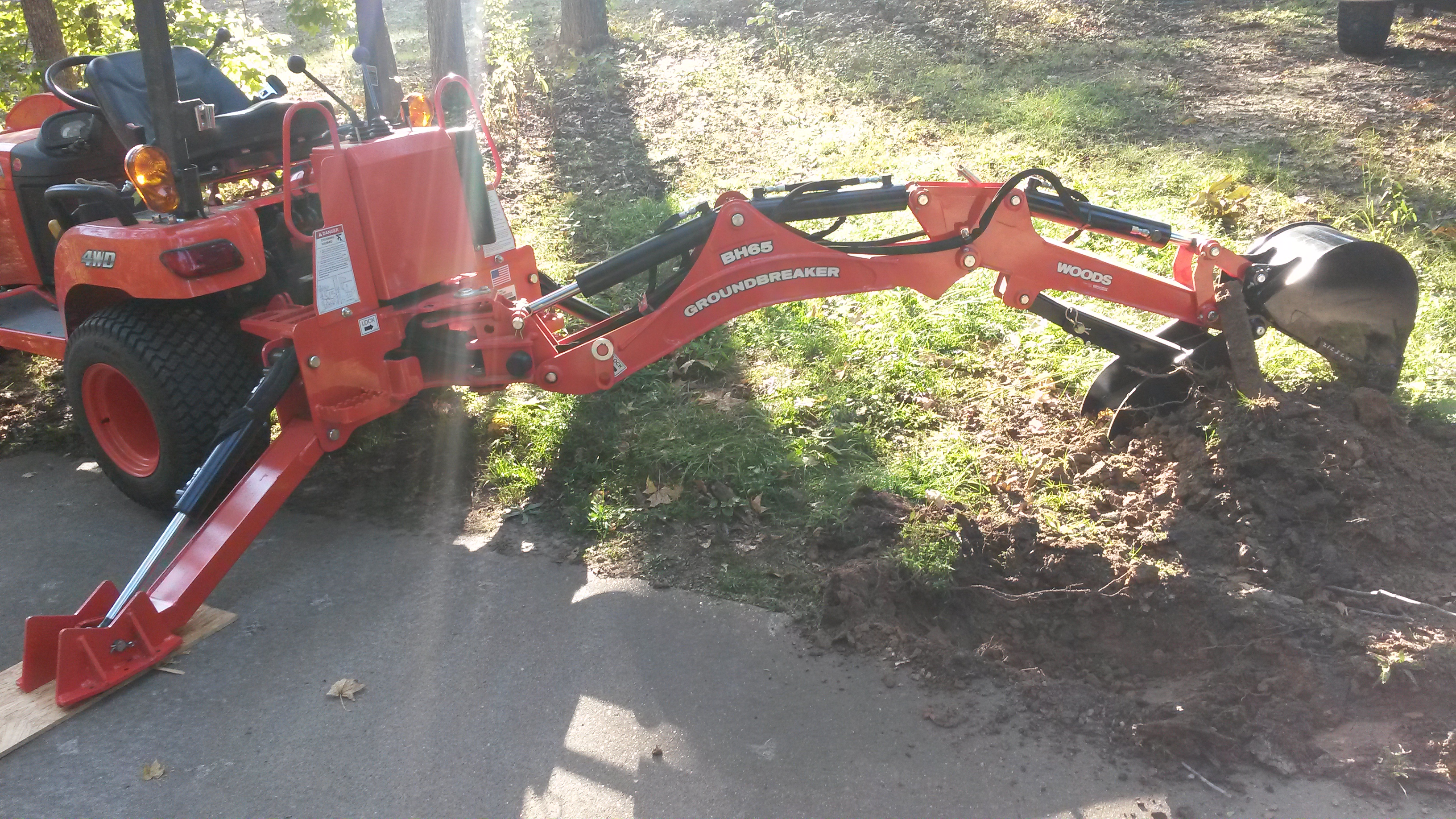

Works good, i am real sorry for the delayed response i just noticed this here. I'm not on top of my tractorbynet. I had a little trouble, the brackets they sent would not fit and a couple hoses were wrong. I had Al the tech rep at woods on speed dial (he probably does not like me now). I did it step by step as I had time since we were on a one week rotating shift with a lot of OT at work. So every time I hit a snag I called him and did it Johnny cash style (one piece at a time). It works good, as with everything on this tractor, power has not been a concern weight (lack of) is, the hoe will throw it around quite a bit.Anything else please ask I will be more than happy to help, I agonized over the decision because nobody could answer questions I had!1495777157514.jpg

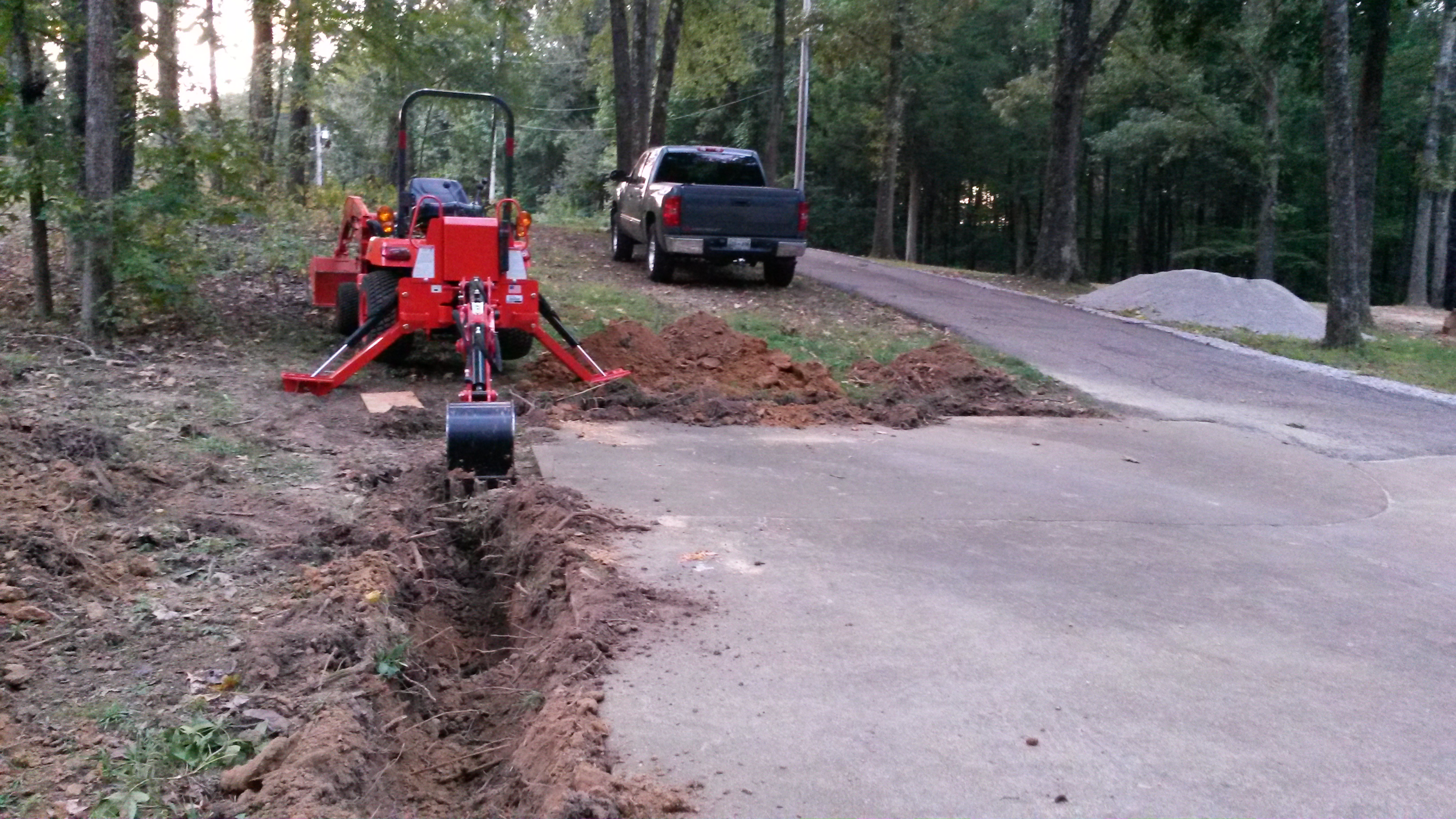

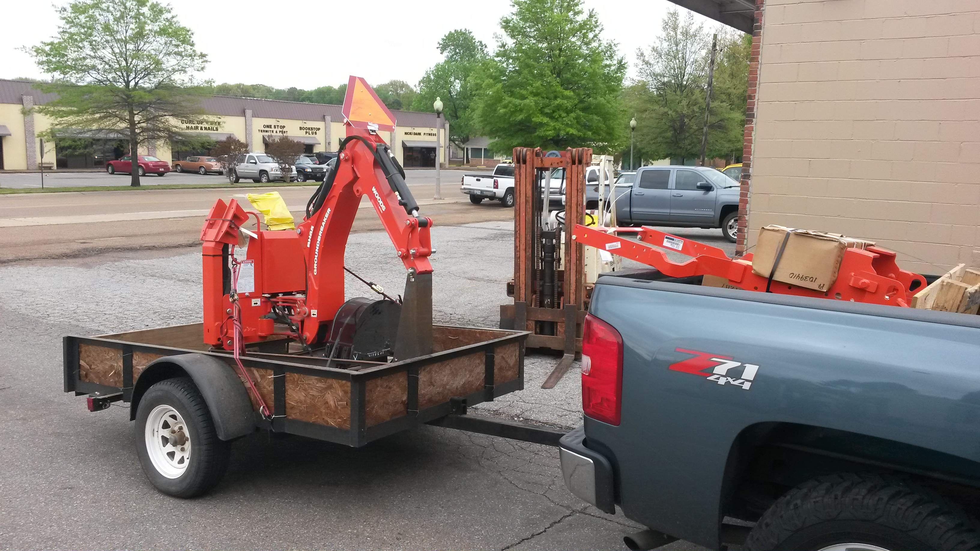

1495777605917.jpg1495777815504.jpgone shows a treasure I found about a foot under. I haven't started any of the projects I had planned for this backhoe yet. The digging pictured was a small one I invented to try it out.1495777769209.jpg
