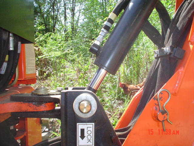

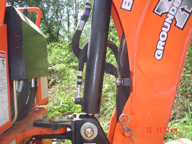

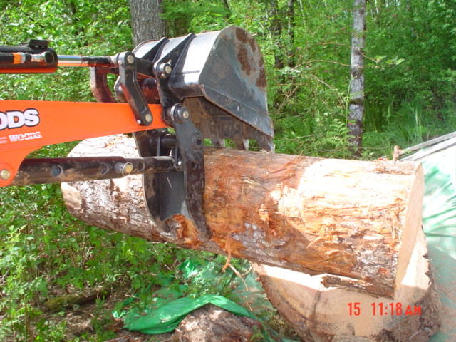

Hi to all that responded. Some of this is a bit over my head. I will have time on the weekend to really study your responses and try and do what you have suggested. Just in the middle of a building project today and tomorrow. I should have some more info for you no later than Sunday. :)
This is what I had sent to the dealer.
As suggested I warmed the tractor up to its normal operating temperature and then worked the left lever that controls the swing cylinders and main? hydraulic cylinder.
I extended the backhoe all the way out and up. Opened the thumb all the way and curled the bucket so it was pointing towards the tractor. Thumb and bucket parallel to the boom.
Measured from the ground to a point at the top of the bucket.
May 18th
10:10AM 83 1/8 inch
12:05PM 72 ½
3:55PM 56 1/2
7:00PM 45
9:30PM 38 ½
May 19th
6:00AM 19 ½ also bottom of bucket 5 ½ inches from the ground.
Pics are of the small log that dropped the bucket down about 1 - 1 1/2 feet in 22 minutes.
Regards,
George

I think the leakage is within tolerances too!!
It is a small cylinder 2.5" bore with a 1.25" rod....and the leakage volume is the difference between the capped volume and the rod volume...as I posted before....3.68 cui per inch of CYLINDER DRIFT...
Questions:
Under what pressure was the test??
What length of cylinder drift did your test represent??
I assume about 3/4 stroke, which would be about 12" (full stroke is 15.5")....
12 by 3.68=44cui or about 723cc....sound like it is a lot, but over 20 hrs or 1200 min, it is only 0.036 cui per min or 0.60 cc per min
your test with the log would accordingly be about 1" cylinder drift in 22 minutes, which is about 0.17 cui per min or 2.74 cc per min.....
These leakage volumes is combined leakage through spool valve, piston seal, work port valves etc....
so IMO,it is NOT VERY BIG NUMBERS if pressure have been some where nearby max system pressure!!!
The total leakage is added from all sources too...spool valve, piston seal, work port valves etc....
I do not think this leakage would have any noticeable effect on performance!!
