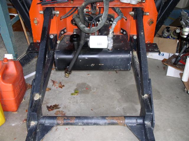

Design
/ Woods 9000 BH - multiple piston movements? #12
I can give you a Acad file of the subframe I built for my 9000. I had a 3PH mount and it worked fine but was starting to wear the top hitch pivot on the tractor and it also scraped the ground when backing from a trailer so I made the subframe with a 3" rise to it. I also made the subframe pin to the hoe so I could remove it for extended storage. Otherwise it takes up alot of floorspace.
