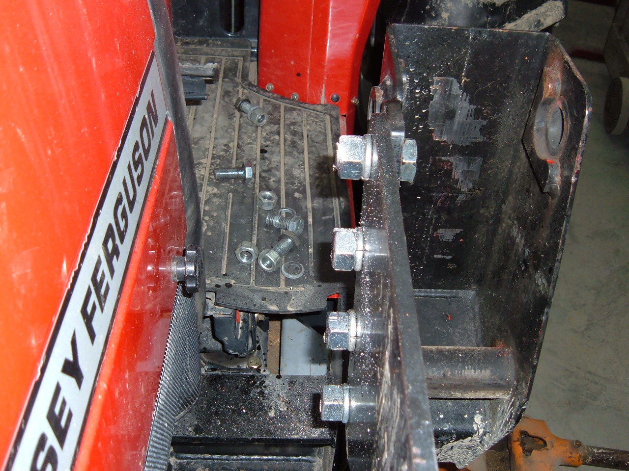

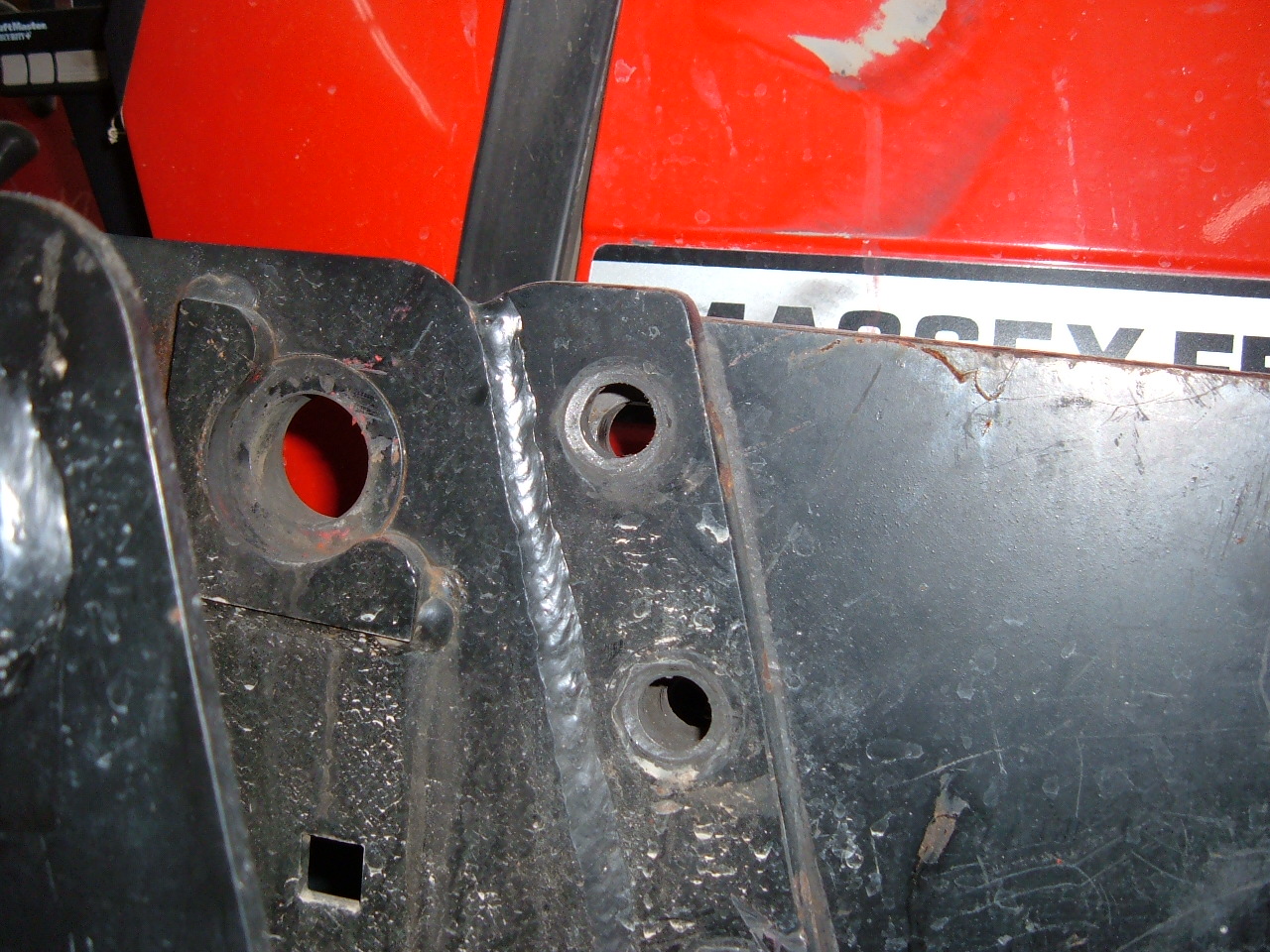

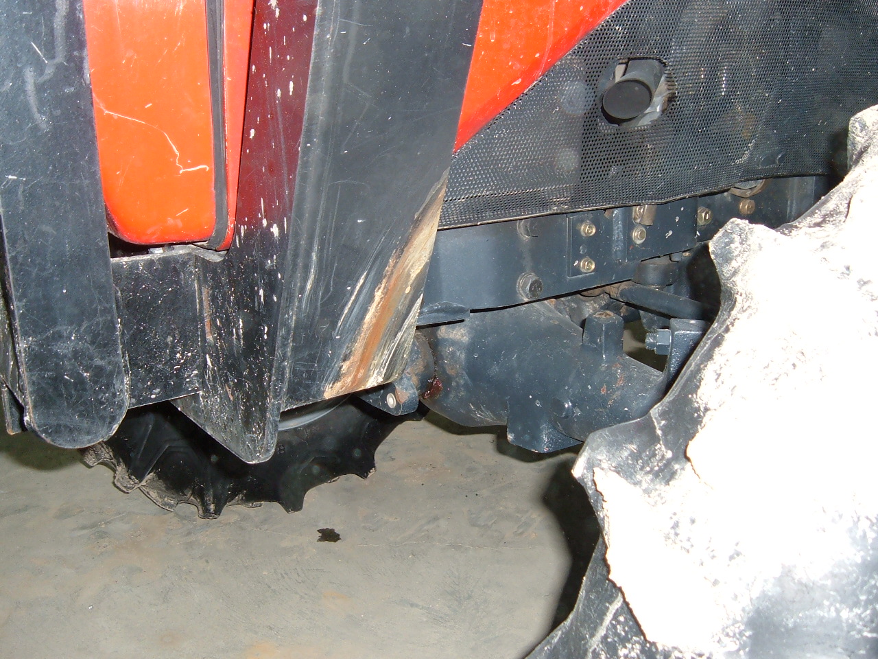

I have a massey 1260 with a woods 1012 FEL. Here lies the problem and possible solutions. The mount is mid and front with a top connecting plate.
Picture (1) will show the bolts that are always loosening themselves. The other line in the pic. shows the movement of the mount when lifting and putting down pressure.
I have thought about welding the plates together but, if for some reason Iwould have to work on the motor it would be nice to remove them.
Picture (2) shows where the monting brackets are breaking at the welds. These bracket are easy to remove and reweld. Who wants to do that more than once?
My thoughts are to add a subframe going to the back of the tractor to make a quike attach for my BH. I hope this would help reduce the wiggle in the FEL mount. See Picture (3)
I did make a removable one that comes off with the BH. My BH is a
Taylor-way 3PT mount. That setup works great but offers no support for the FEL mount.
If any one has had a simular problem I sure would like to know how you fixed yours.

I guess I am missing something. On picture two, the platform mount, where is the weight, force etc coming from that is breaking those welds?
One the first picture, the front mount, drill the bolt heads for safety wire.
/ Woods 1012 FEL mount problem
JerryG,
The platform mount is whats breaking. The bolts going forward hold the cross-over FEL support mount arms, that is where the load is coming from. I did think about drilling those bolt holes larger and put new bolts in with a tighter fit. perhaps that would remove some of the wiggle.
Phil
/ Woods 1012 FEL mount problem #4
Picture 1: I would drill and safety wire the bolt heads. That would take care of the bolts becoming loose. I have actually drilled the nuts and then through the bolts before. I assume that the nuts are welded on the back side.
Picture 2: That may be another problem if the welds have been being burnt in. Are you sure that the welds were burnt in good? If they were, try it again and then weld a a small plate across the weld. Ex. 1/4" x .75 x the length of the bracket. I don't like to do that, but I have.
As far as the rear axle support goes, I think that they all should have them. As more models of loaders have went to mid-mount, the more rear axle supports have showed up.

Thanks for the input. The nuts are not welded so should I weld them and then safety wire thru the nut? I set up a lazer line and took measurements to layout the new axel supports and rear quick mount for the BH.
Phil
/ Woods 1012 FEL mount problem #6
Since the nuts aren't welded, I think that I would weld them first. See if that works first. If it doesn't, then I would drill the bolt heads.
/ Woods 1012 FEL mount problem #7
First, and most obvious, have you tried locktite on the bolts? Second, and more to the point. If that bracket is moving, the bolt holes are too big or the torque on the bolts is not high enough. Personally, I'd replace the bolts with new grade 8 shouldered bolts in redrilled/reamed holes to get as tight a fit as possible, and use locktite on them. While I had the chance, I'd disassemble the joints and make absolutely certain that it was absolutely clean; no washers, dirt, oil, etc. Next, I'd run about a 1" bead on the top and bottom of the joint. (blue on the pic) The bolts should be enough to effectively fuse the two pieces, but obviously they aren't so adding a bit of weld at the highest stress locations should add to the rigidity greatly. If you ever need to disassemble it, the weld beads would be easy enough to cut.
To understand the fix, you have to understand the failure. The bolts are loosening because the metal is moving, not the other way around. If you stop the bolts loosening without stopping the metal moving, all you'll do is gall the metal. The bolts shouldn't be used to locate the two pieces together, that's the job of dowels and pins. The bolts are supposed to provide enough clamping force between the two metals that the friction should stop the movement, but for some reason they aren't. Welding won't increase that friction, but will physically fuse the metal together preventing the movement. You're not trying to replace the bolts with the strength of the weld, you're trying to supplement the friction they provide. The failure of the bottom welds is due to the flex they get from the mount above them moving. Eliminate that movement, the bottom welds no longer get flexed. (not to say they don't need to be rewelded, just that unless you stop the flex above they'll keep breaking)

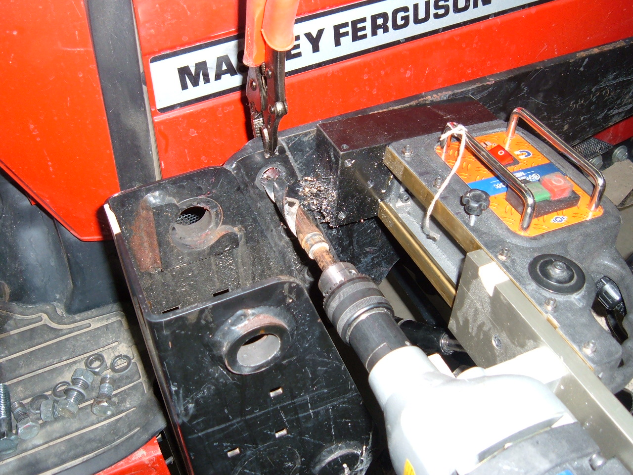

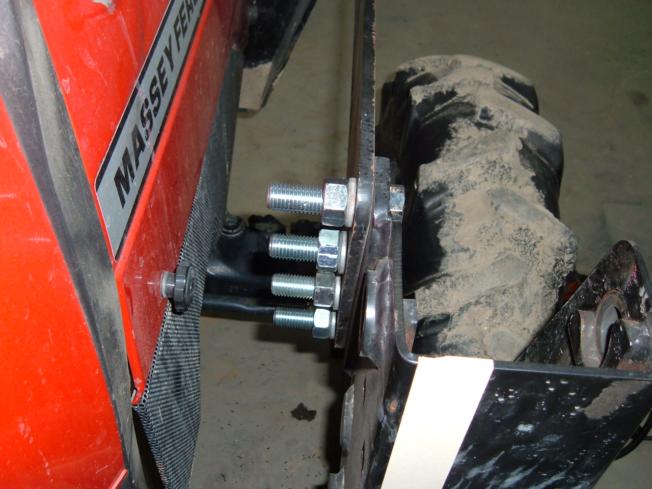

Okay, I have changed the bolts. Documenting the prosses is new to me so here goes.
(Pic 1) bolts removed and measured. The holes are .700" The bolts were .610 because there was no shoulder. Only one bolt looked like it was crushed and the holes were not elongated. (Pic 2 )Next was to setup the mag drill, that was a pain because once you turn on the base it dosen't move. So I made a template to clamp to the steel and this gave me the position to be centered on the exsiting hole. Drilling was a piece of cake. (Pic 3) Drill hole, insert and tighted the new shouldered .750 bolts and repete. Project time about 1 Hr (Pic 4) I cut off the xtra bolt past the nut. My fel hoses are in this space on the right side. (Pic 5) the second reason that I don't like the front brace when turning the tires rub. This is no longer a problem because the preveous owner just chewed the tire instead of adjusting the turn stops . The setup is all tight and seems to be okay. I will continue to post the process of the sub frame to the back of the tractor.

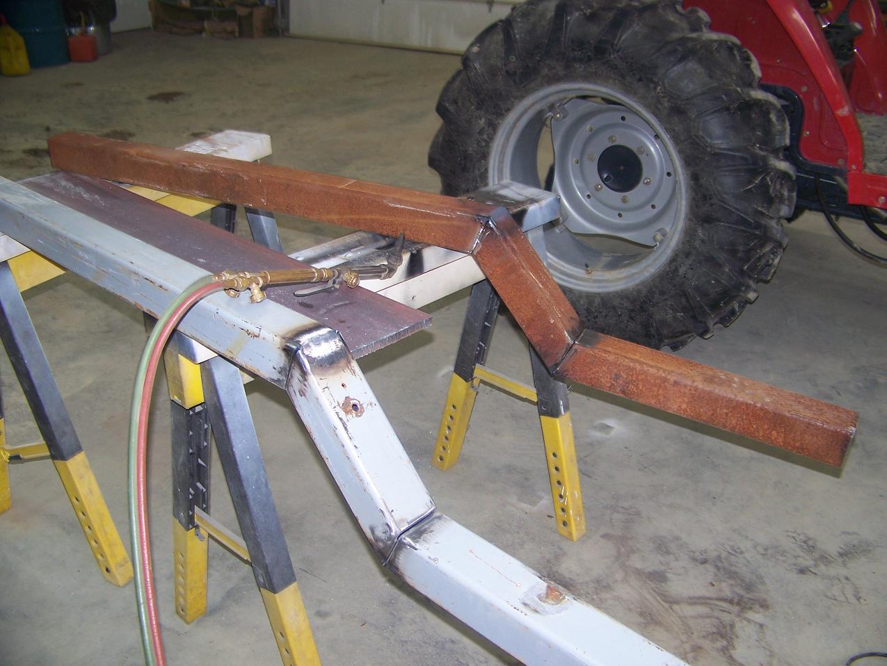

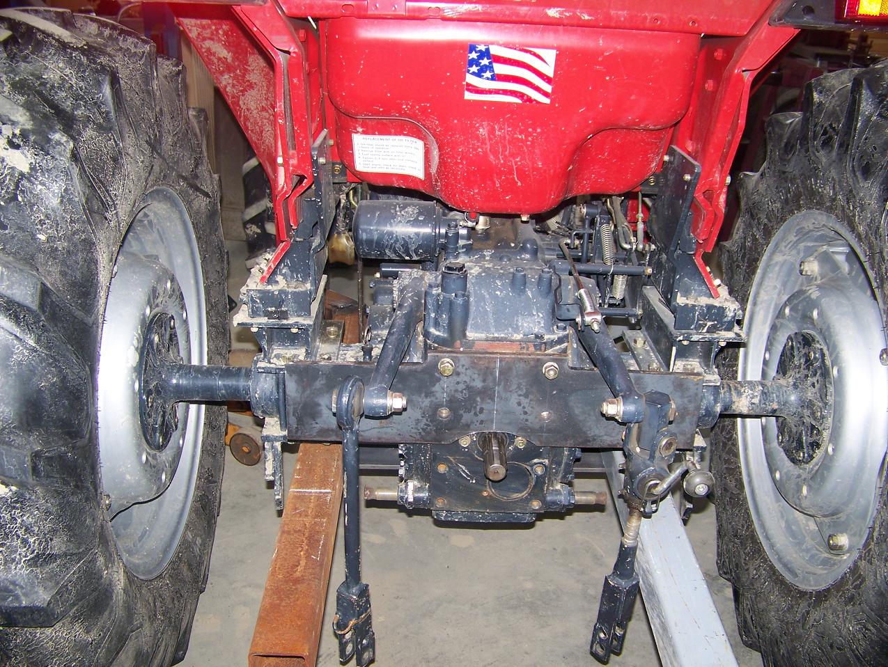

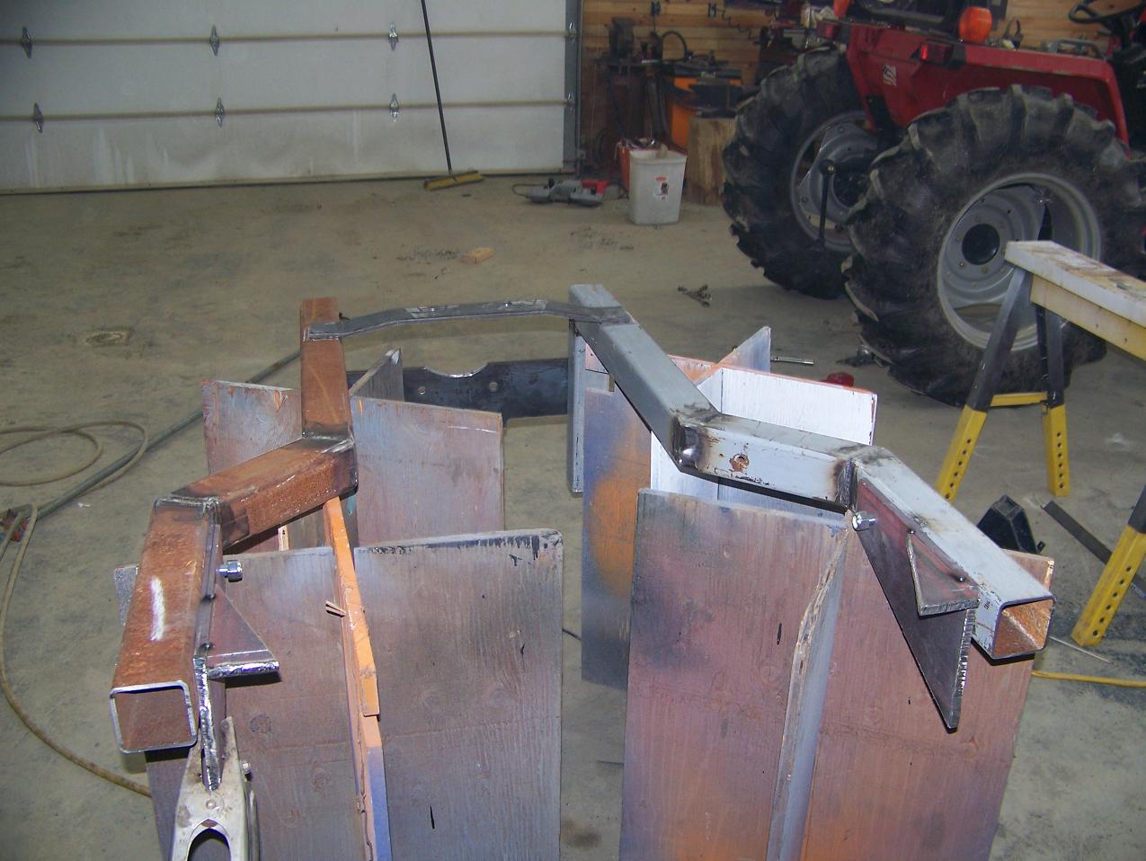

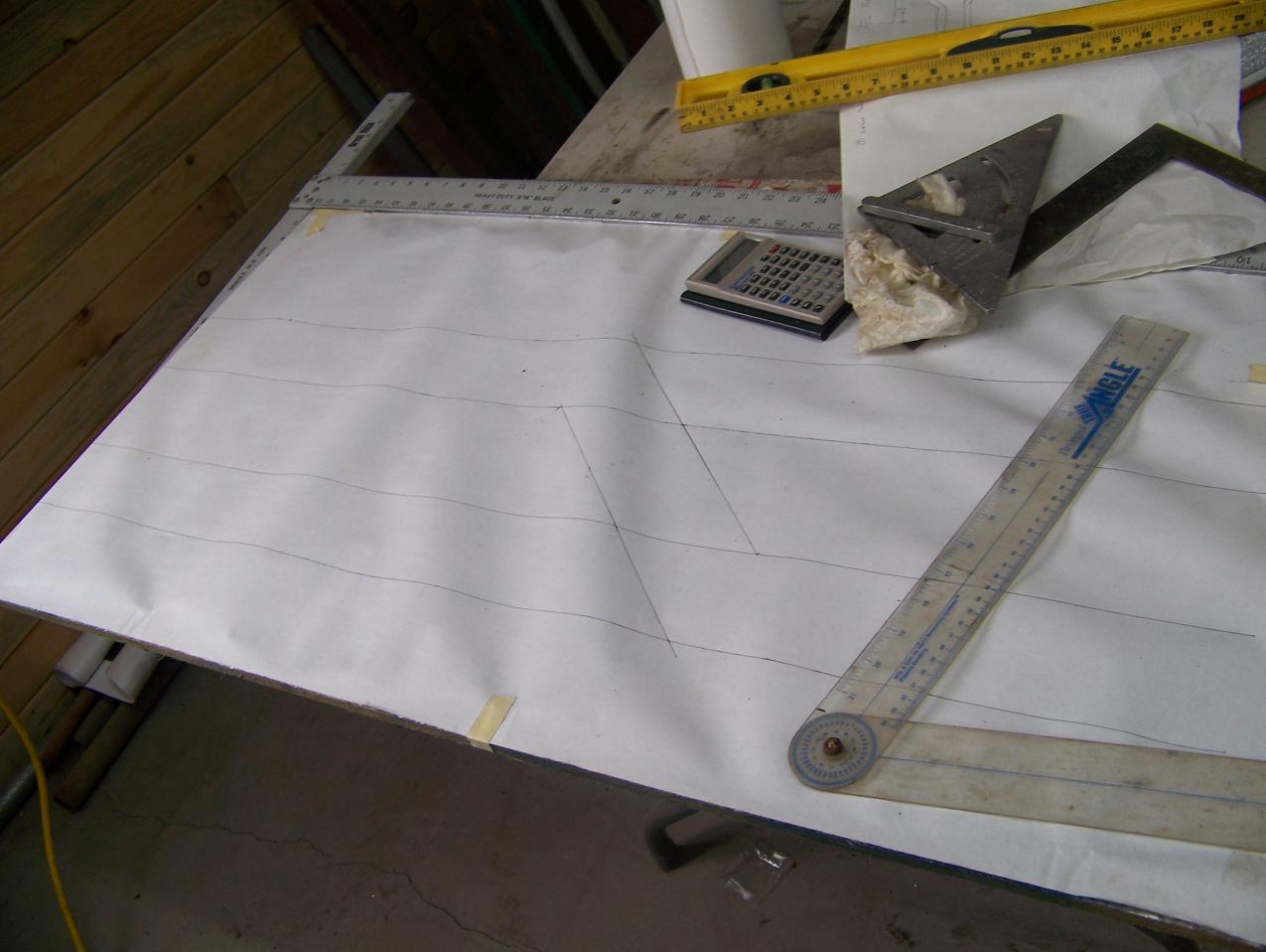

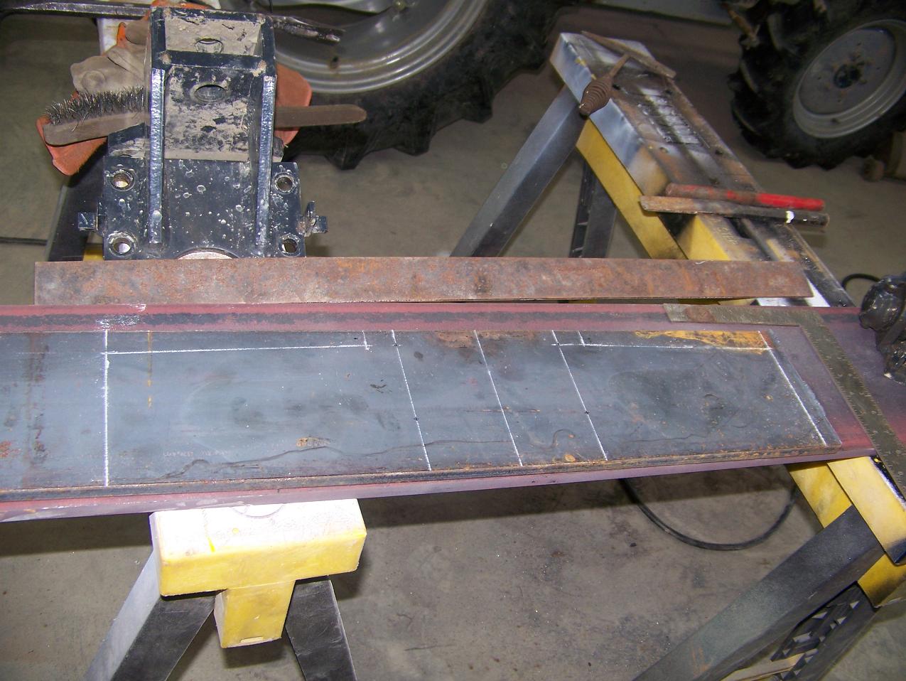

I started on the subframe today. First pic Lazer measurement from back to front fel frame.( I turned out the light so you could see the line) This gave me an offset of 4-3/4" so I did the layout full size on paper(pic 2) then to the 3" sq tube.
I used my portaband to cut the tubes then the torch to heat and bend the back side.(pic3) This method left a gap of about 1/8" so no bevel was needed to weld.
The last pic show the back of the tractor with the frames sticking out long for more measurements. My goal is to have the new subframe stay on the tractor and not take away from the current ground clearence.
Technical Question
Can I move the top link assembly back 1/2"? I would like to put a 1/2" thick cross the back support plate sandwiched between toplink plat and trans.

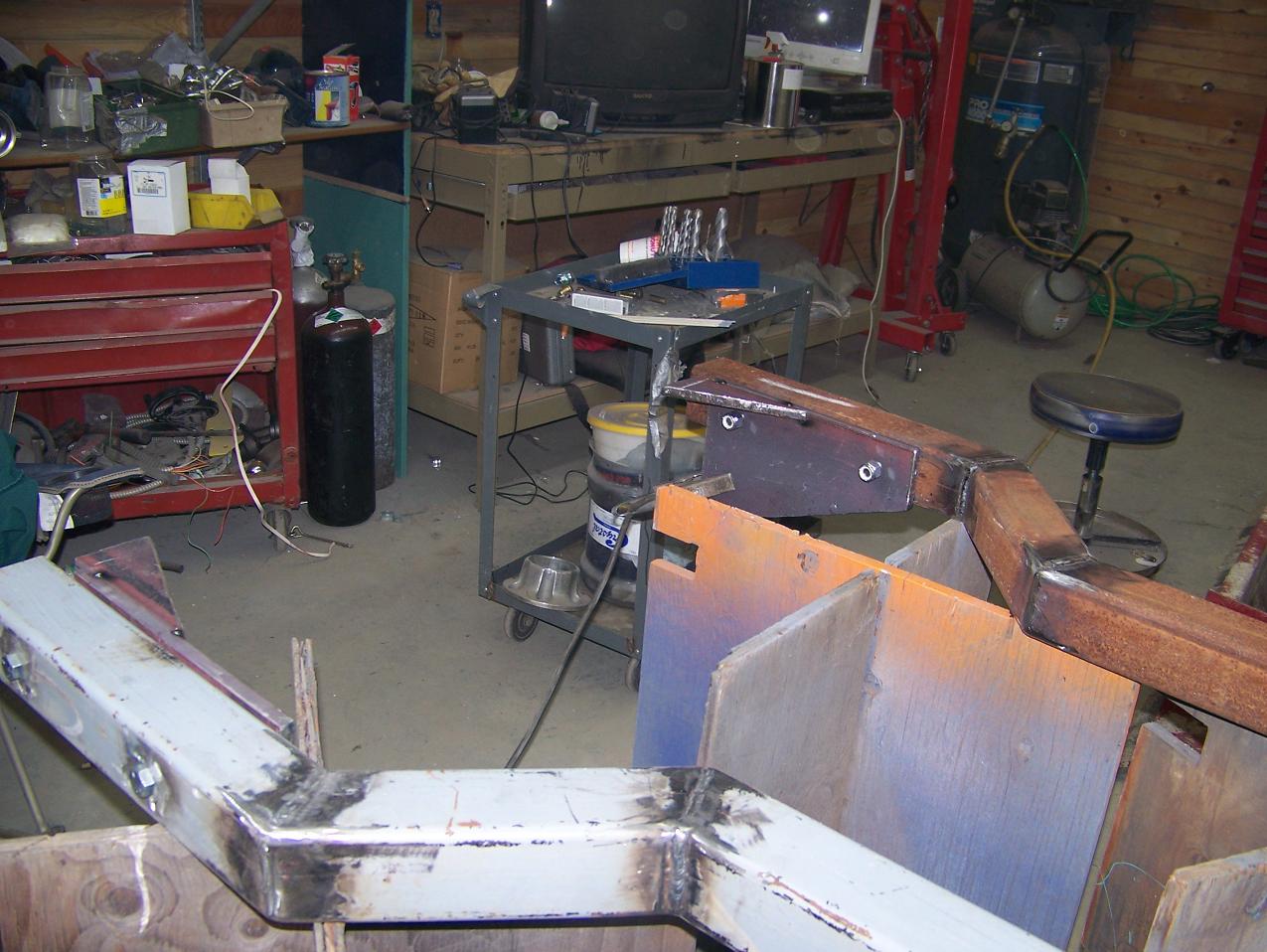

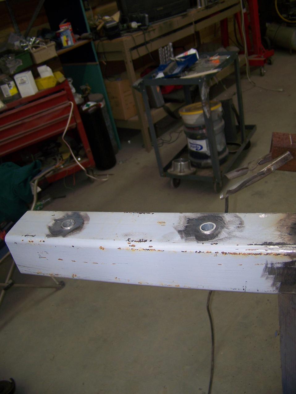

Okay today brought more progress.
I started with the back support bracket it will be located behind the top link assembly. a few obstical to avoid. I lowered the 3pt lift arms now i know that the bracket won't be in the way. Also had to notch the bottom of the plate to clear pto output shaft.
Next was to fab the Fel attachment gussets that I will weld to the arm support.
Bottom bracket to bolt subframe under the back axle.
Drilled subframe rails and added compression sleves to bolt frame to the new fel support gussets.
tack welded all parts to check fit.
I will have to assemble onto the tractor to dry fit and do a more solid tack weld to remove it and do the final welds.

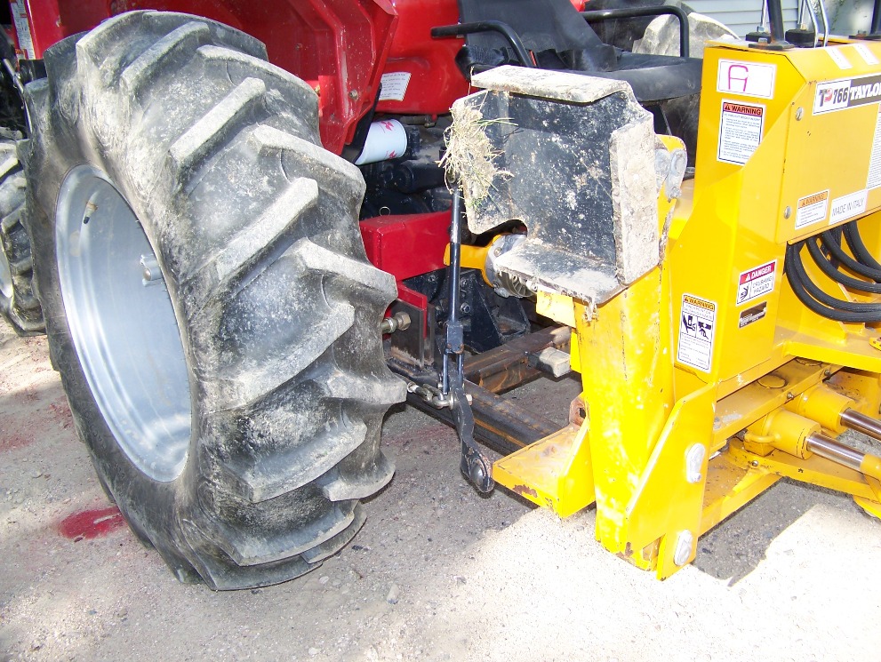

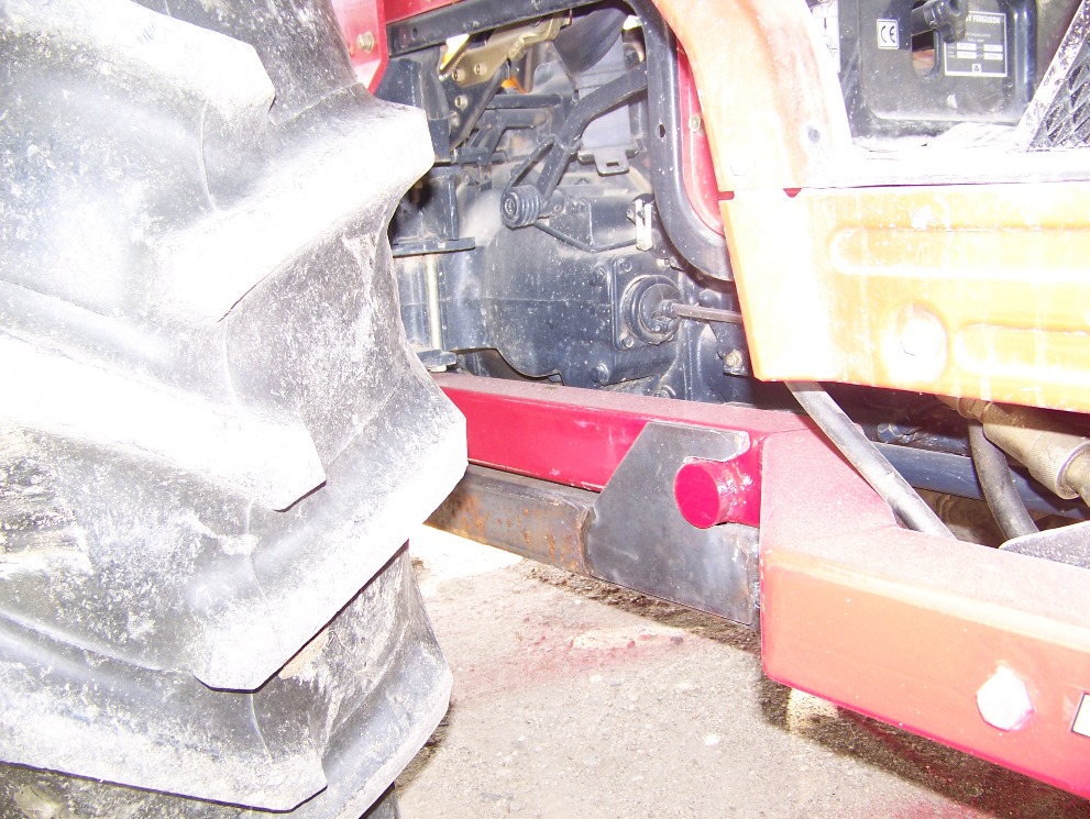

Sorry but I stopped taking pics of the proccess. the job is now complete and works great. here are a few more completion pics.
The subframe getting painted
The frame on the tractor
The BH mounted to it's new frame and attached to the subframe.
The design allows me to leave the 3pt arms inplace. Also I acheaved my clearence goal I only lost 1.5"
