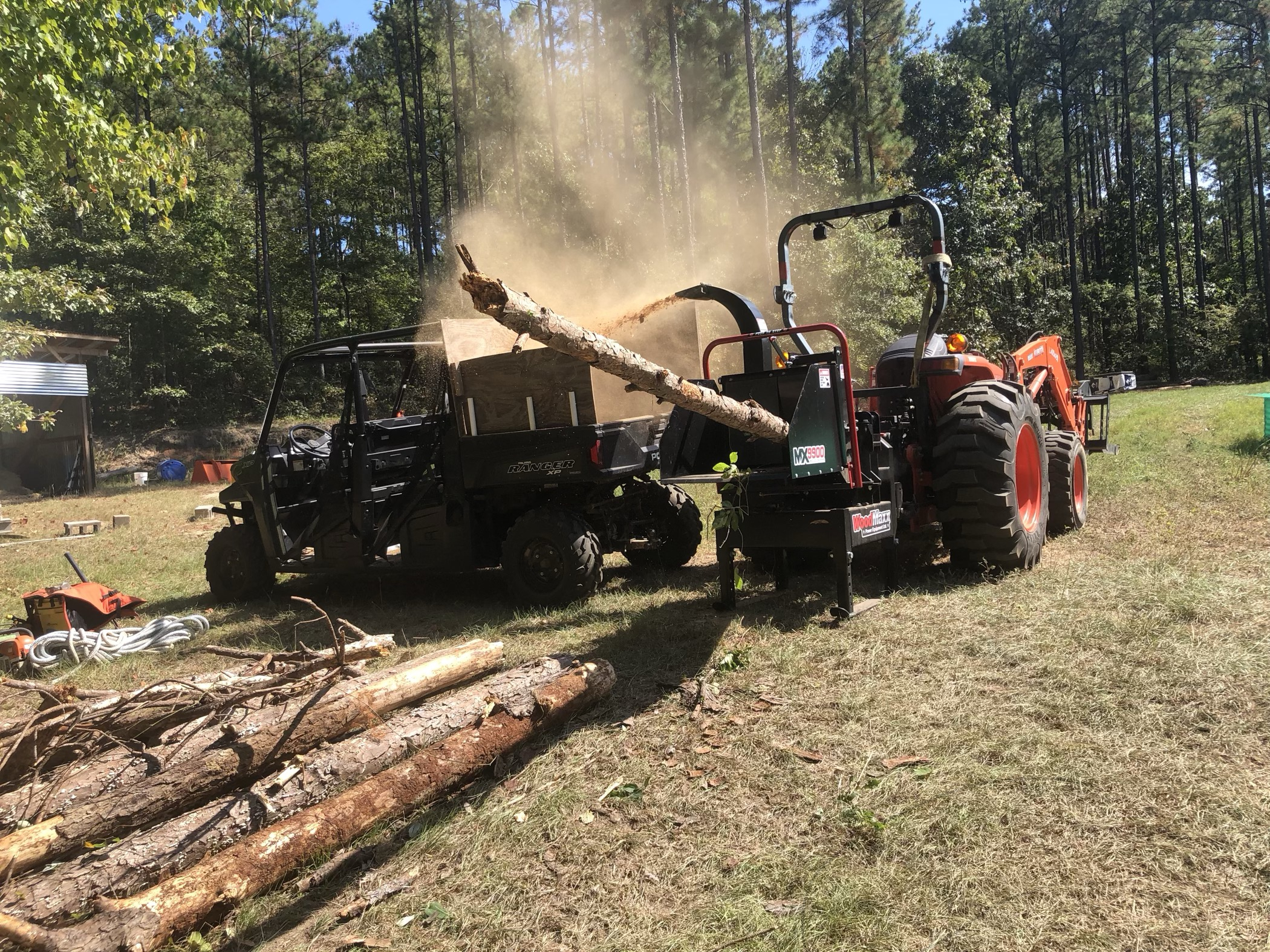

I have the MX8800. Absolutely love the thing.
