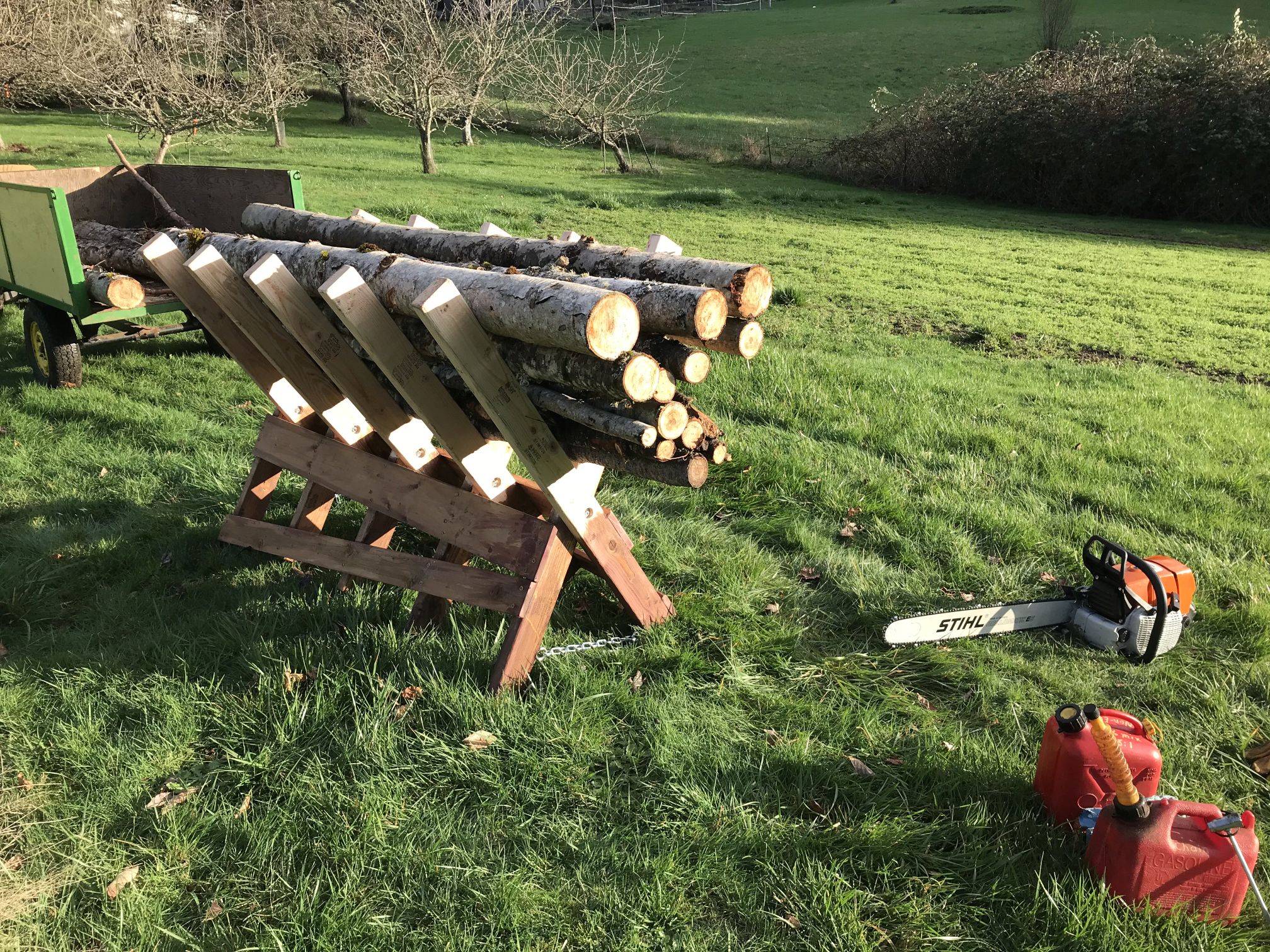

Looks like Branson 2515h also has a pretty good rear lifting capacity and it should be a good fit as long as you are not trying to chip firewood size branches!
I suppose firewood size depends on availability and the stove type, but for me Douglas Fir branches over about 2 - 2.5 inches are worth saving for firewood.
Plenty of energy when seasoned couple of years and good for starting a fire.
Please keep us posted on how it works out for you.
Cheers
PS.
Sorry little off the subject, but here is how I cut the small stuff to proper length:
