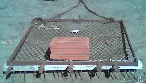

You might want to think about other materials. I made mine using a section of chain link fencing with a log secured at the back end. A length of angle iron at the front is fed thro the chain links and wire tied then hung from the draw bar with chains.
When not being used it rolls up for easy storage.

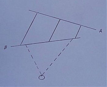

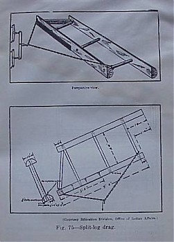

What you need is called a split log drag. It works to level humps because of being built and pulled on the bias like a road maintainer blade.
If built like one pictured, a dumped pile of dirt can be leveled by adjusting the angle of draft and either point A or point B hooked into the edge of the pile. It's actually pretty fast as there is very little lost motion as can be the case with other equipment.

Maybar,The split log drag has some intriguing value. I may incorporate elements of this type drag with the rake. Appreciate the pictures. Do you have any personal experience using this type of drag?
/ Wooden drag harrow #9
No, I don't have any experience using either of the drags pictured. The one picture where horses were used to pull was in the early 1900s and from an old book I have. That was just a few years before my time.
The other pic with the "A" and "B" is my concept of how I would build one if I needed a good one for leveling. The shear cutting action will to a great extent eliminate the roller coaster effect.

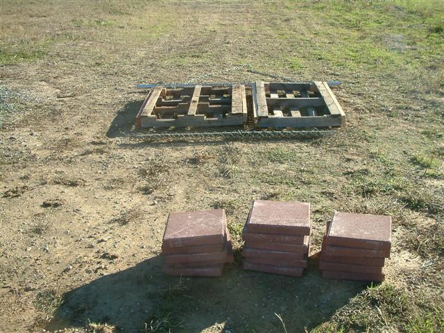

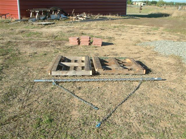

Here's what I use to bust up the clods after discing my 6 acre hayfield--a piece of chain link fence, two pieces of fence post, a couple of beat up pallets and a bunch of pavers (20 lb each)

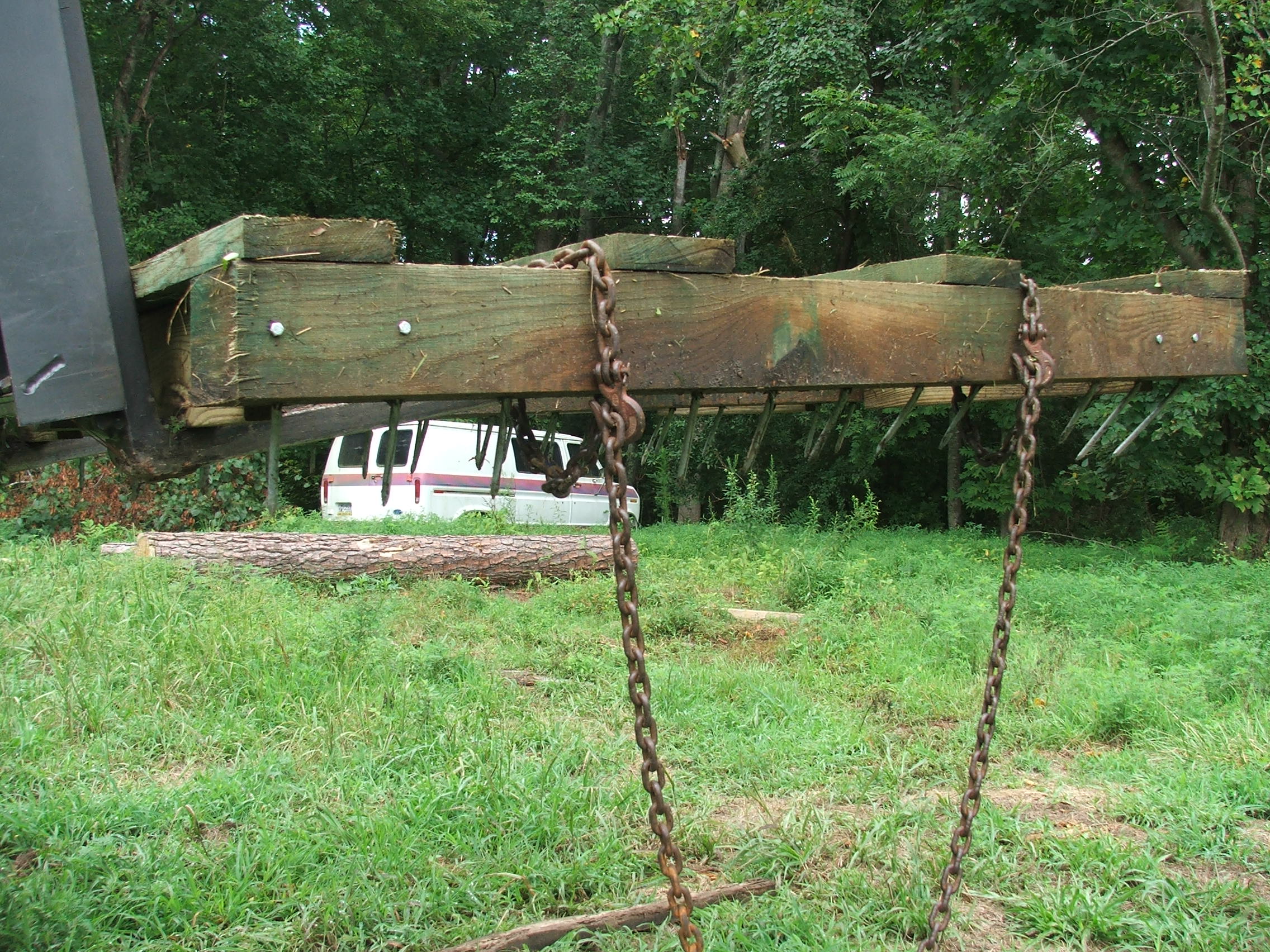

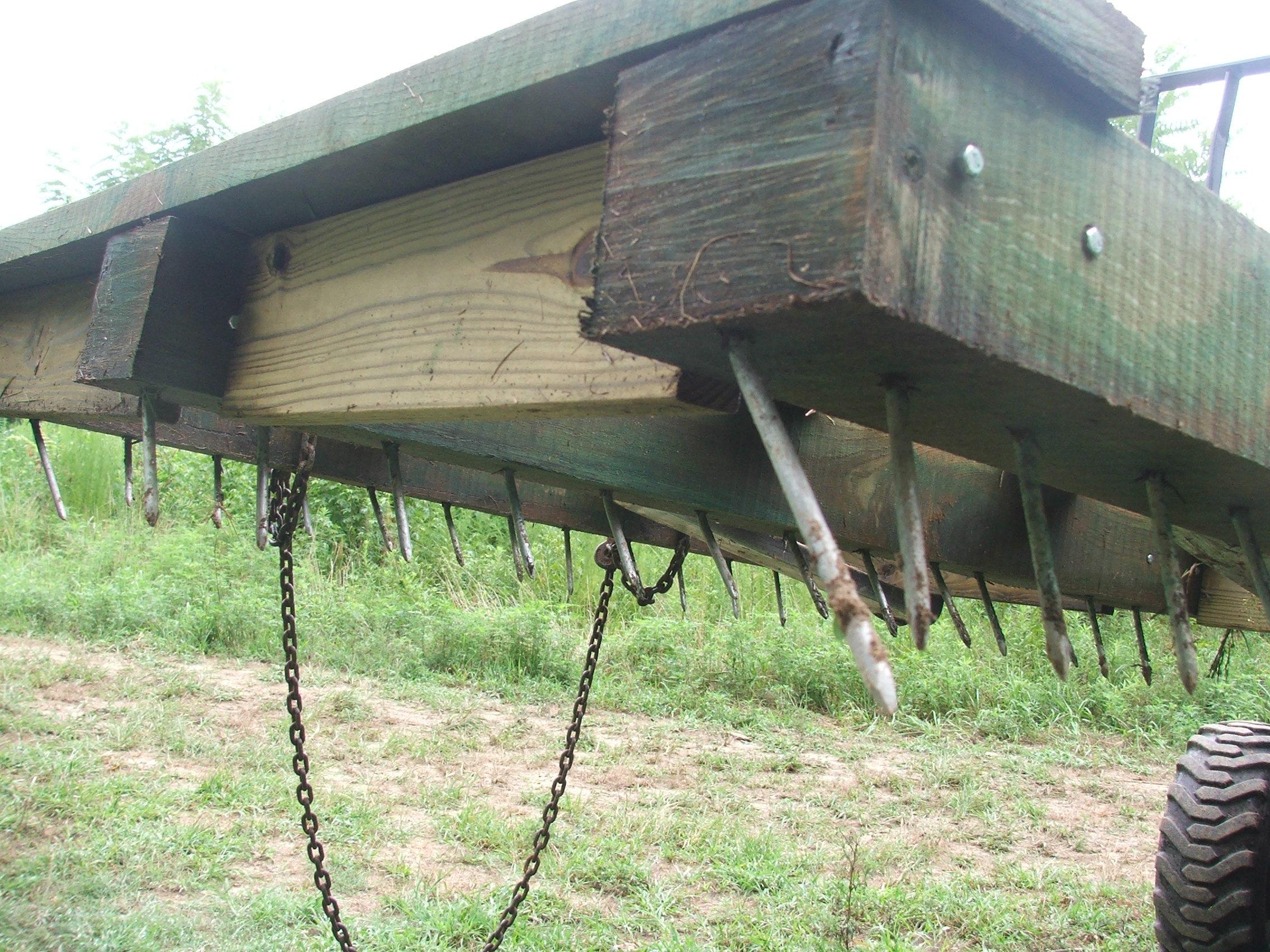

Built my wooden drag and tested it in my field for about twenty minutes yesterday. Did not have a disced field to drag so my real test will be in early Sept when I disc our club rugby field and drag with my homemade harrow. As you can see from the pictures,the drag looks like a big pallet. 5x5 Oak timbers held together by 6/4 oak boards. Sealed the wood with a preservative. The timber nails did bend some,so I am not confident the nails will hold up after long use but I expect to use this drag only a couple of times a year. If the nails completly bend up against the timbers, I think I will replace with rebar. Any opinions on that?
Unless you can find some 3/4" rebar I'd try something more like a railroad spike. I think the smaller diameter rebar will just bend up on you same as the timber nails did. 3/4" OD gas pipe cut 45 degrees on the end might work nicely, too - the only metal working skills you would need are using a hacksaw. You could secure them to your drag by drilling blind holes into your timbers.

The longer the spikes, the easier they will bend. If you go with rebar I think you'll have to use spikes that extend about half that length.

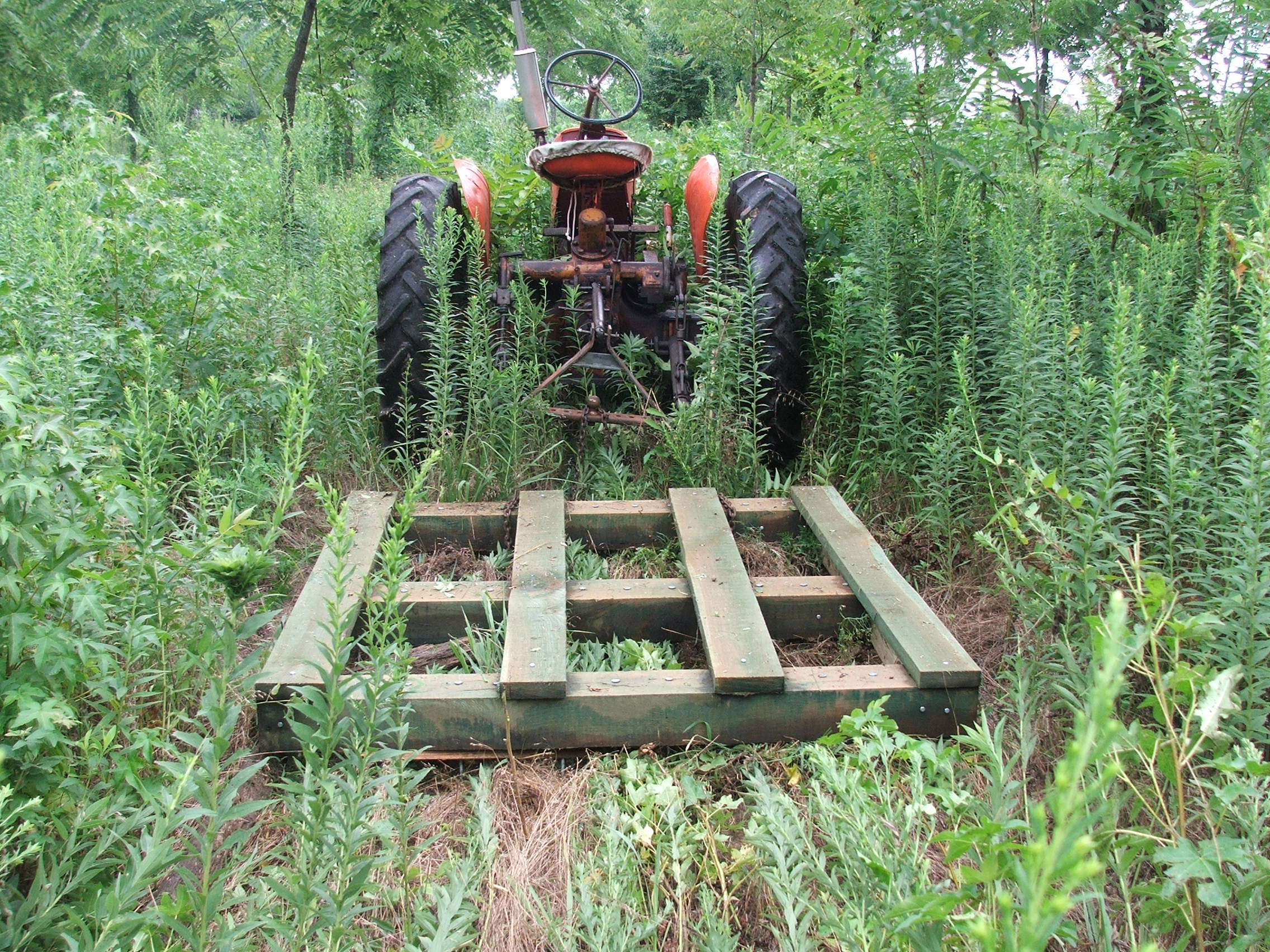

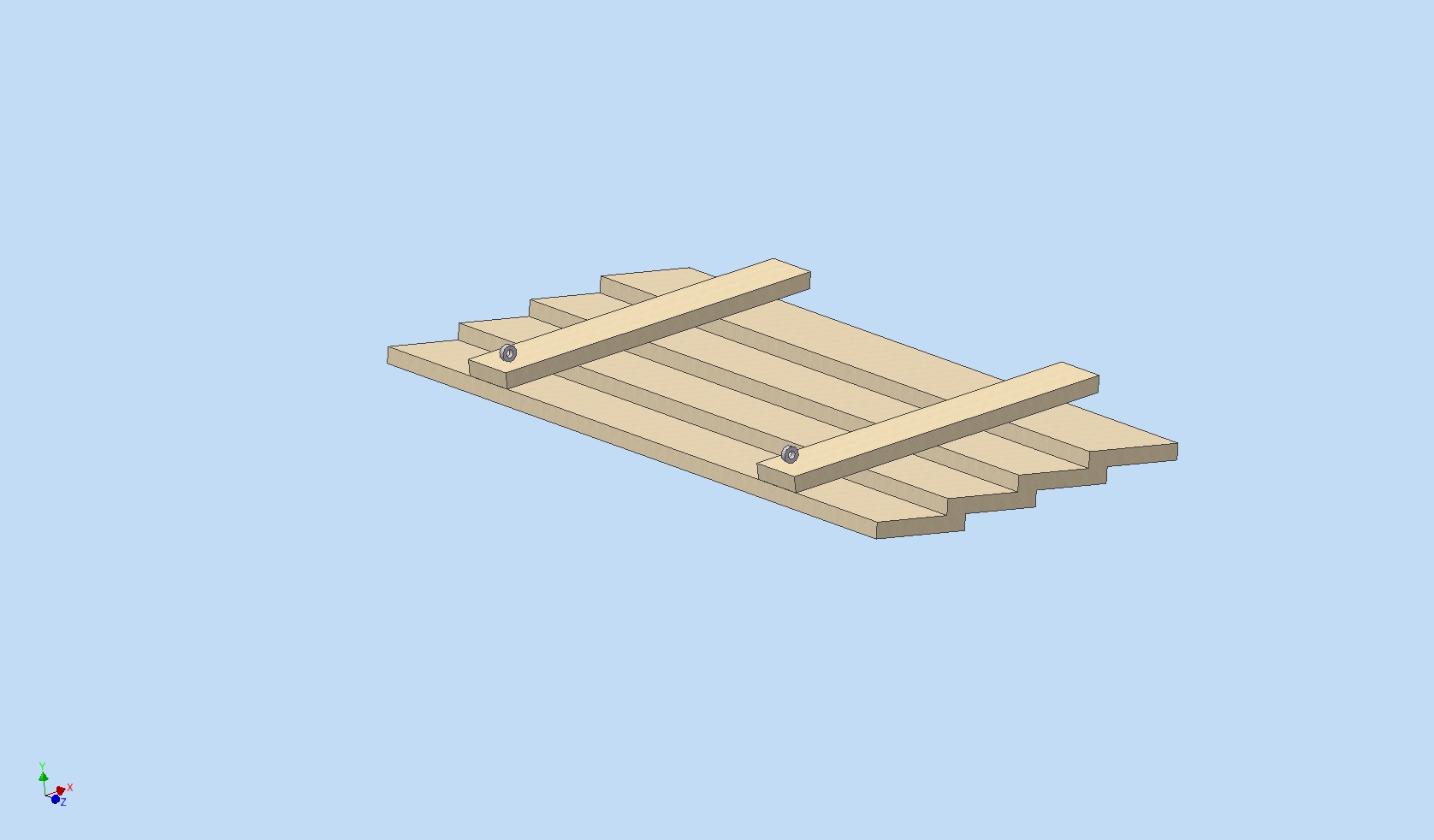

I drag a wooden "float" behind my disk for finish work. It's made from 2x10s or 2x8s. I usually end up throwing some big rocks on it near the back. It works great and leaves it real flat. No protuding spike needed. I couple eye bolts bolted thru the front can be used for attaching it with chains.

Thank you fellas for the comments.Time and some experience will finish this story. I do like G.Pooba's drag with the lapped boards. One could set the drag on its side for storage and it would shed water quite nicely. I will follow up on this thread after I drag the rugby pitch in sept.
