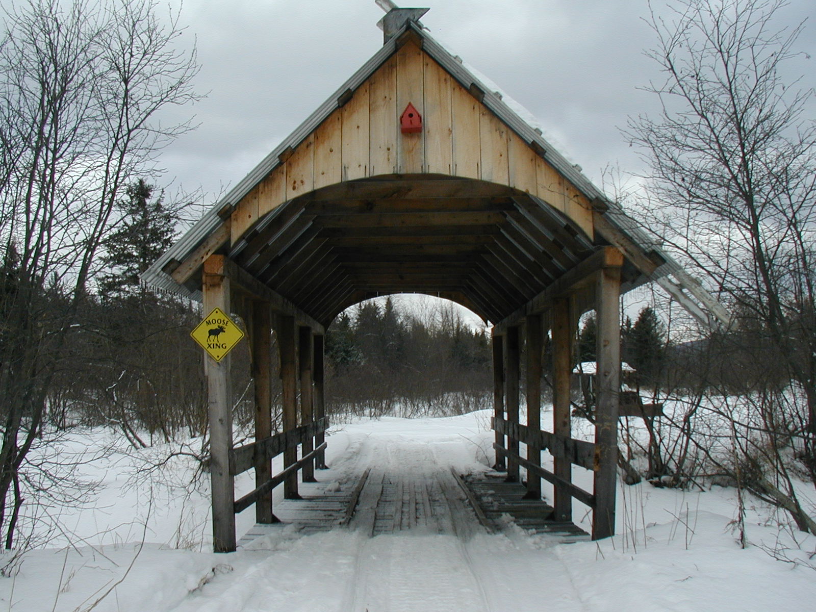

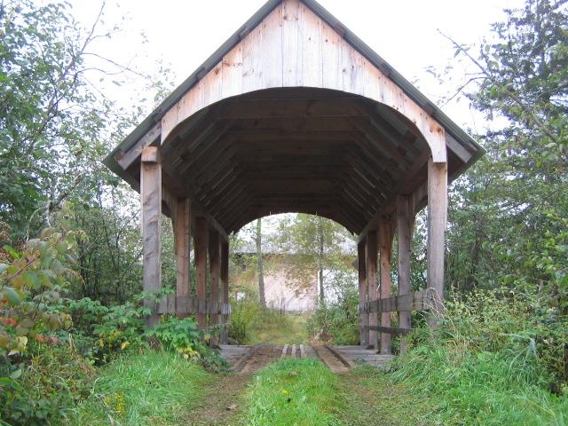

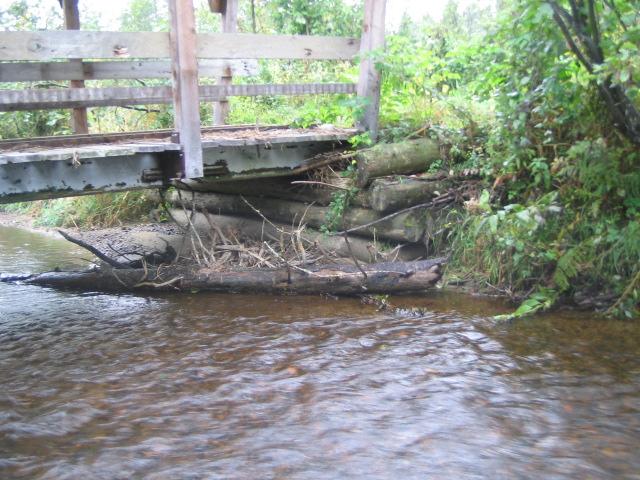

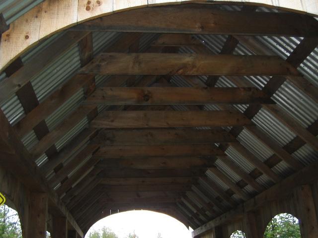

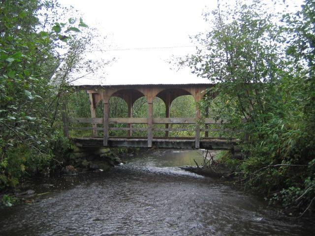

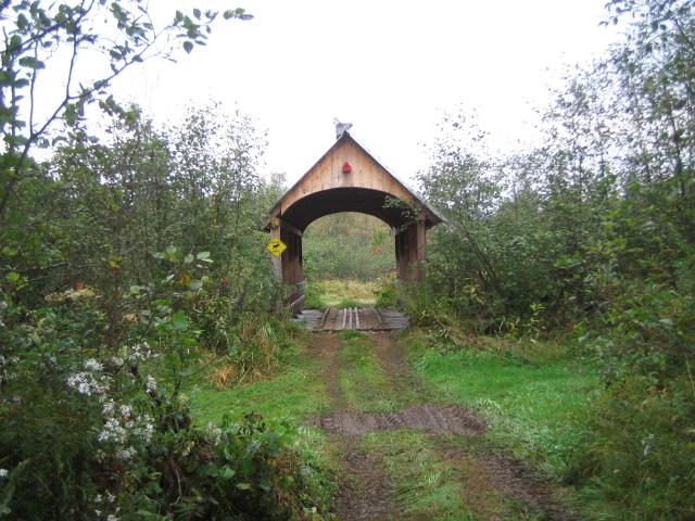

RobA, I suggested Rainbow Bridges because you seemed committed to all wood. I did this bridge a few years ago for less than $1000 materials cost. Was spec'd to a 8000 lb rolling load. Span is 24', 4 beams 14"x 26'. 2x10 rough hemlock plank deck. The lengthwise strips are to keep snowmobile carbide runners from sawing thru the deck. MikeD74T

VERY NICE!! Beautiful bridge. $1000? I'll take 2!!
I do like the look of wooden bridges. Funny thing is I asked my wife a few days ago about a covered bridge and she said she liked them. I'll have to show her your pictures.

Beautiful bridge Mike. Is it covered because of snow and stuff to make it safer, or just for the beauty of it?
