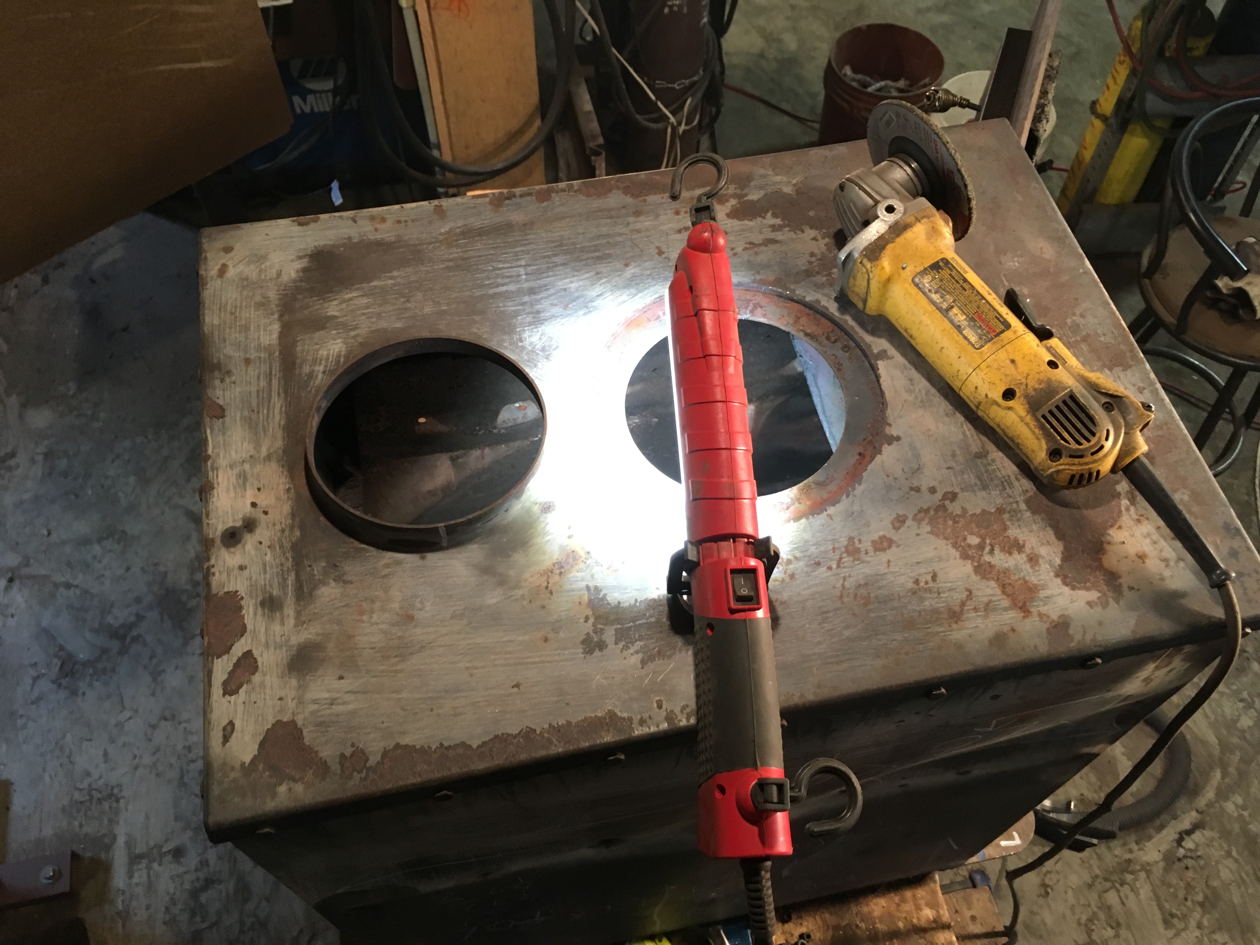

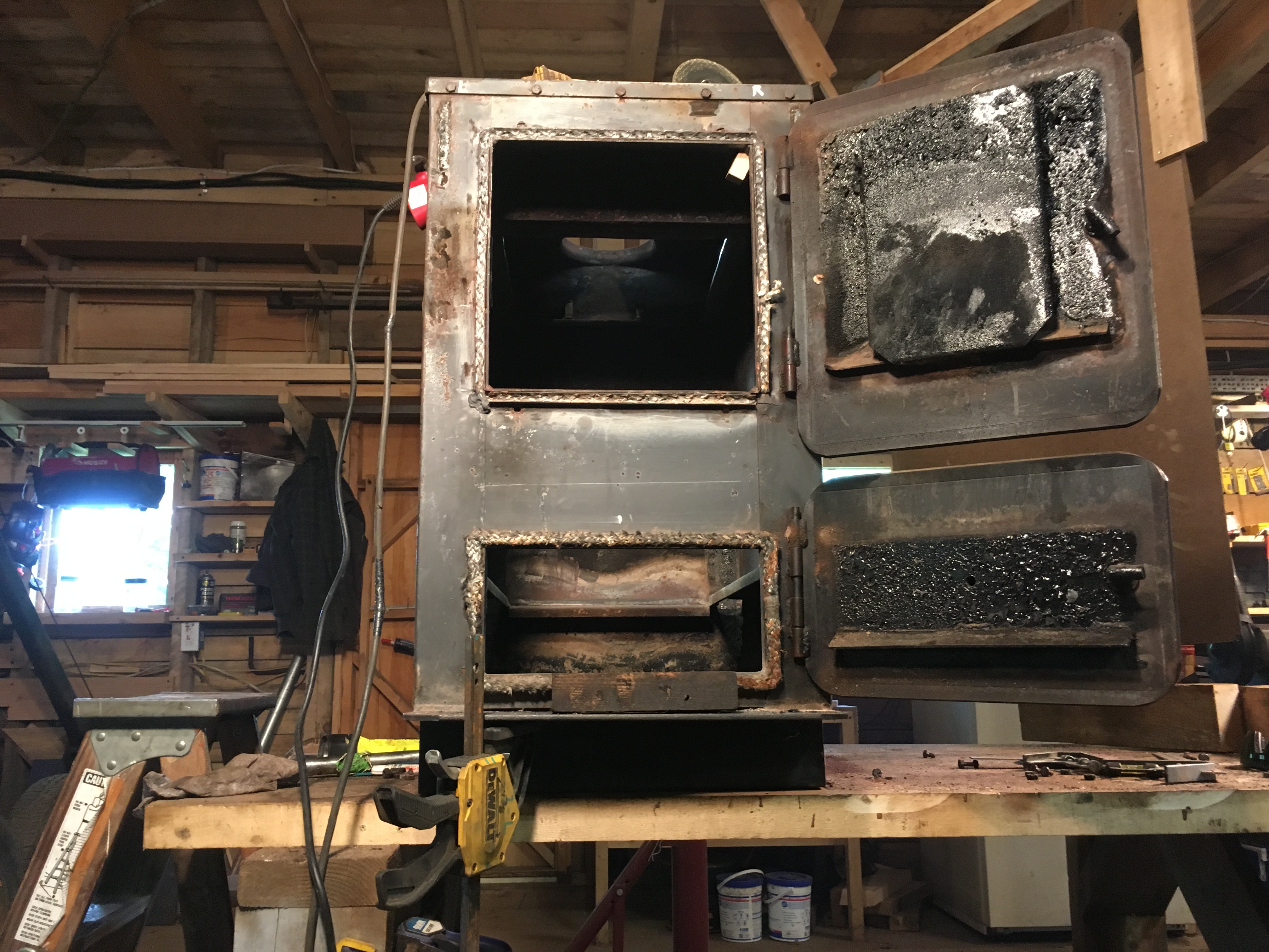

I found it to be tooo hot to cut firewood, almost to hot to mess with firewood stove but has to be done. After two seasons on this used Shenandoah heater it's in need of replating, 16 gauge steel is to thin to start with IMO, wood stove should be atleast 1/8" thick so I'll get some 1/4" sheet steel and add it to the outside, also try to straighten out the door opening a little then add a new thicker baffle to the inside, cut the old one out and my torch and I didn't like it, popping spitting, wood stove steel dont cut good.
I have a new grate in on the bench in waiting, I'll also need some new rope gasket and firebrick, time I get done this stove is going to gain some weight, maybe to much for my small ATV trailer, which is how I loaded it out.

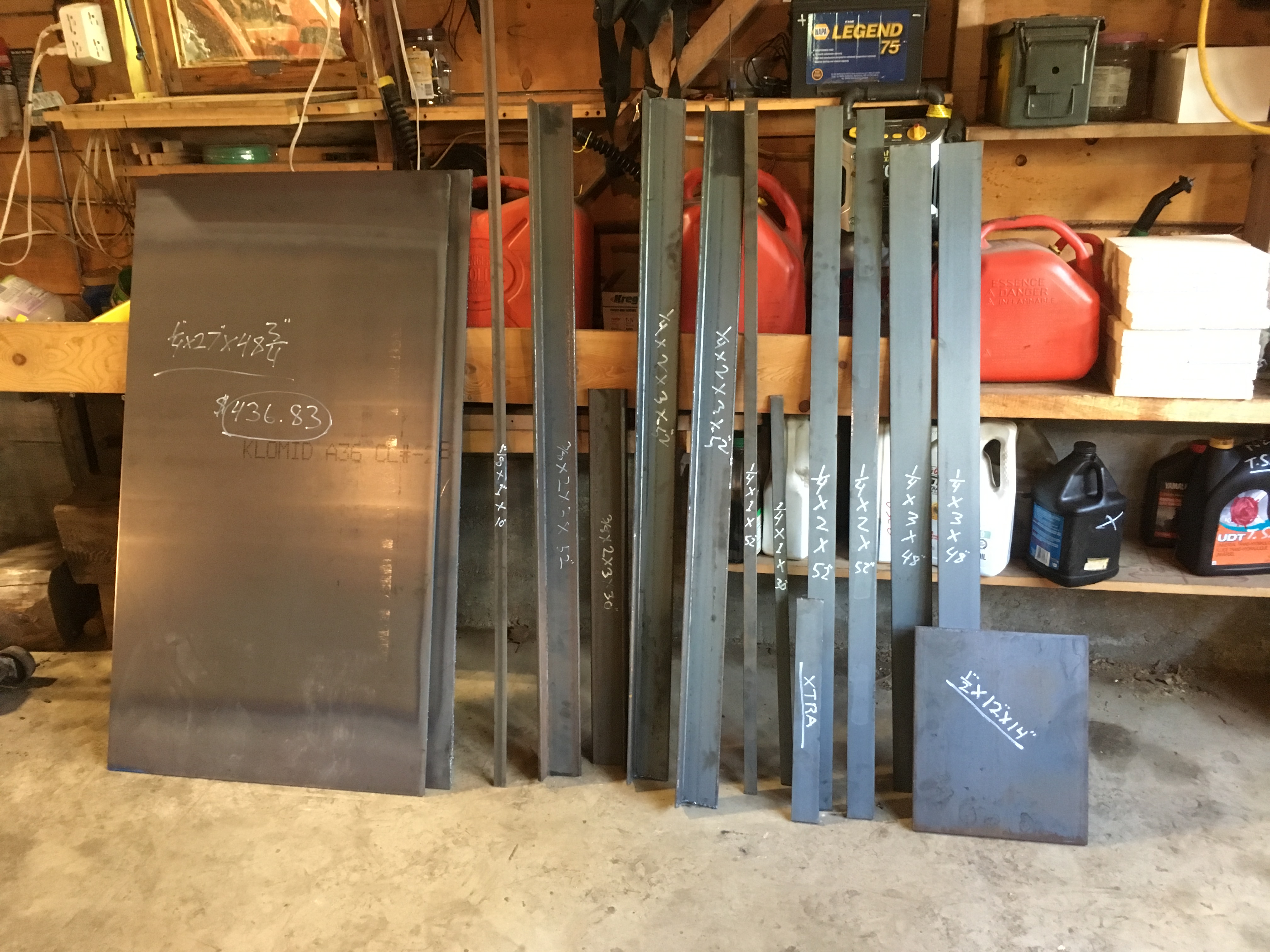

Pick the steel up today and all the brick bolts and gasket, after I get done crying over the cost I'll start putting the wood stove back together. The office girl said because of the US tariffs the steel is more costly now. I dont know if she was slamming Trump or the steel I got would've only cost $100.00 instead of $436.83. She couldn't or wouldn't tell me how much the cutting charge was, she said it's all figured in at the cost of steel, had to have it cut down so it wouldn't be any longer than 5' so's to fit in my SUV. She said lot of their steel comes in 20' lengths and some 10', a good place to take a trailer.

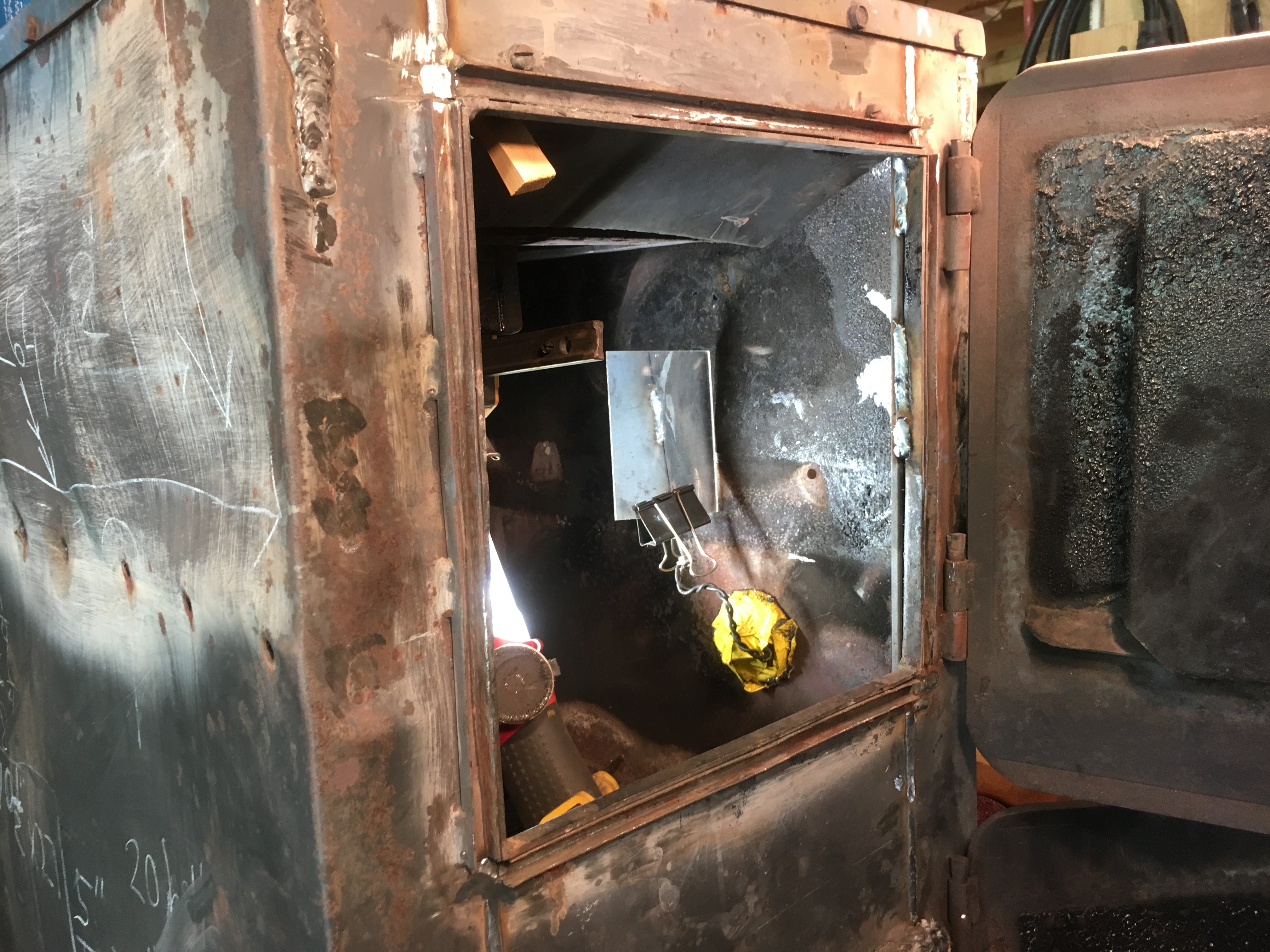

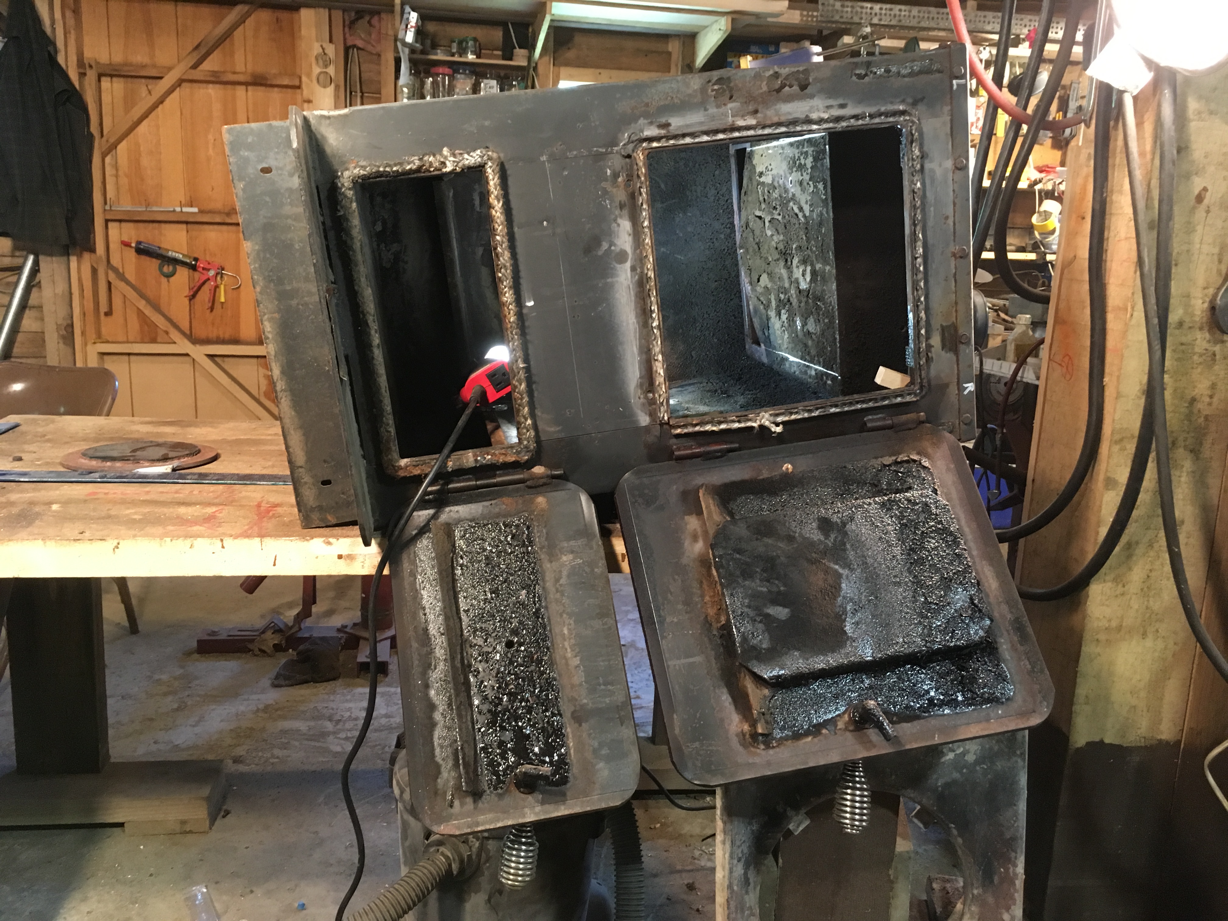

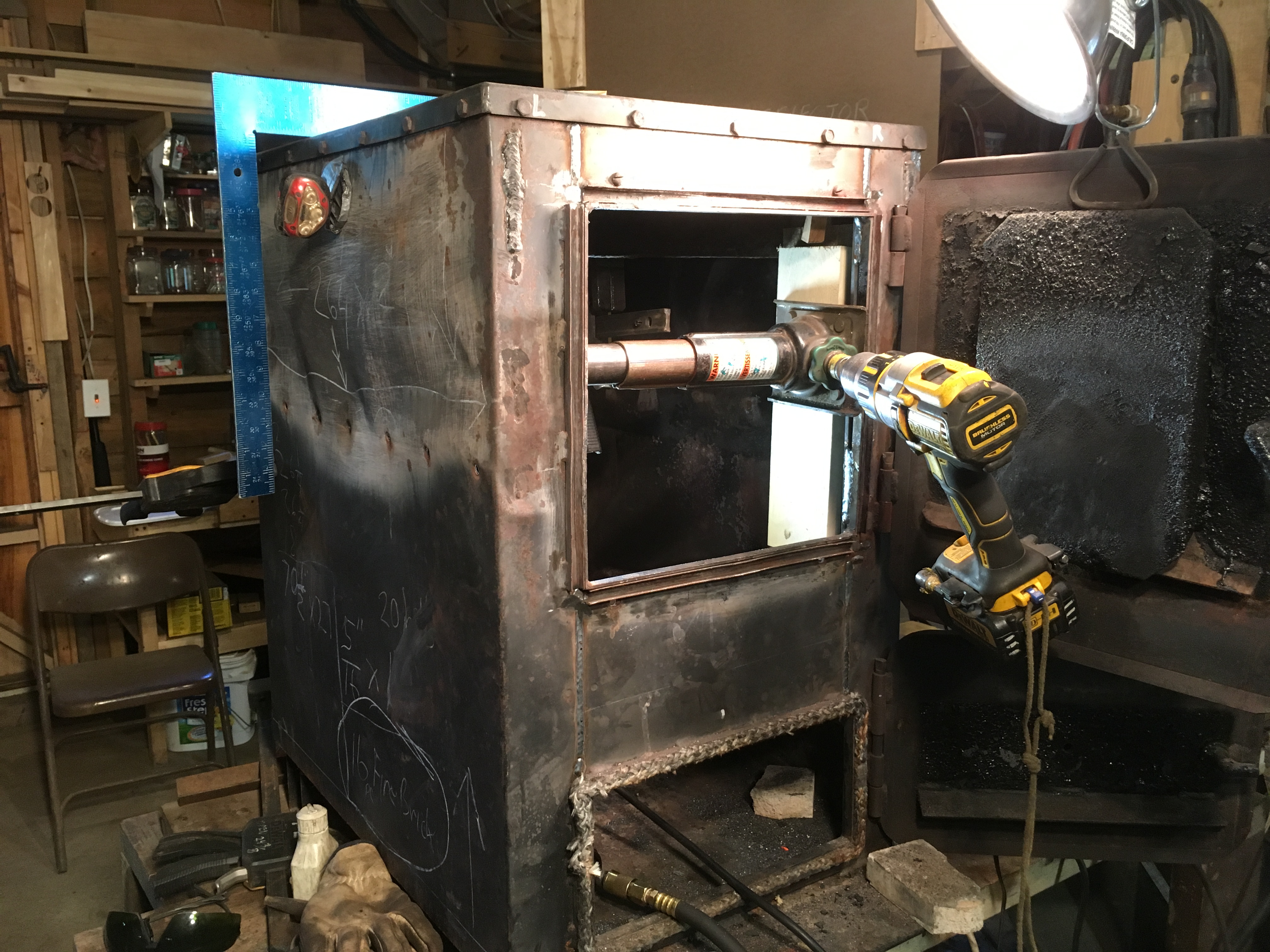

I think a alot of my steel cost was in cutting charges, setting up track to flame cut a 1/4x4x8 sheet in half then make it 27" wide cant be as cheap as a shear.
Made a start on the stove this afternoon with two 1/4x 3"x 21" strips on the inside front, that's so's there will be no interference from the door closing, the rest will go on the outside and will be easier. Nothing like welding with a mirror especially when the stove is so thin, I kept burning threw .030 wire but I got 3" long tack welds on it. First I straighten the sides a little with a screw jack, that part worked pretty good
