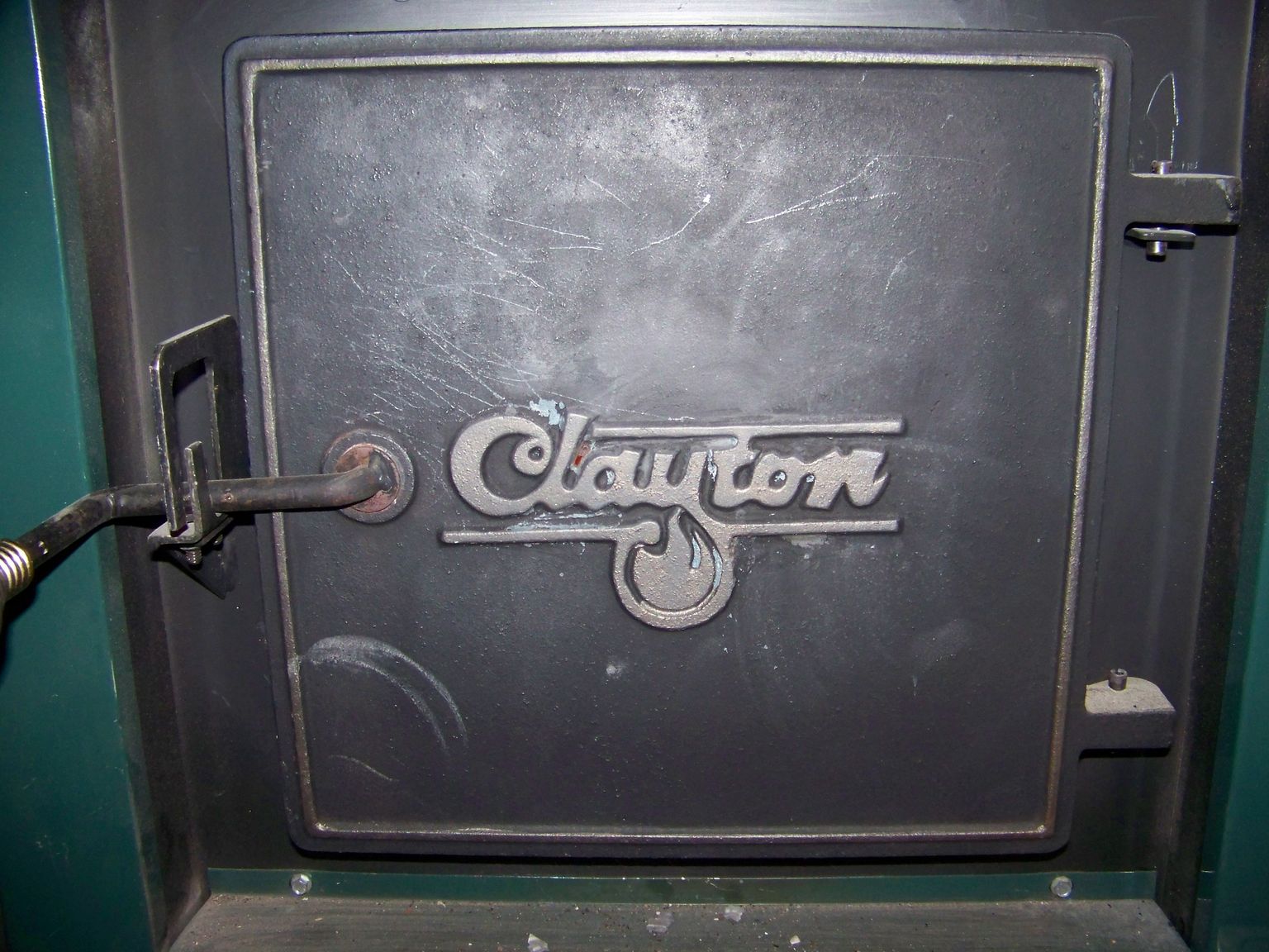

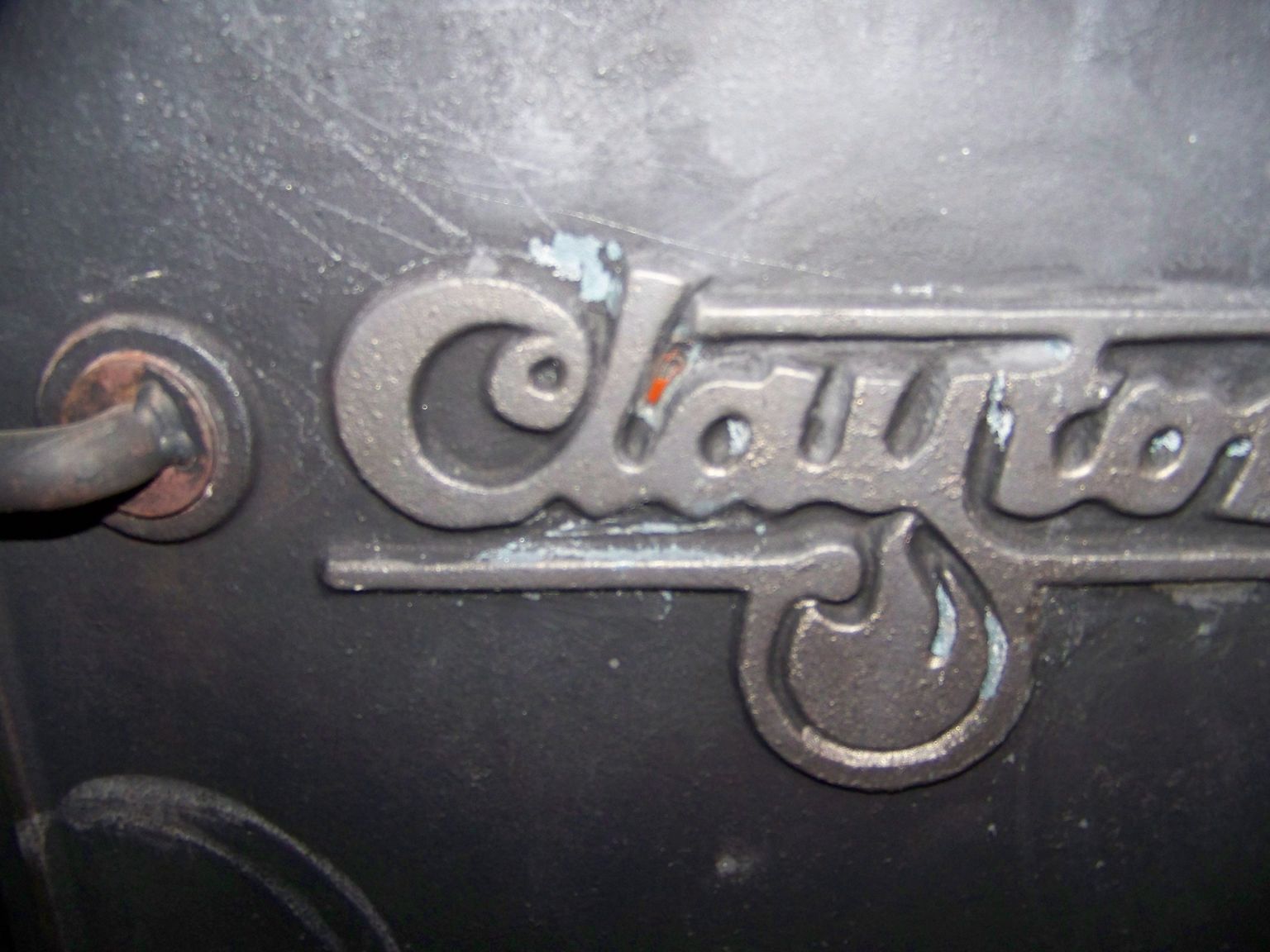

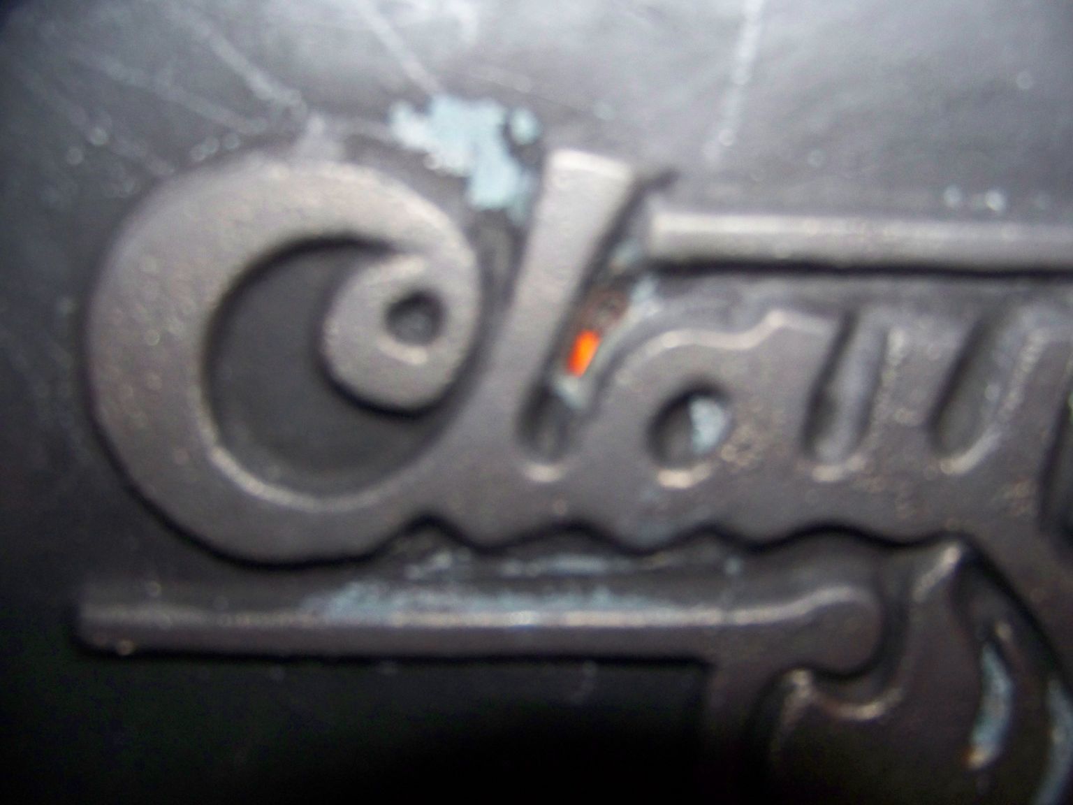

The main firebox door on my add-on wood furnace has developed a small hole. It is a cast iron door. Can it be fixed? I'm probably going to either have a new door fabbed or order a new one. Just wondering.
The hole is located between the L and the A as indicated by the pics.

Must have been a bad cast. I would just weld it up
   / Wood stove problem. #3
Most wood stove companies including my Hearthstone will have a lifetime warranty on cast iron parts unless it can be shown that the failure was due to overfiring. I would send the photo to the manufacturer (Clayton) as it appears to be an obvious casting defect.
Otherwise, braze in some filler or maybe even JB weld.

welding cast is tricky at best.
best bet is braze if you cant get the warneete thing to go through.
