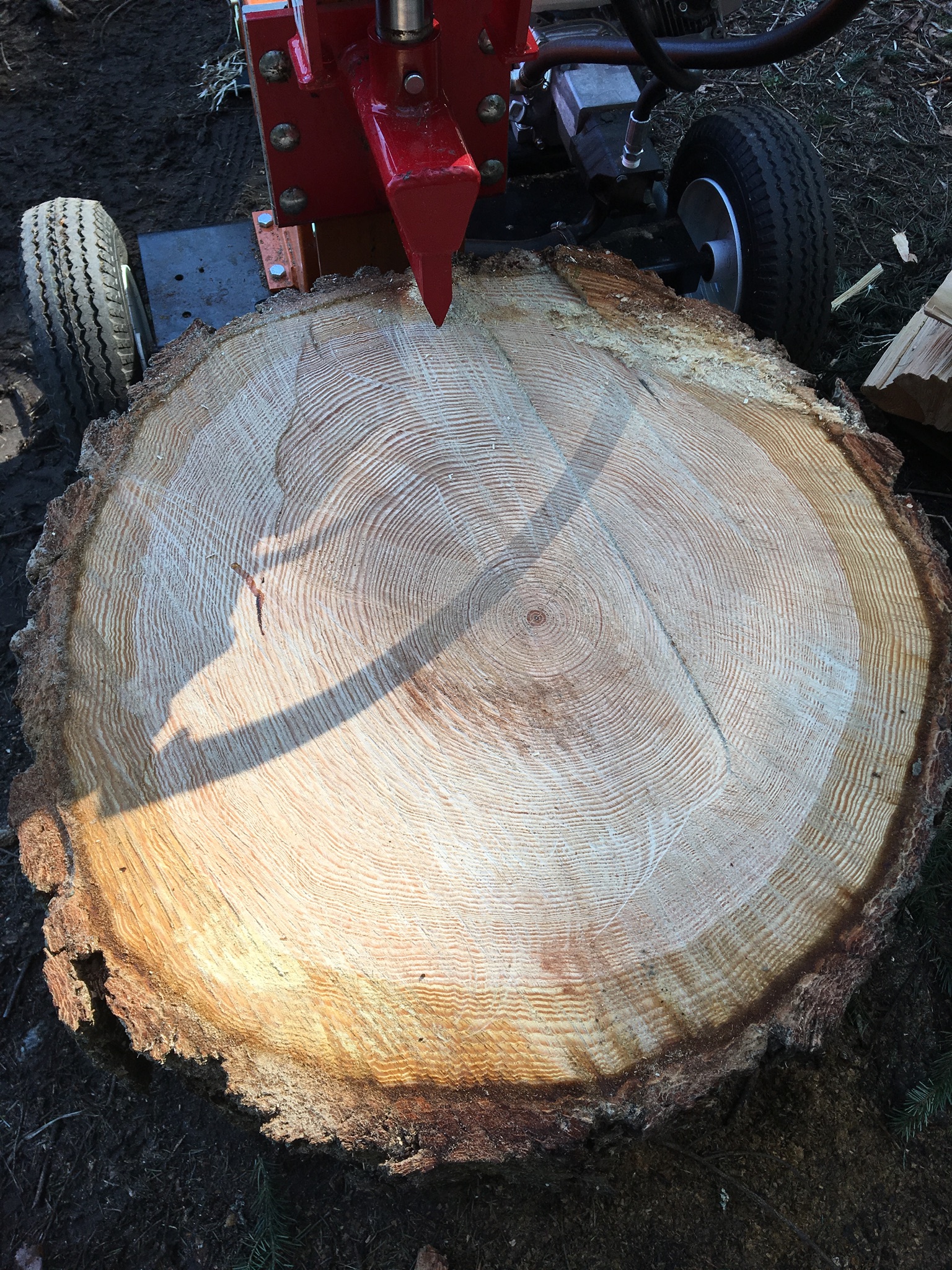

I find it difficult to split large rounds with the splitter vertical. The round doesn't slide well when it's on end and you have to get it up onto the splitter's "foot" (the end of the splitter that's on the ground when it's vertical) so the wedge can get a clean shot at it. Making a steel platform to go around the "foot" would help a lot. There's no way I could slide a 100+ lb round under there while seated on a stool. The leverage is all wrong.
I use the splitter in horizontal mode and cut up rounds that are too large for me to pick up. It wastes a bit of wood but I have so much of it.
You don’t need a log lift. All you need is a stool to sit on while you split vertically for the heavy ones.
Oh, poo. You mean this round of mine was hard to get into position? :D
   / wood splitter DHT 22 vs Champion 27 #20
The older I get , I think I actually have an easier time getting pieces like this in place. It Is the old saying- work smarter, not harder. I used to struggle to muscle them into that position. Now after years of getting old, I know it is about running it on its balance edge until it is just the right distance from the splitter, and letting it fall forward just right.
