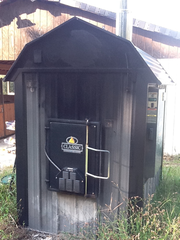

I heat my house with a central boiler outdoor wood furnace which we have named General Sherman.

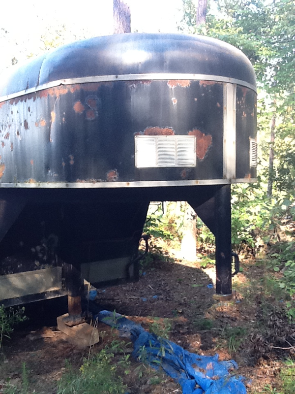

My idea is to build the processor on our gooseneck stock trailer, stripping it down to the deck.

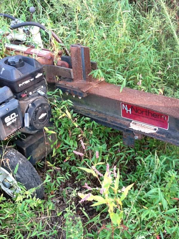

22ton northern tool log splitter 6hp b&s - horizontal or vertical -working

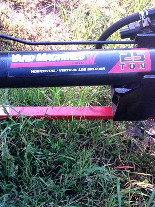

25 ton yard machine log splitter 6hp b&s -horizontal or vertical -working

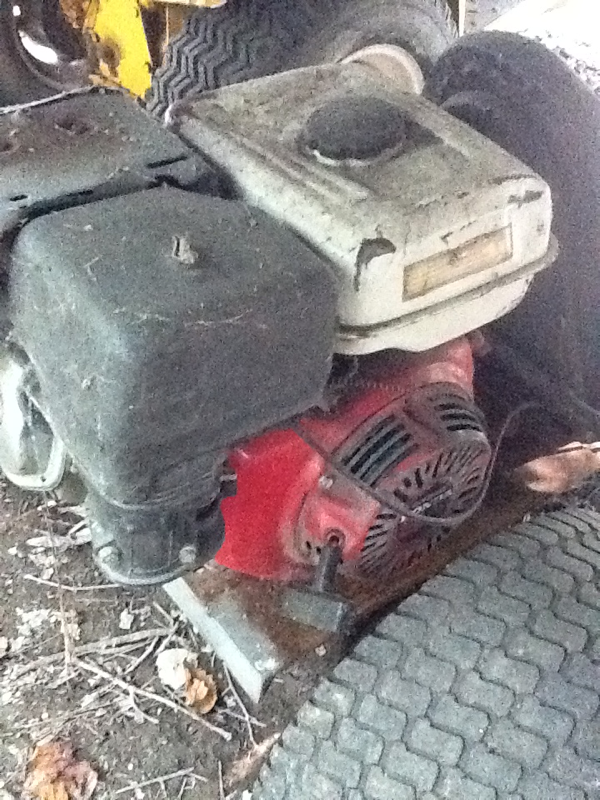

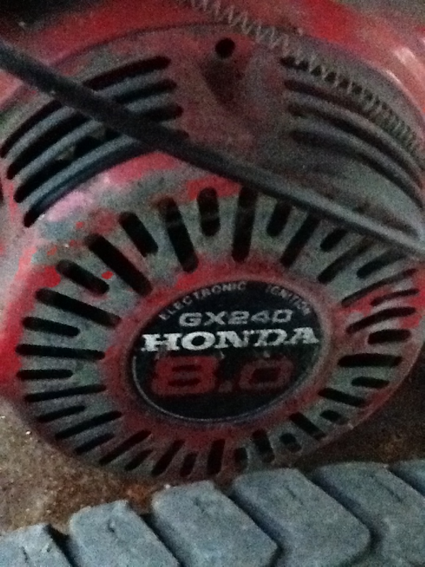

Honda 8hp 1" keyed bore

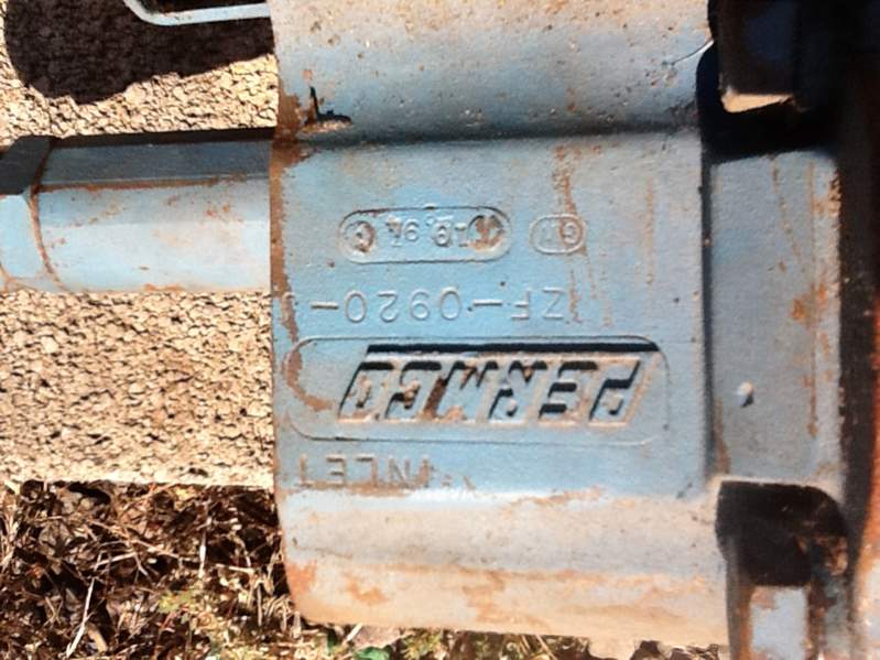

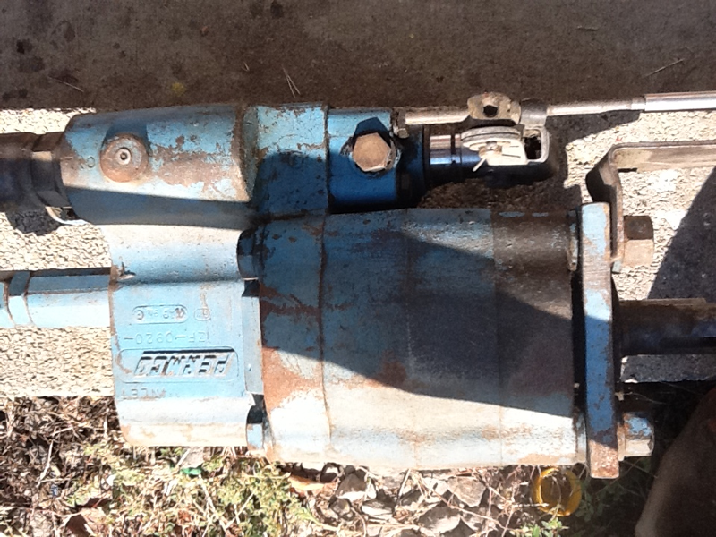

Permco 30gpm dump hydraulic pump

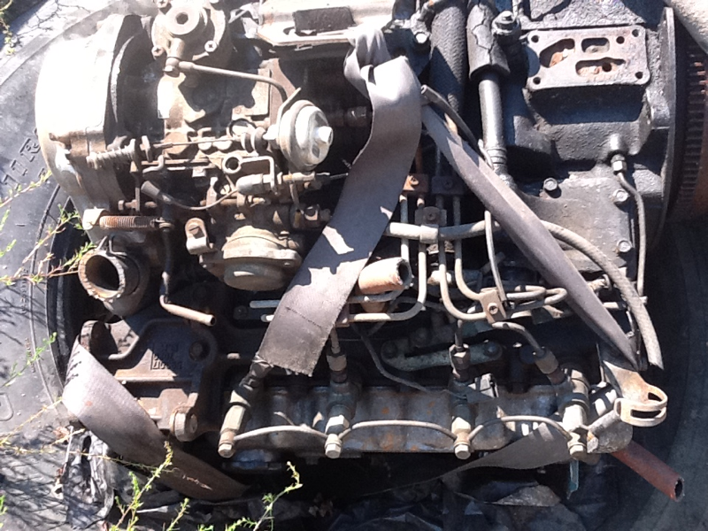

1982 3.2 4 cylinder diesel motor out of a chevy luv truck

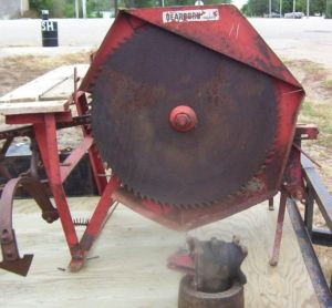

Dearborne buzz saw for a ford 9n tractor belt driven.

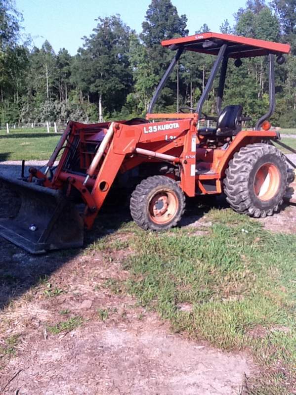

Kubota L35 tractor

If the buzz saw (cordwood saw??) is what you use to cut lengths, will it be always spinning? They have a lot of inertia so start/stop would put a big hydraulic load on the motor/pumps. So if it's always spinning you have to be very aware of the safety of something hitting or falling against the blade. Many commercial processors use chain saw parts driven hydraulicly, which stop/start for cuts, probably for that reason.

Yes I envisioned the saw blade running continuous.
The buzz saw has it's protection hood which we could modify to make safer if necessary. We could even make the hood spring loaded to cover the blade completely, then when lowered let the contact of the log allow the hood to rise as the blade cuts.

As for the OWB, We split for a couple of reasons,
1. It makes the logs lighter so my children can load furnace (or wife???)
2. Easier to load.
3. Found split wood burns hotter thereby the draft opens for less time to recover.

That Honda engine won't run a 30 gpm pump, so the luv diesel it is. Maybe geared up so it can run moderate rpm and quieter. Set the feed chain in a trough so the log doesn't rest on it but the dogs catch the log.
