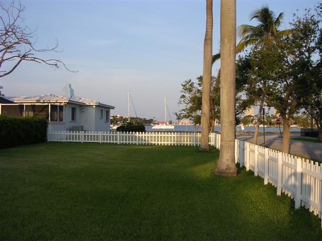

I built a PT picket fence around my front and rear yards about 12-13 years ago. I used Behr's solid stain (pinto white) after letting the fence age for over 6 months. It held up pretty well for about 7 years and then I had it resprayed at that time. Still holding up pretty well and that is with the heat and humidity we have here in S Fla. Looks like paint but doesn't have the gloss finish and it doesn't peel just kinds of starts to wear away. I pressure sprayed it before re-staining the second time.
