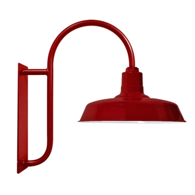

I want to add some lighting in a few spots around my property. Nothing too bright, just down lighting. 1 near a gate to the barn and 1 or 2 next to the driveway bridge over the creek. I want to use a 6x6 post rather than a telephone pole and can get them up to 16 feet long.
This is the light (I would get black, not red):
How high would you put the light? How likely is it that the 6x6 will twist over time? Any other advice?

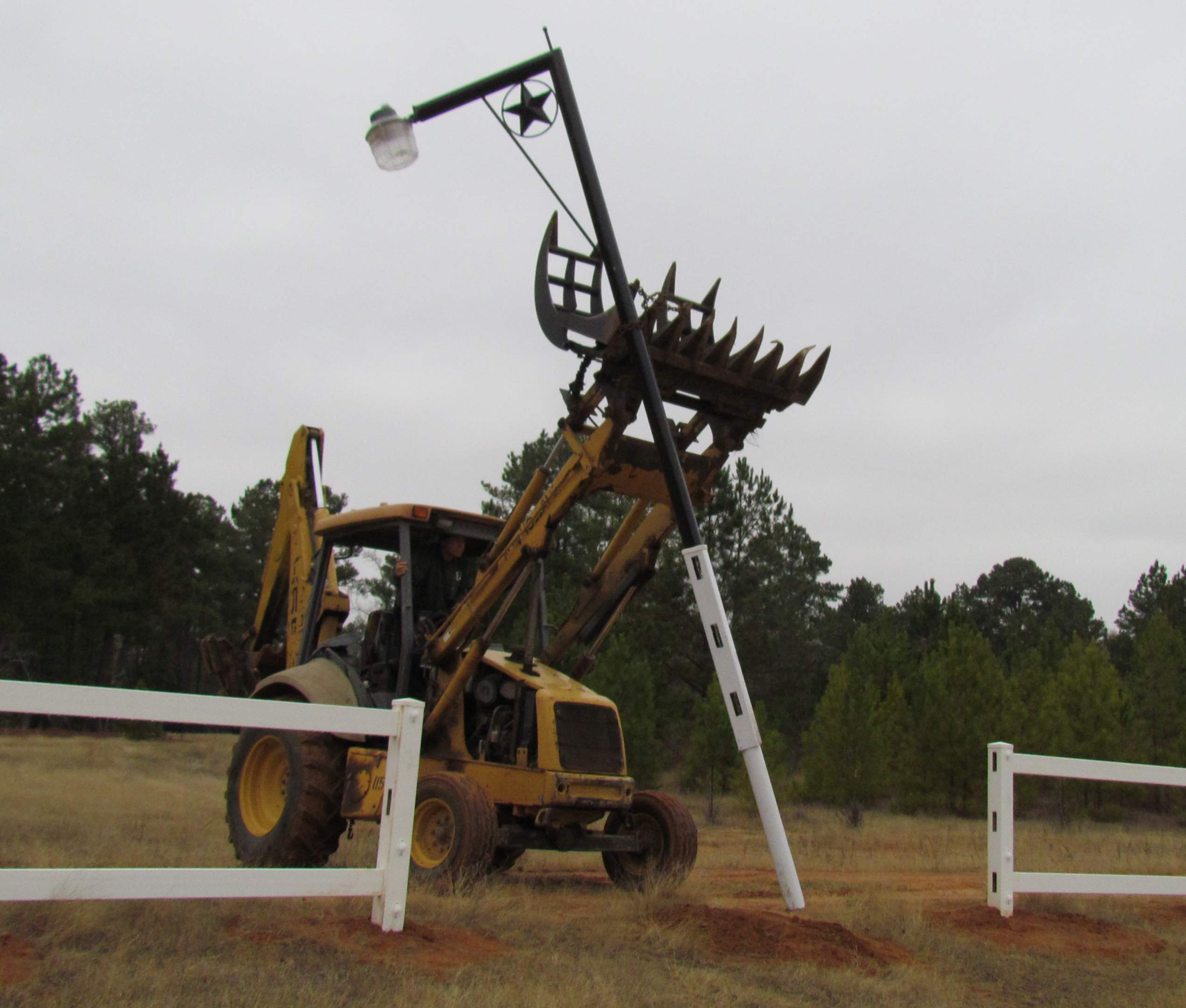

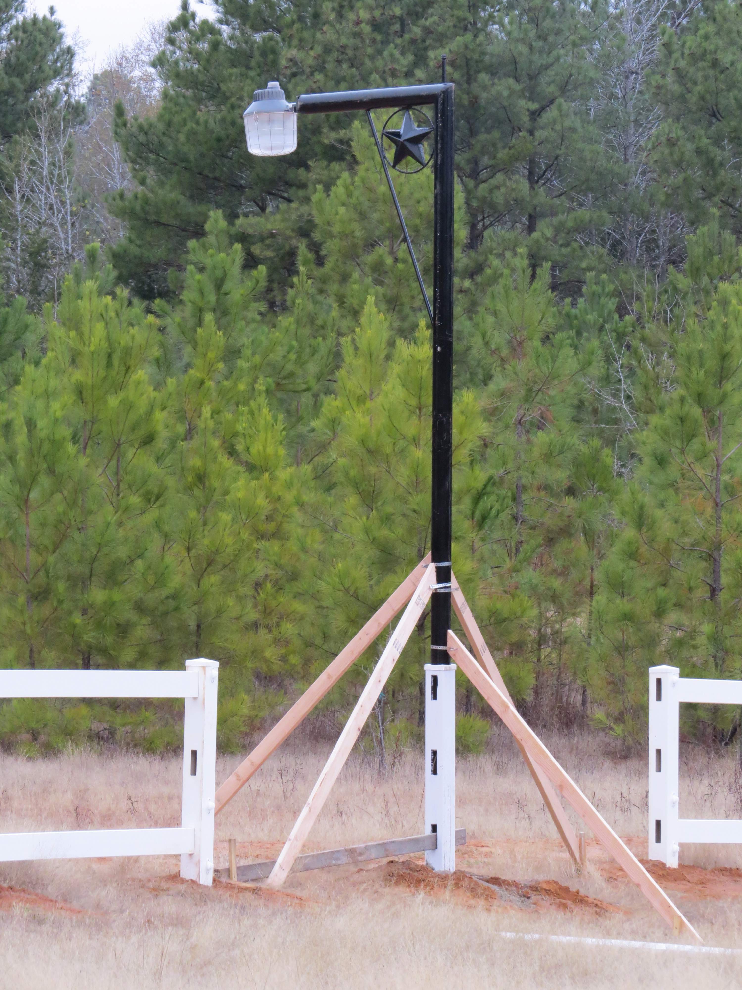

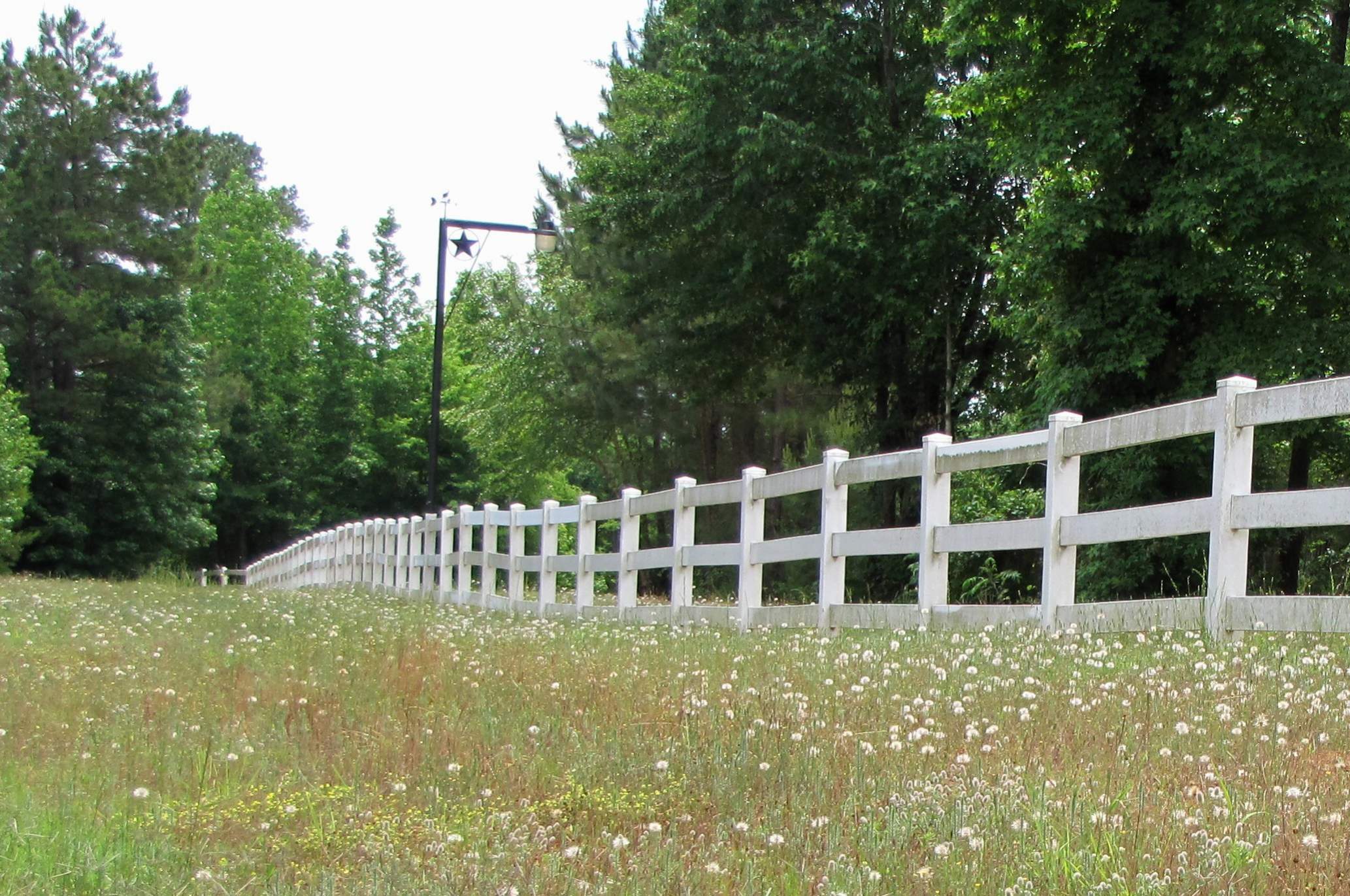

Here is what I built for my driveway
